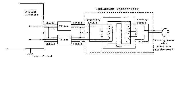

pooge said:
The purpose of an isolation transformer is NOT for ground isolation, and grounding the secondary does not inhibite the common mode filtering of the transformer. And you CANNOT connect it at a separate earth point unless that separate earth point is bonded to the ground at the service panel in the US without violating safety codes. In the US, the neutral is connected to the earth wire at the service panel also.
There are a number of reasons to use 1:1 transformer most are not for power distribution ie voltage conversion in a fixed construction. The main purpose (besides floating an AC DUT in a lab environment ) is for noise reduction and having the ability to get off a noisy ground. This requirement was the driver for a whole market of "extreme" isolation transformers. To get the best common mode reduction is having the ability to break up ground loops in a specific system. When you ground a secondary to earth you have eliminated the common mode by definition. But the common mode noise does not disappear by majick, it gets converted to transverse noise which is even more difficult to filter. The place to put the earth ground is after the last transformer in a system and that is usually not at the secondary of an extreme isolation transformer. This is a system level approach to a noise reduction problem. An electrician is not the go-to guy (expert) when you want solve these type of questions. This has been done before (TEMPEST and other qualified RF screen rooms) and is not breaking the law or a shock hazard when done properly.
IEEE 1100-8.2.1 (Emerald Book: Recommended Practice for Powering and Grounding Sensitive Electronic Equipment)
Another function of the separate windings is to provide for establishing the power ground reference close to the point of use. This greatly reduces the problem of common mode noise induced through “ground loops” or multiple current paths in the ground circuit upstream of the established reference ground point….An electrostatic shield is a conducting sheet of nonmagnetic material (copper or aluminum) connected to ground that reduces the effect of interwinding capacitive coupling between primary and secondary windings and improves the isolation transformer’s ability to isolate its load from the common mode noise present on the input power source.

infinia said:All I know that without a fixed installation (perhaps called a movable appliance?), many of the codes you site are invalid.
Tell you what. I've presented multiple code references. Those codes govern the entire electrical system, stopping at cord and plug connected equipment that is listed or approved for use (see post 35). Those codes are not my opinions, they are fact. They have stated, without exception, that 120V residential receptacles cannot float, but must be solidly grounded. You have presented your opinions about what is permitted, but have absolutely no proof.
Your challenge is to come up with ONE single code reference that permits you to float a power strip in a residential environment. That is what this thread has been debating from the start. Don't stray off into tangents about what works best, common mode noise, etc. You present illegal suggestions, and have not provided any citation that says otherwise. Sorry, a drawing without citing the source doesn't cut it.

zigzagflux said:
Once you are inside a single cord and plug connected piece of equipment, fine.
That's what we are all talking about here from post one. But you to seem the view the world only from an electrical contractors or worse a building inspectors point of view. Instead of helping, your rather myopic posts IMO just keep on hindering and confusing the issue (ie GFCI). Read my first post in this thread.
Rather than dismissimg the diagram I posted (Did you even look at it) can't you comment on it's merits for clean power?
Then read post #3. I think we can only assume a power strip with outlets here. If you have outlets, you'd better have a grounded earth, and a neutral bonded to earth in those sockets. Simple as that.
These are considered "appliances" like UPS and other power devices that are simply covered by UL CSA if/and only if you are going for listing or certification, as you should if you are going to sell them.
infinia said:
No
Tell that to your insurance company.
