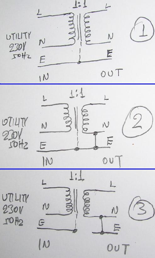

Hi all
I would like your advise on the proper way to wire the secondary of an isolation transformer, so as not to violate the electrical safety of the equipment to be connected to it ( audio gear) and to retain - as much as possible - the isolation from the noise which is superimposed on mains wiring.
I spent a few hours reading books and some more hours on the internet, but the opinions are really conflicting.
Attached is a sketching of 3 different connections.
Please commend
Best Regards
George
Why are 2 and 3 not equivalent ? They are both labelled E, yes? Or are you saying the output end of E is not bonded to the panel earthing conductor? It must be, no exceptions.
With very rare exceptions, 2 is the only legal method (in the USA) if you are feeding multiple equipments with this power supply. If it is only being used inside a single enclosure, then 1 can work. However, it is typically a good idea to earth the equipment at some point, even if through a resistor. A completely floating supply has its own set of problems.

I intend to use such an isolation transformer (IT) to feed the pre-amp, main amp, tuner and CD drive .
Richie00boy
In fact the wiring per sketch No 1 is the way that any step-up or step-down transformer is wired in any linear PSU
I have an isolation transformer (IT) in my lab, which is wired as in the No 1 sketch. I use it during repairing equipment for reducing the likelihood of becoming a spirit. So far so good.

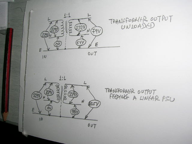

But today morning during some mains noise monitoring, I thought of measuring the noise at the output of this IT.
Then to my surprise, I noticed that the voltages of the thus wired secondary were behaving quite strangely (strangely to me).
See attached photo.
Is it normal? Is it safe?
When the secondary is wired as per No 2 and No 3 sketches, voltages are as on the primary. No surprise.

I would bet the wiring of the output of your IT is currently correct. Did you notice your measurements on the secondary don't add up to your 229Vac?
Think how the circuit works as in electron flow. The measurements from Live or Nuetral to Earth are capacitatively(?) coupled...I think that your DVOM puts such a light load on the circuit...that you can get any reading. I would bet if you loaded the circuit just a little you won't read any voltage at all. Wouldn't be baffling if you had a cheap meter & you tested both 'L' & 'N' ...and it gave you no readable voltage?
You should be able to pull down that reading with microamps & the voltage would drop.to nothing.
As has been said over & over, rectifying AC from the wall is dangerous because the live side to earth AND/OR Nuetral is hot.
Thats my take on it....I'm probably wrong in my assumptions, but....

The strange readings you get are as Richard Ellis alluded. The uA leakage currents flowing through your voltmeter are causing an AC voltage to be read. It's an artifact because the secondary if floating.
The requirement to tie neutral to earth is only at the power panel. Never do this anywhere else.
The key reason to use an isolation transformer is to protect yourself from live chassis. If you are holding a grounded (earthed) pipe for instance and touch a live chassis, the isolation transformer will prevent electric shock. You'll still get a tingle from the leakage current but it won;t stop you heart.

Given these requirements, the best solution would be option 2. Option 1 is illegal and IMO a case can be made is dangerous. Option 3 has not provided enough information for me to answer, but I would suspect is somewhere between bad and dangerous (the E's have to be tied together).
SO #1 would be correct. The mains power transfers through the transformer windings. You then are free to connect the earth ground to the chassis of the equipment.
#1 is wrong. You connect the earth ground to the chassis regardless if there is a iso xfmr or not. We are not dealing with a "hot chassis" issue, we are dealing with a user installing a permanent or temporary separately derived system feeding multiple pieces of equipment. One of the secondary leads must be grounded.
Again, I state these requirements on the basis of the US Electrical Code, but would be quite surprised if other countries are significantly different. Safety is safety, in general, and safe electrical systems are grounded. There could be some nuances with the use of 230V single phase, where the US uses 115V, but the principle does not change.

george .... as posted in the op ....your only option will be to go with drawing number one and only that ......
as about readings ...if everything is correct , connections wiring and so on , ratio of the trafo is really 1:1 then you are going to have ......
output of the trafo between "phase " and "netural "=230V
outpout of the trafo between "netural" and ground= absolutelly zero!!!!! ( IF NOT THEN YOUR UTILITY GROUND IS NOT CORRECT )
finally and most importand output of the transformer between "phase" and ground also 230 v....( if not YOUR GROUND IS NOT CORRECT )

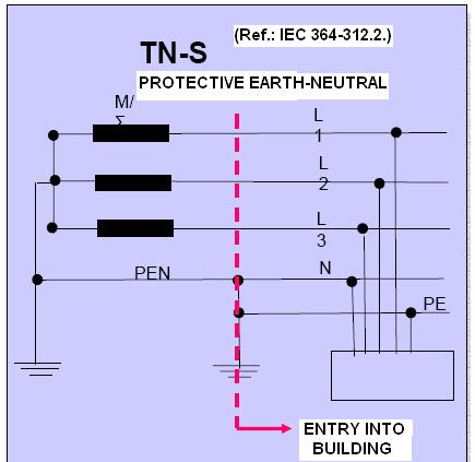

First I had to look for an applicable code.
In Greece (since 2004) - as in the rest of continental Europe- the IEC 364 is adopted as the Electrical Installation Code.
(P.S. The text of the code was in Greek, so I deliberately translated it. If someone has the IEC 364 in English, please verify)

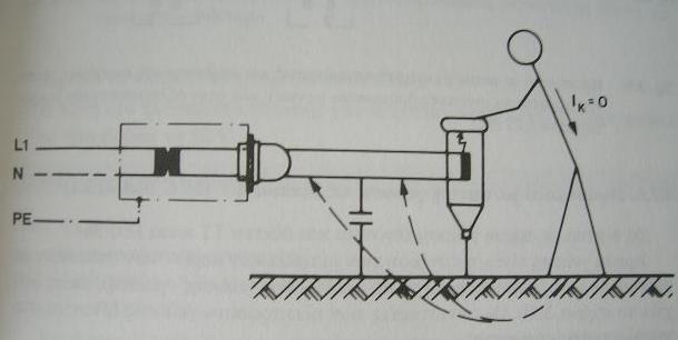

IEC 364-413.5 refers to the utilization of Galvanic Isolation.
IEC 364-413.5.1.1 : Isolation Transformers shall be per EN60742 ( 4KV isolation btn. primary & secondary for single phase transf.).
IEC 364-413.5.1.3 : Any of the energized parts of the isolated circuit shall not be connected to earth.
IEC 364-413.5.3.1 : Exposed conductive parts of the isolated circuit shall be electrically bonded but not earthed.
The rationale behind using an IT so connected, -as I understand it- is to brake the loop for any fault current.
There can not be an electrical continuity between any one of the bare ends of the secondary and the earth, because none is referenced to earth.
There is only capacitive coupling (thus there is restriction to the length of the lines:454m for 230Vac).
Man has to touch both bare ends of the secondary for to close such a loop(thus there is a requirement for 0.4 sec reacting fuses on the secondary).
The code restricts such a galvanically isolated installation to very specific locations and uses (and educated users).
The reason is, that control and supervision has to be exercised in order to ensure that such isolation ( see paragr. 413.5.1.3 and 413.5.3.1) will be maintained.
And just because this becomes more difficult to be attained if the isolated circuit becomes more expanded, such kind of installation is reserved for special premises and a recommendation is made for only a single component after the IT in case of severe difficulty to maintain control and supervision.
So, as I see it now (better late than never), this kind of installation with such (single secondary coil) an IT:

b) All chassis (e.g. HOT radio, RF signal generator, oscilloscope) shall be connected with an electrical bonding strip to each other but not to earth.
Well, things are getting tough, don’t they?
Regards
George
