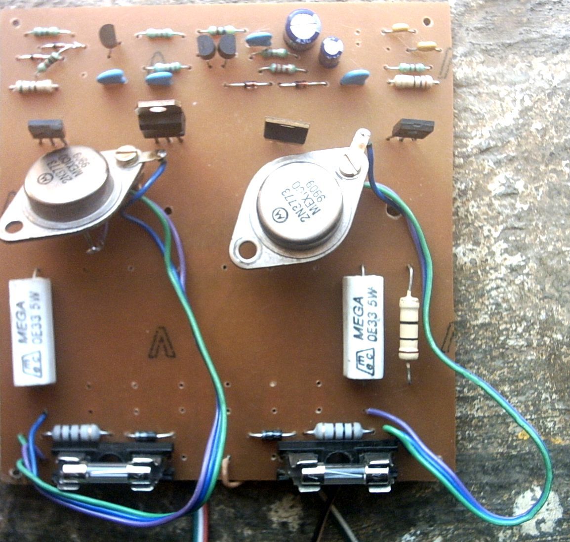

I am trying to post a picture of my b500 amp.may be sucessfull at this time.http://http://www.flickr.com/photos/57293718@N03/?saved=1
hi sudhir
here is the image of your b500
regards
ravs
2n 3773 must b on heat shink....
it is in testing period:,only with +/-12 volts.after some time i will complete it.
anybody will please comment on my 2n3773 ,is it original ? i got it from junk.After cutting one i have seen the silicon chip,it is big in size.
Your 2N3773 is original. Test amplifier with +/-12V rail voltage is wrong. Use 10R instead fuses or serial bulb 100W/220V in transformer primary for test, and use proper rail voltage.

you should not be using 140Vce0 devices on ~+-70Vdchow many pairs of 2n3773 are safest with the ps of +/-70 volts and load of 8 ohms ?
The normal mains voltage variations and the abnormal mains voltage variations will take the ~+-70Vdc to as far as +-60Vdc upto +-80Vdc.
The 3773 are not specified for use at 160Vce.
It is +/-70 volts without any load & in many posts in this thread it is suggested that you can use these with this supply.I am ready to increase the no. of o/p pairs but wants clear suggestion about this.
..................abnormal mains voltage variations will take the ~+-70Vdc to as far as ...........+-80Vdc.
AndrewT is correct, ±70V could be marginal in some countries and with some brands of 2N3773.
'In some countries' refers to how well the nominal mains voltage is regulated.
The spec sheet for the part specifies 140V total swing for forward biased operation. With proper test equipment they could be selected for higher breakdown voltages. I got lucky with a set that went into an amplifier running at ±85V, but these came from engineering stock at a major aerospace contractor.
The Altec 1270 used ±75V rails, and the parts list says selected 2N3773.
Back when I was designing consumer electronics for the world market I always allowed for the mains being 10% high, but I was told that for certain market areas that I had to allow for a 20% high mains voltage.
If you want to be absolutely sure, this would imply two pair on ±57V.
