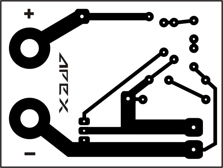

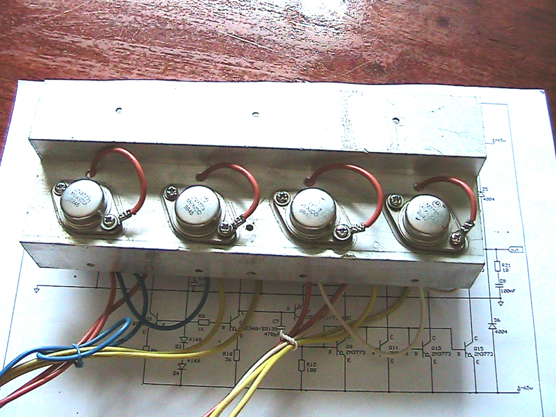

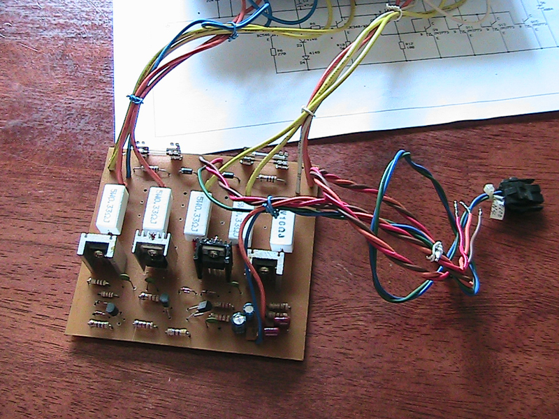

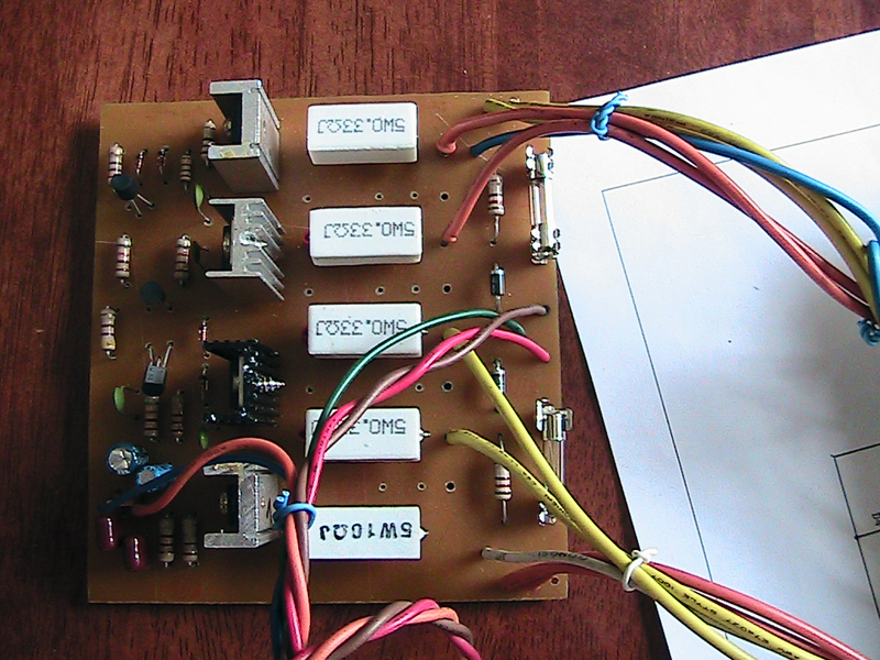

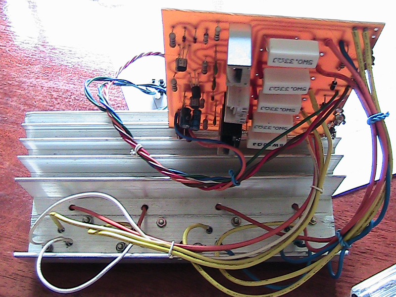

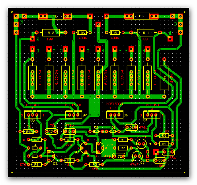

God gracious Apex, this is a great success. I made it and it works fine. Thanks you very much for the schematics and the PCB layout. Even tough I modified it a bit but it still retain the same artwork as yours. Thanks again. Below are the images:
I am using ExpressPCB for the PCB layout and the schematic. You can download it for free from this website: ExpressPCB - Free PCB layout and schematic software

Nice work, 2N3773 on pictures are fake motorola!
Regards
The verdict
"Who care about fake! "

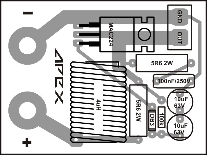

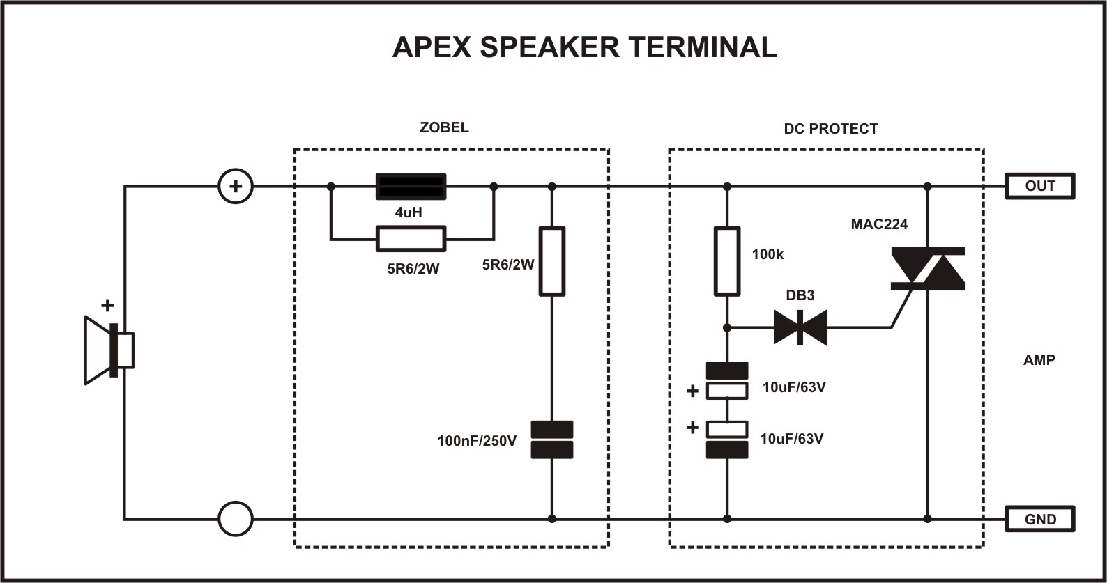

Fake parts are seldom as robust as original parts, I suggest you add a DC protect circuit.
It is hard to find original parts in this regions. If you do, it will cost you lot (may be around RM120.00/US38.00). It's alright to use fake one at this initial stage. After all it is an experimental project. When I found that this project work then I'll go for the originall one. Even tough you said it was fake, but it was from Mexico. You suggest to add DC protection circuit, can you show me how or just simply post the schematic.
Thanks, best regard.
