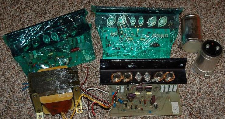

I've some Quatre boards for sale
If anyone is interested...
I've got some old circuit boards, complete with output devices,
which I removed from a pair of DG250/C I bought on eBay(with the intention of recycling the chassis for some Leach amps I'm currently building). I also have one power transformer available.
I was thinking of listing them in the DIY Marketplace,but if anyone here is interested in one or all , please email me with any reasonable offer.
-Chas
Pics of items
OK
Here is a pic of all the Quatre parts I've got available to sell:
If interested in one or all, email me with a reasonable offer.
Thanks,
-Chas

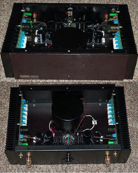

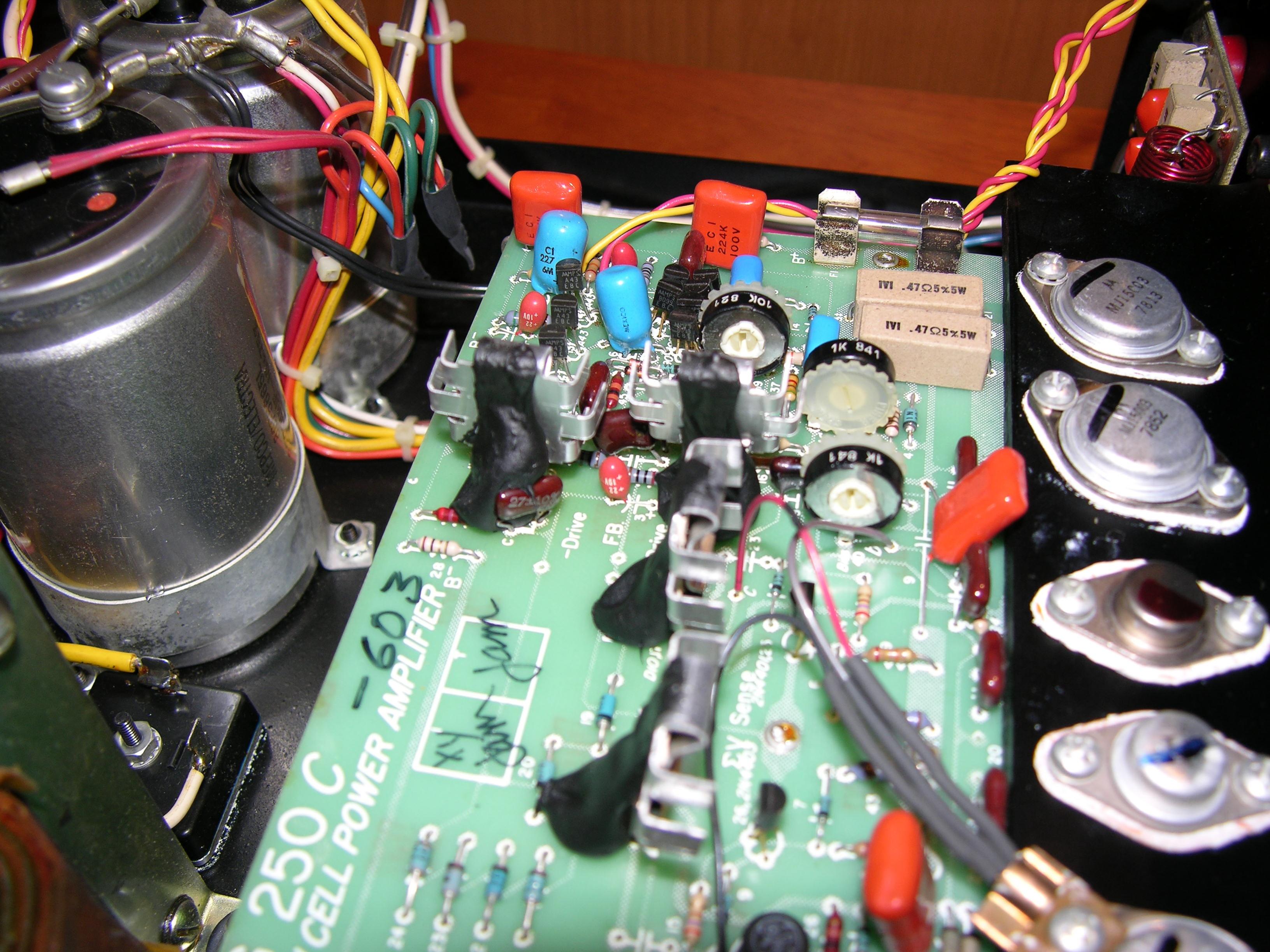

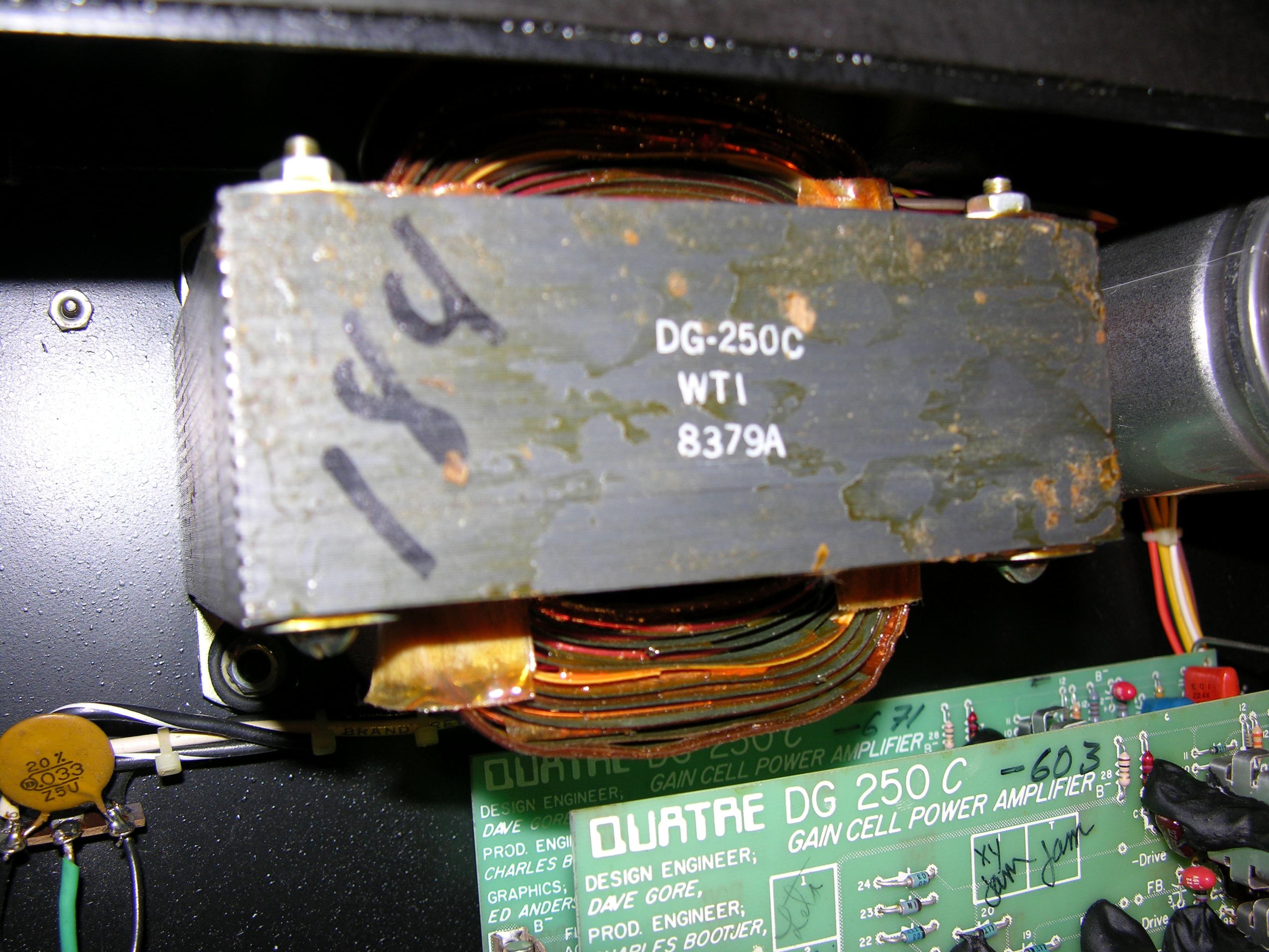

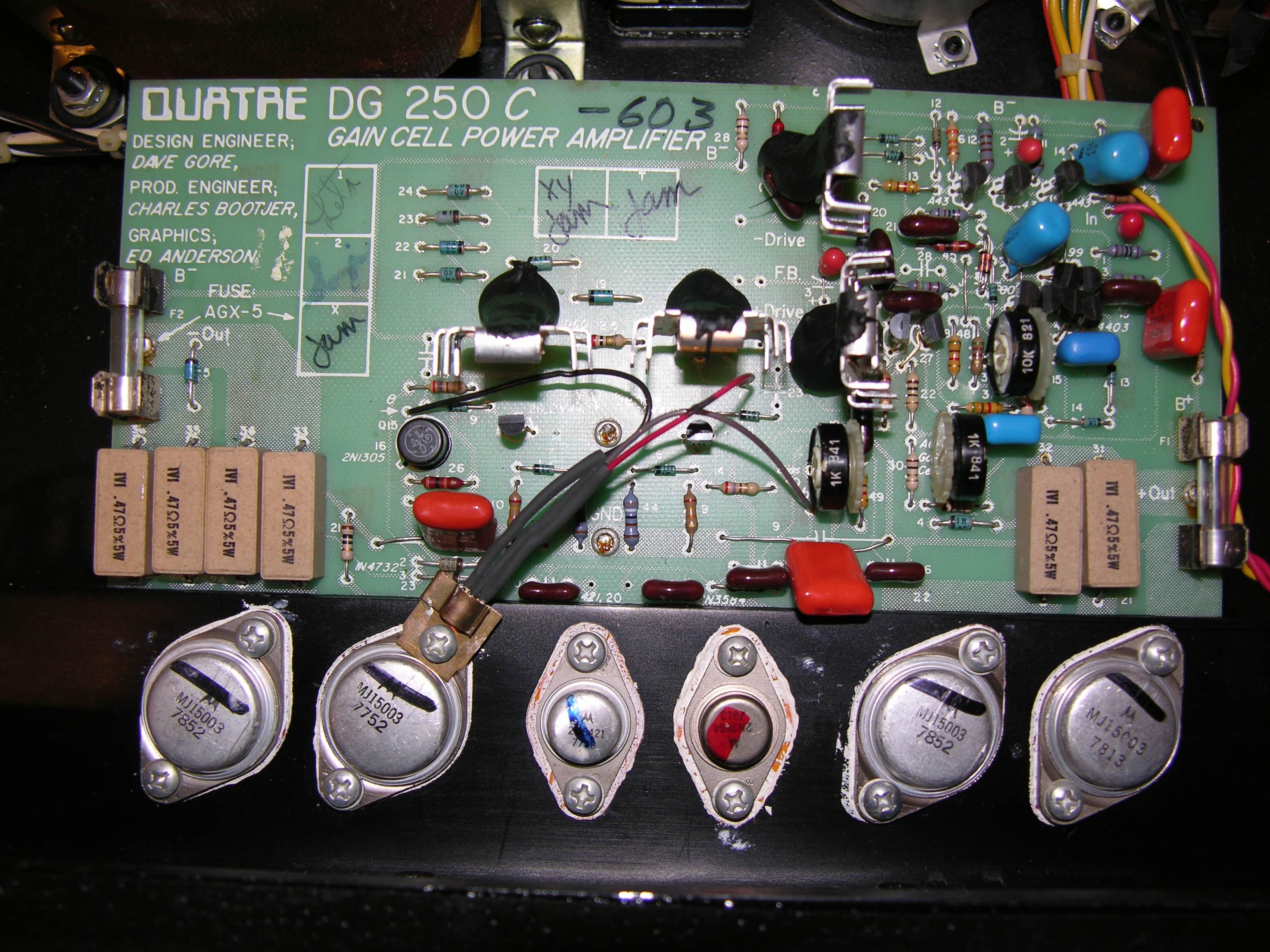

Quatre porn
Hi everyone,
Complete rookie here; this is my first post. Sorry to hijack a thread, but it's been a few months without comment, and this seemed to be a good initial conversation.
My uncle loves to give me his old audio equipment, and his latest gift to me is a Quatre Gain Cell DG 250C.
Years ago, he gave me a set of DQ 10s with stands, sub, both active and passive crossovers. Little did I know that he was stoking me with the ultimate 70's set up! Anyway, my wife eventually forced me to sell the Dahlquists, but I sure miss the way those things could fill a room with sound.
Anyway, I though I would post a pic or two of the Quatre guts and ask a question. There seems to be some black goop smooshed onto the circuit board (are those transistors?). I know zero about electronics, so I am curious as to what it could be.
The amp powers on without noise, but I have yet to hook it up to anything. I am a bit afraid, given all the "my system got fried" stories. When my uncle last used it, it worked just fine.
He also says he has another one that he has yet to uncover (they just moved), so I may actually have two of these. My plan is to sell them, but I want to get an idea of their condition. If I take them to my local audio guy, he'll take a month to check them out, and probably stick me with a bill half the value of the amps!!
Any and all advice and comments are welcome.
