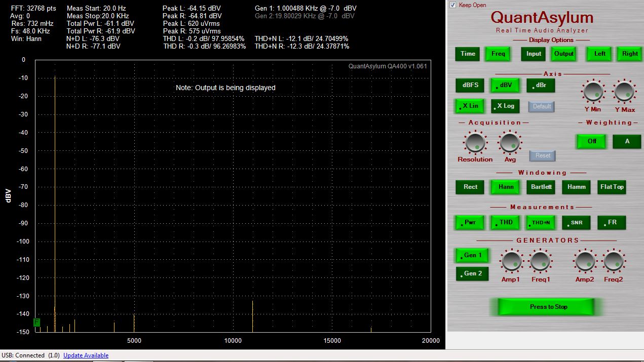

Hello! I bought one of the QA400's last winter. Finally getting around to playing with it. Someone here posted a diagram to build a very simple attenuator so I could hook up the output of tube amps to the unit. I just recapped and restored a Dynaco ST70. I am attaching a screen shot of the output. Does this look right? I am wondering if I need to tweek the settings on the software? I have to admit this is a big learning curve for me. Just trying to take some simple distortion measurements of old audio gear I restore. Any direction greatly appreciated! Robert
