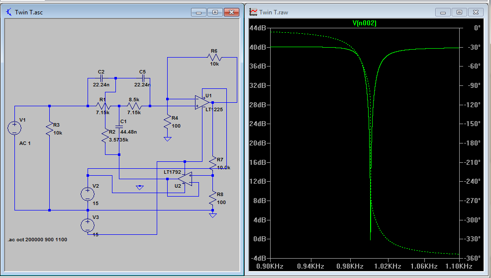

The difference is a loss of 13 dB with the 1K resistor. The input Z of the QA400 is 10K. The 1M and 1K resistors can both go. They are not adding anything.
It suggests a source impedance of 10K in effect. Its probably different with frequency. The load on the notch should be at least 10X the internal impedance or 100K. With the 10K input of the QA400 you will affect the performance of the notch. It really needs a low noise hi-Z buffer.

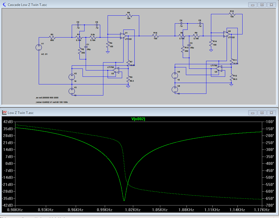

Attached is an LT spice sim of a notch with 40 dB of gain based on some work by JensH. It should give an idea of what is possible.
has anyone taken two buffered TT in series and looked at the notch profile?
-RM
If the Q was lowered on the second one then only the first would have to fine tuned.
-RM
That is essentially what the Shibasoku is. Here is a two stage buffered twin T. The fundamental is notched -40 dB in each stage and boosted 40 dB by the buffer. The composite is 80 dB of notch and 80 dB of boost of the harmonics. Minor challenge- getting precise enough parts to do this in the real world.
The shabasoku uses at least 3 TT. Anyway, using two cascaded to get -80 may have benefits.... less distortion, noise, parts tolerance and drift?
-RM

Try this. Get a good Jfet op amp, set it up as a buffer and run it off 4 - 9V batteries.
Dick's TT uses the opa134 and it work fine. There other that will work but more expensive.
OPA827 is one.
What value of resistor and caps are you using?
