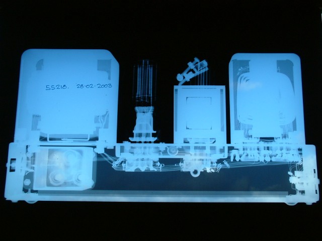

Croft's modifications were in the power supply; there are silicon diodes and a 6080 pass valve controlled by a pair of ecc83s which are crammed underneath.

How on earth did he manage that without roasting everything inside that rather submarine-like cramped quarters? And to what purpose??
I presume it was a misguided desire to have a regulated power supply - something which would have made no audible difference to a class-A amplifier. Sorry, but a lot more could have been achieved with a quite high power supply filter output capacitance at a fraction of the cost.
