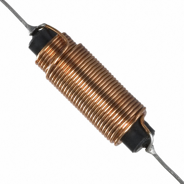

I did not follow this thread from beginning, but I think that could be good idea to read about current dumping amps, the quality and exactness of the inductor is very important here, it is not used to protect from a capacitive load.
Sorry if I intrude in this thread with the things already clear to all participants.
Damir
I would strongly recommend to stay with air core. The cored ones might saturate at high levels which will be far worse than few % off exact value. Just be sure you will use wire thick enough. Some 1.2mm will probably do the job here. There was some discussion here already. KatieandDad is the guy to ask about it. He made some really nice ones.
And yes, Dadod is absolutely right, coils are important here. But again few % off probably won't cause disaster. Certainly not big difference in sound.

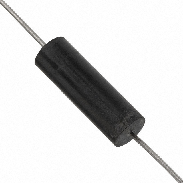

Agreed. There are many types of ferrite, most types used now are for blocking EMI or for SMPS duty and there can be serious problems with audio frequencies. The problem being that the inductor service duty isn't specified and often datasheets don't specify adequately either.

I have been looking at images of what I believe are genuine Quad boards, and they don't appear to use air core units.

Yes I know. Original coils are cored ones..but as Ian pointed out just to know that isn't enough. There are many different ferrite materials with really different characteristics. And again as Ian pointed out most are used to block EMI etc...With air core you ''are safe'' as long you have wire thick enough. It is safe choice.

....Do you have an opinion as to whether or not the wrong inductance value would account for the reduced bass response?
I doubt it too, noting the manufacturing tolerance on the original inductors would not have been close and their function is to squish oscillation (HF) arising from the troublesome lower (negative rail) output transistors.
Inductance is more effective at squishing oscillation, but still used for similar reasons to base stopper resistors which may be fitted in EF designs. The inductor (L2+L3) is clearly 2 stock values used to make a 4 uH value that fits the PCB! The inductor that does affect FR is L4 in the bridge, which is discussed elsewhere.
The issue with ferrites is what happens if the particular material saturates with high output current, because distortion can then result. You can't simply measure this without using high or pulsed high power and this is a lot more demanding than making small signal measurements. Most grades will show good linearity with low power, right up to the MHz, according with specs.
Historically, speakers of the 60s-70's were usually full of little ferrite cored coils to lower crossover costs. This led to seriously poor sound quality from even up-market domestic speakers, which is now audio folklore. Even with an enlightened approach to correct use, as part of audiophilic ritual, you are still expected to cringe and block your ears at the mention of the word "ferrite" :D.

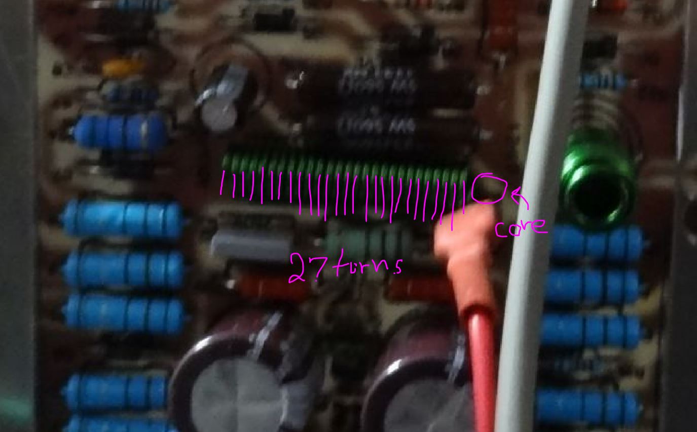

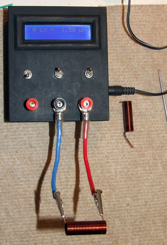

Are you saying that you believe L4 could affect the low frequency of the amp? I didn't use science when winding my coil. I looked for a rod that would result in the diameter that looked like it would fit the layout on the board and the wound a long spiral of 18ga enamelled wire and then cut to fit the length on the board. IIRC I used a 1/4" shaft. I have plenty more wire and can easily make different coils if you think this may be the reason for the reduced bass response.
Thanks, Terry
I'm nor sure if this help but I went to the Hungarian diy website and search for the inductor information, for what I see in this image I count 27 turns the core former looks like less than 10 mm in diameter probably 8 mm dia "I was close" :p
source of the image here:
Quad 606,707, és 909-es er?sít? tapasztalatok és hibák - Hobbielektronika.hu - online elektronikai magazin és
fórum
some translation down
Existing Ones doing the inductor : -the 1,5mikroH -s inductance . 7.6 mm body ( en furore wrapped ) , 1mm CuZm wire was coiled turns 27 1.51 to 1.52 will result in mikroH 4mikroH of a 10mm base 15 march to 13 march and tightly wrapped wire with 1 mm CuZm"
I have to come back again Terry I was looking at your board and you actually did a L4 with 27 turns but the former core I think was too small in diameter maybe increasing the core size you can get about 1.5uH you need :) so far a 7.6 mm core is need it if available if possible of course

.....Are you saying that you believe L4 could affect the low frequency of the amp?
Hi Terry. The output bridge network, including L4, provides the negative feedback which is frequency compensated so the inductor is certainly required to be close tolerance (for an inductor) which is within 5% as per the parts list. L2,3 are only 20%, so you can see the relative importance attached to the specified values. There is some argument about the final L4 value fitted not being quite on the spec. but it may still be correctly compensated in practice.
In other words, if the inductance of L4 is incorrect or otherwise not counteracted exactly by the capacitive compensation in the input stage, the overall frequency response will be tilted. I don't actually know how much tilt would be noticeable but I have noticed that my similar design Quad 306 has a touch more bass than either a 405 or a 606 I repaired a while back. I guess you could measure frequency response well enough with a constant level sig. gen. and your 'scope by comparing response at say, 20Hz, 100Hz, 5kHz, 20kHz with a light resistive load. You could even whomp up the bass as much as you dare by playing with the feedback network :mischiev:
