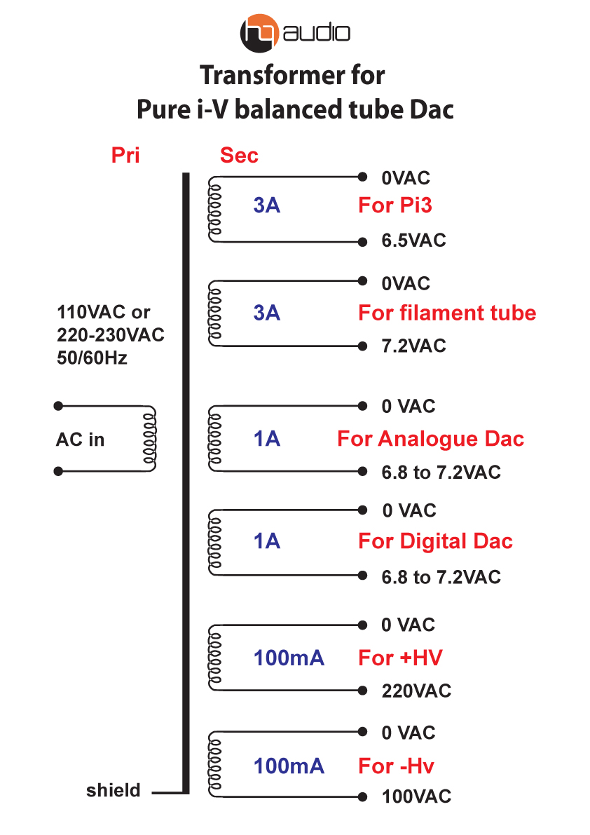

Hi chi0001!
do you have the transformer information"voltage and rating" for HV supply board and for filament?
i cant find from the part list.
This information for Transformer for balance Pure I/V tube
and how can i switch balanced and unbalanced output? i need to update the firmware?
or just connect to control board?
Yes only connect to Control board, i will sent up date later!
thanks

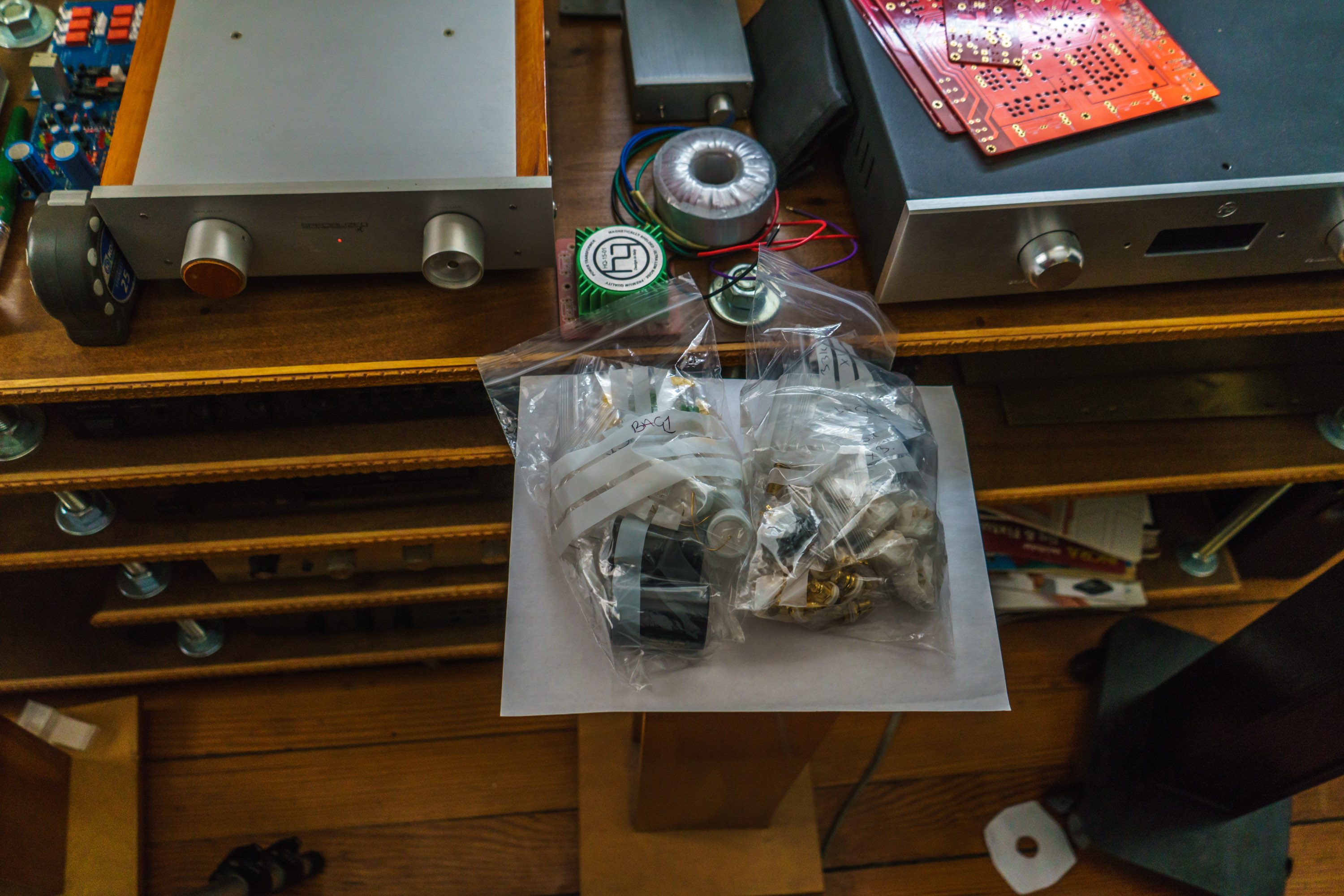

Thanks Quanghao , I got the boards.
All Ok for you now? Please let me know,
Thanks and try to make it , it is best sound off Dac.

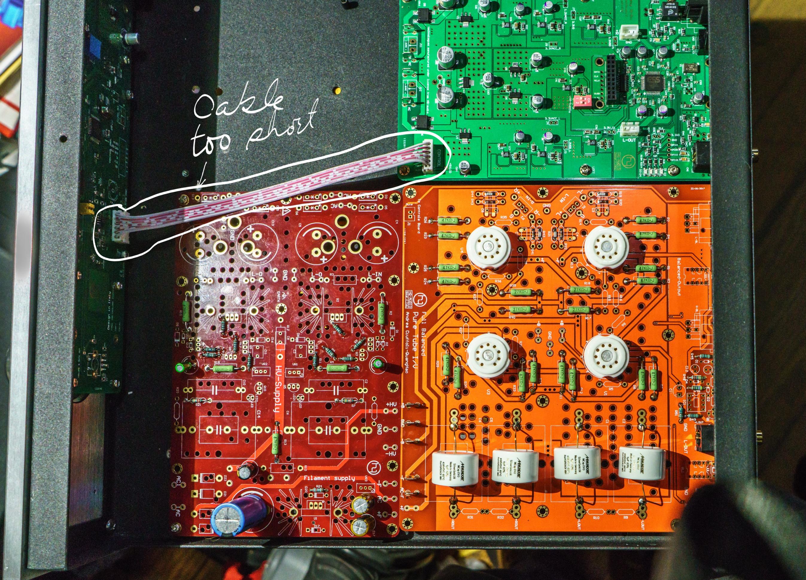

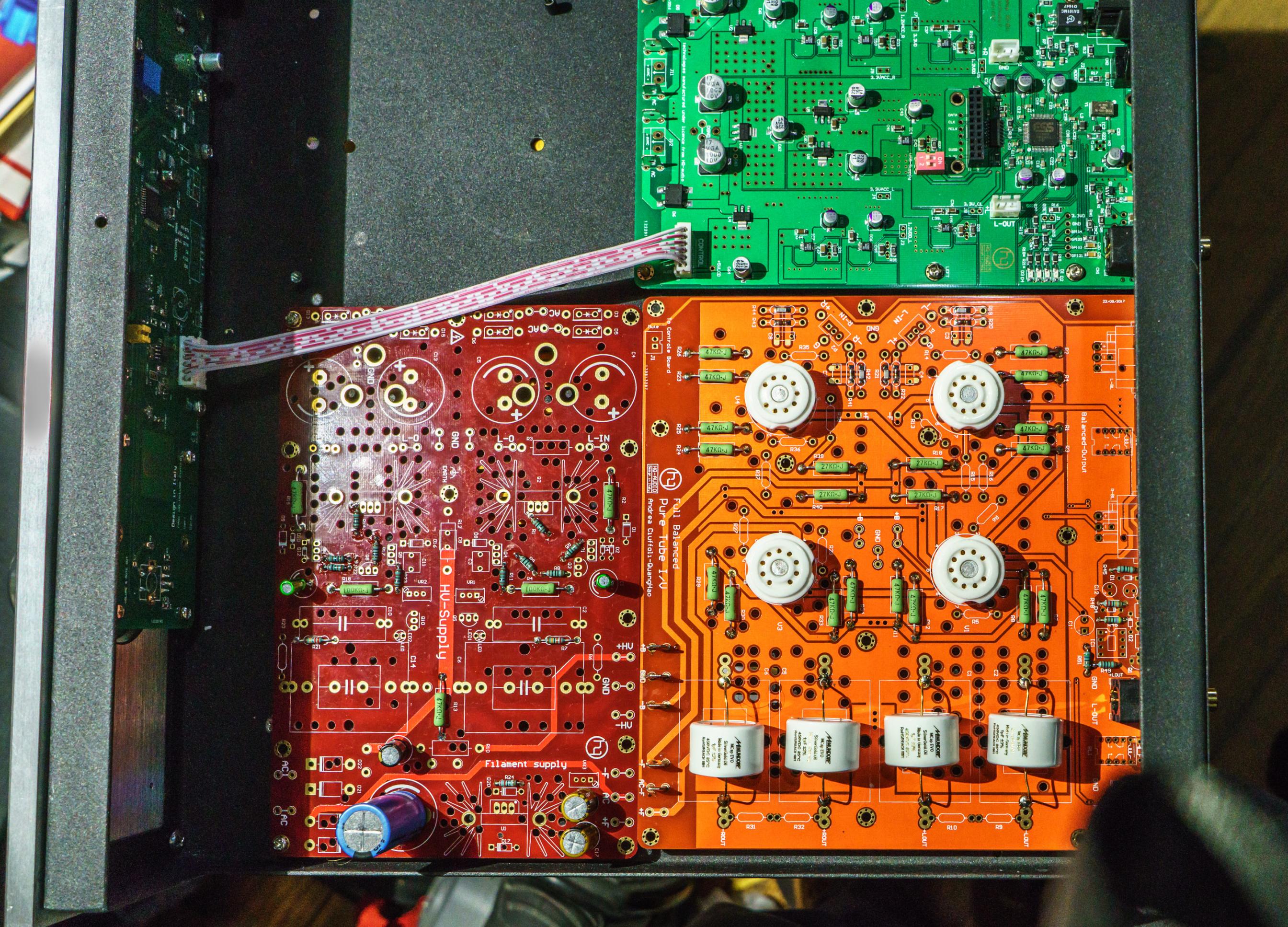

Hi chi0001!
thanks

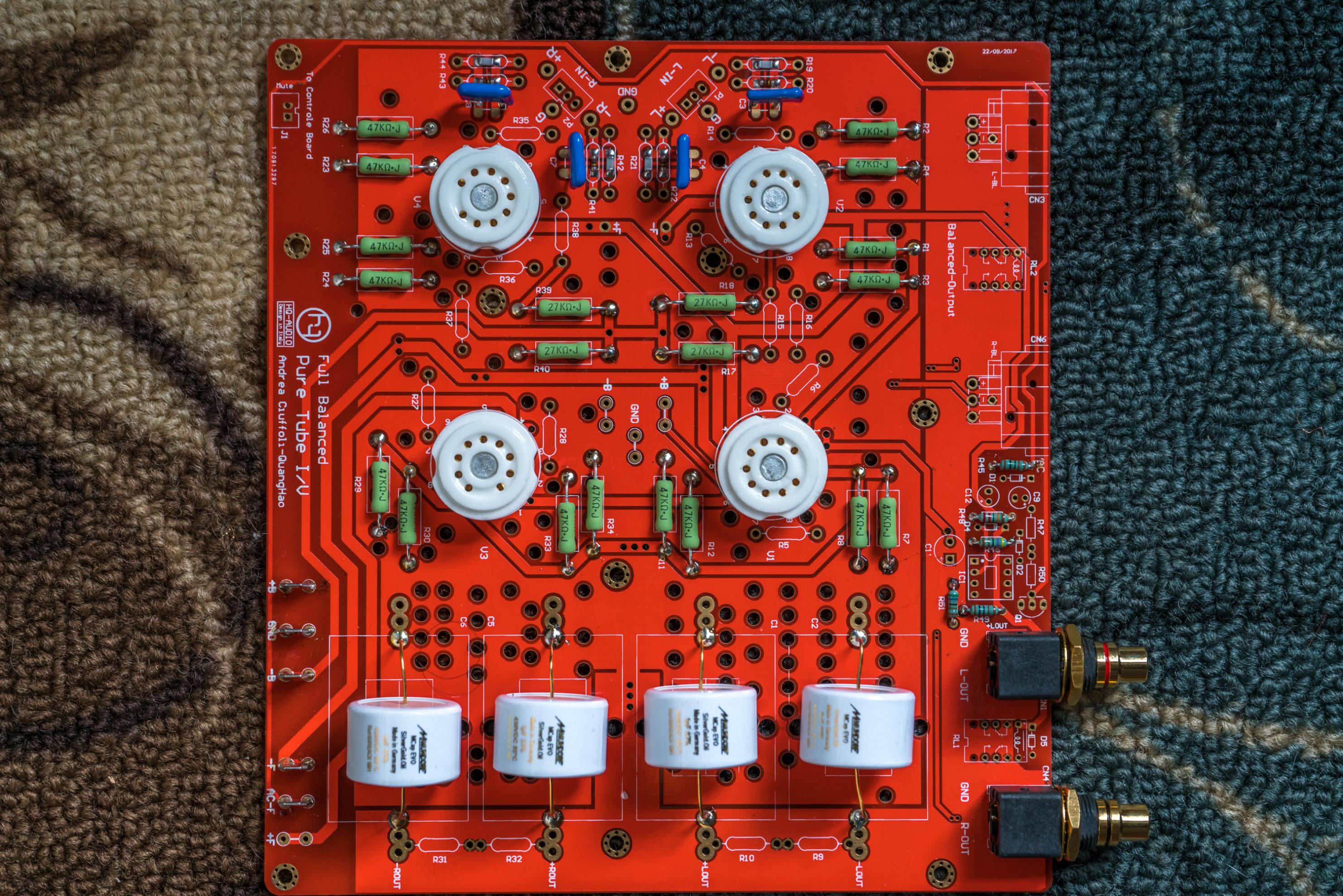

Thanks QH, is ok but I have some questions because started looking for parts and in the part list you describe the audio note resistor like been 560R and 470R , is confuse which one to choose, can you explain this.
2) I do not see the value of these resistors R31 , R32, R10 and R9 on the part list neither the schematics.
3) Also you have to sets of cap Nichicon and Murdorf 100uf/ 450v , I think your trying to say we can choose either one of these sets, because they have the same cap#, then I ordered the 2 sets by mistake . I think if you put a note saying we can choose either one but not the two is going to save some bucks to newbies like me.
So Can you please update the part list so we are more confident to by the parts. Thanks
Hi JPDuarte;5368592
Ok please use 560R. thanks
it parallel with R i/V, so you not need use them ( only use R= 27R )
yes, all Cap with voltage you can use from 350V min.
EX: NICHICON-76195 100uF / 450VDC, KX Series
link: Nichicon KX Series Electrolytic Caps
thanks
