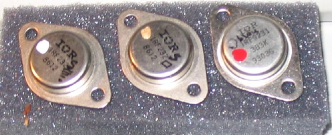

>> i want to know what your IR mosfets are. please , let me see
>>close picture of them.thanks
Well john. these are International rectifier IRF 232 and IRF 9231
in TO-3 package. Bought the paired series of 52 total from a DIYer
in US.
The amp is closed and running playing Rackmaninov, but I can show you the spare...
Regards.
Alain.

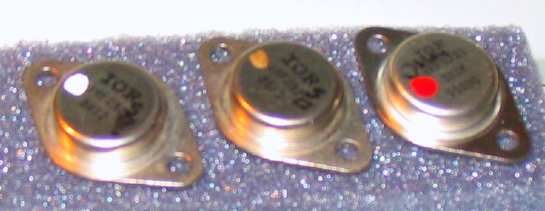

>>beautiful amp.
in US.
Regards.
Alain.

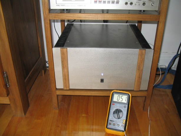

I am Back!
After a week of tweakings....
51/53 degrees after 2/3 hours, about 2 amp bias by channel...
It works perfectly, except a IRF 232 I had to replace.... Mr Static I think !
and repositionned the rails DC relay's back to back for a better look.
The cover fixed with screws...
A place in the rack, just for "El Diablo"...
The bass are tought, the mids and heights a delight . I rediscovered
and enjoyed again a lot of my prefered vinyl's, I hope enjoying it for a long time. And I you want to drive your speakers with Authority, it's the right amplifier.
Thanks to Nelson and Norman for providing such thrilling projects.
I am a happy DIYer...
Cheers.
Alain.
