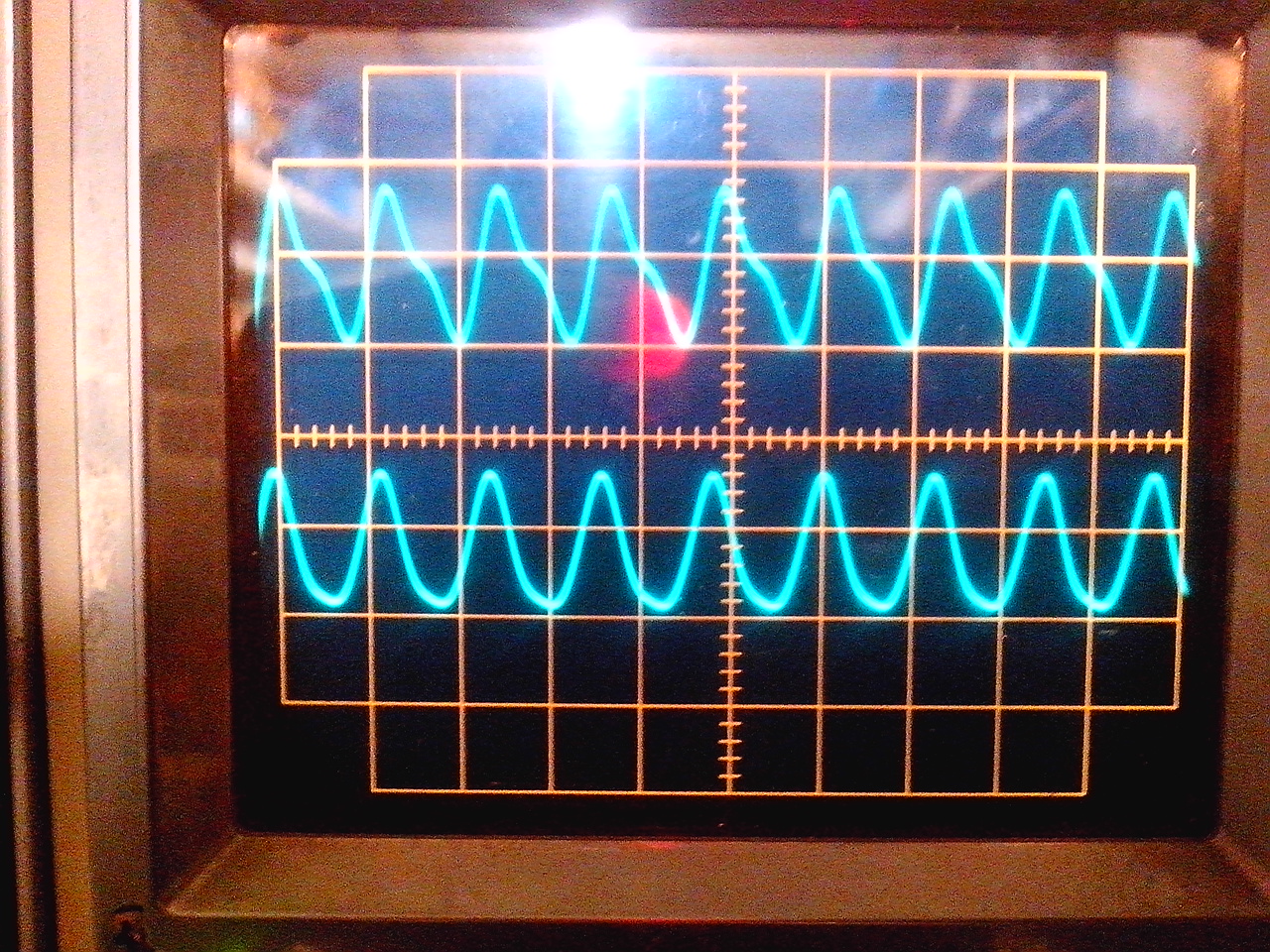

Hi Alex! Today i have started the pumpkin and i have detected a annoying noise, i have detected from my CRO (the picture shows both channels) a hi frequency noise,but what my ears hear is more like a tone of 100 Hz square wave, strange but true!

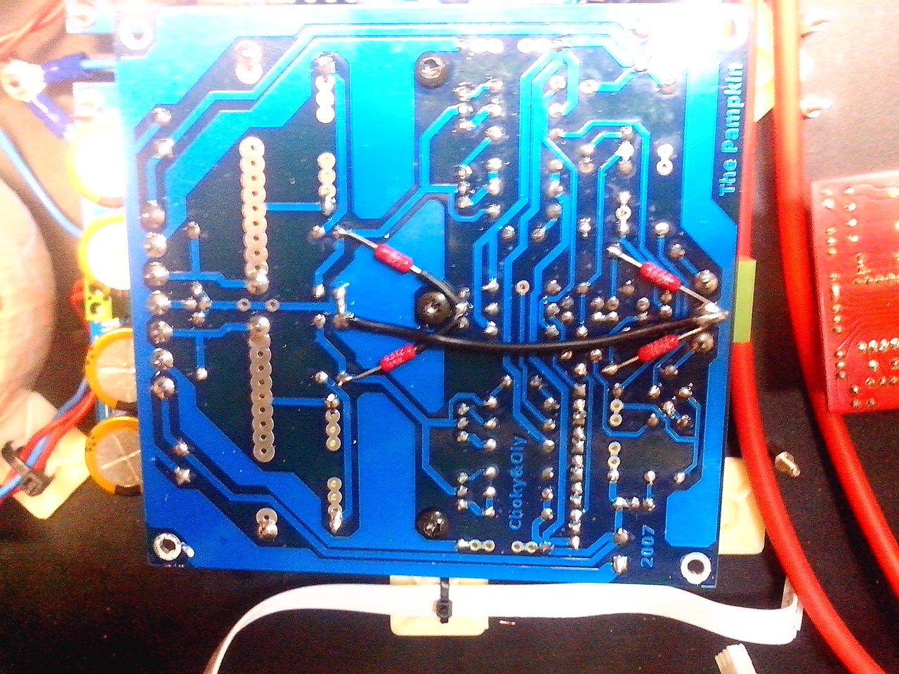

I have to tell you that I used the molex connectors, and I think that the connections with the top of the pcb are probably not ok, so I had to make a ground bridge on below pcb, as picture shows.
I also tried to disconnect the input connector and I have to say that the noise is slightly diminished but not disappeared!
I also tell you that when i put signal it i ears the sound ok !No distortion ..but when i turn down the volume the noise is there to break my balls!
I have already set Wr1 and Wr2 and this all ok and i also add resistor for better DC offset stability(see picture).Please can you send me a diagram with the references of voltage?

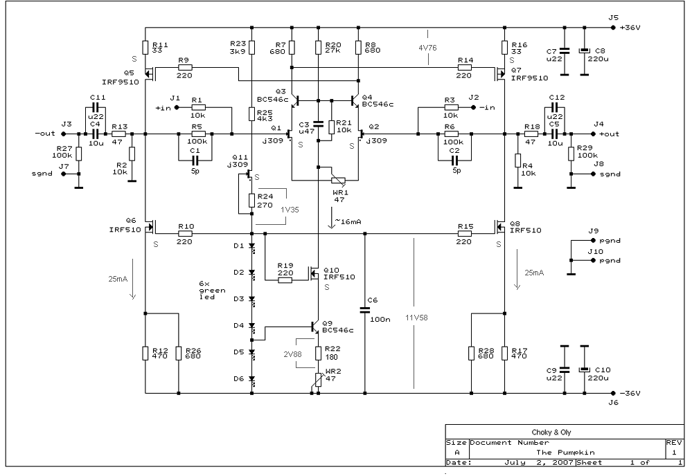

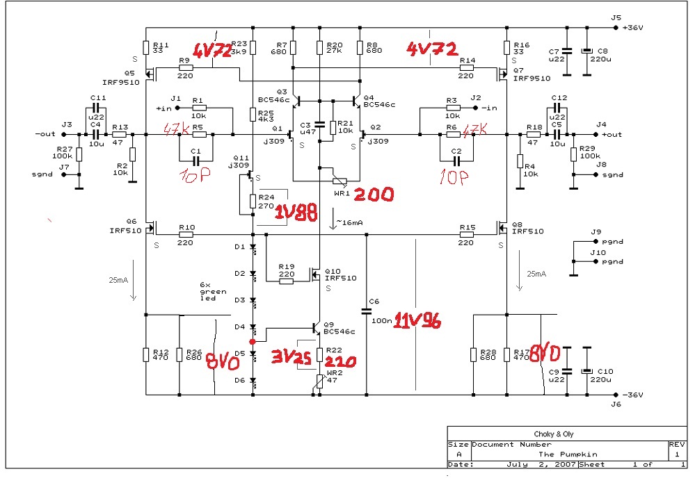

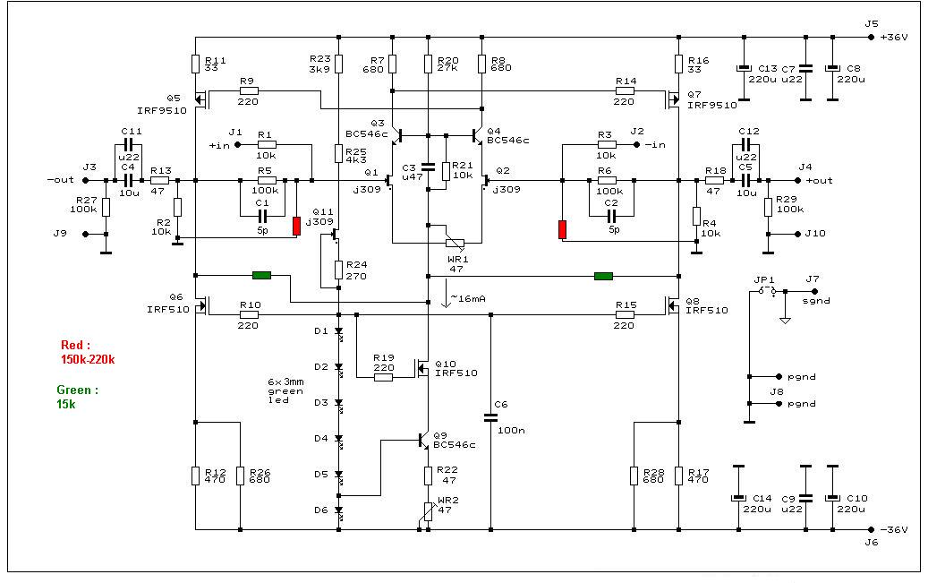

Hi at all! I noticed that there are several differences between the schematic 1 ( that reflects the reality of my pcb) and schematic 2 .
I noticed that i reconnecting R21 but bringing R22 from 47 to 220 ohm things
got better, then I also connected the base of Q9 between D4 and D5.
But to be able to adjust the offset between -out and +out i had increase
WR1 from 47 to 220 ohm.
Now Noise is OK! (please see shematic 3)
Strangely I have a gain of 4 instead of 4.7 using R5 and R6 47K and leaving R1
and R3 10K, I also changed C1 and C2 from 5p to 10p.
I think everything I've done.

whatever - it seems you had difficulties reading Cook Book - (sorry - I'm ignorant peasant , knowing just few words of Italian , so I couldn't make Italian version ;) ) , so you obviously messed up something , somewhere
most left schematic is last , valid one , while middle (and most right ) one are somewhere from thread , during testing and developing
whatever - it seems you solved those issues , except lack of highs , which I'm finding somewhat doubtful ; accoring to AR2's measurements - Pumpkin is some 0,5db down on 20KHz ( with highest gain setting - for F4) , but that's nothing comparing to our hearing capability , considering age
