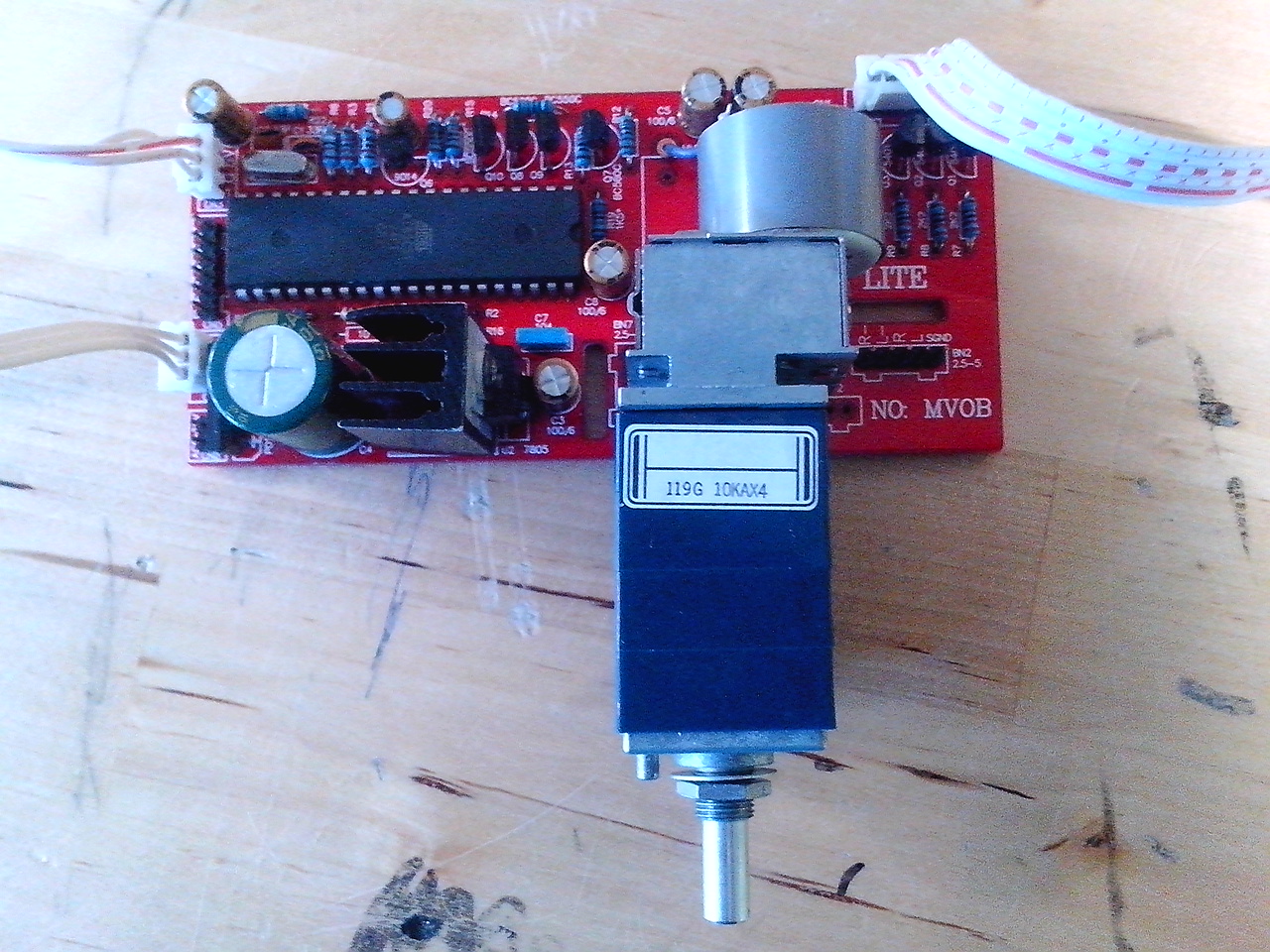

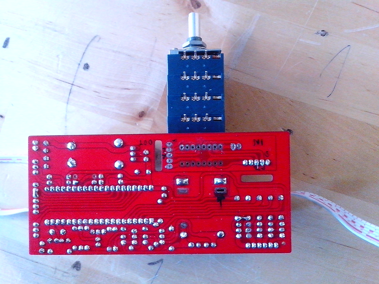

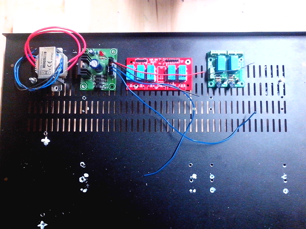

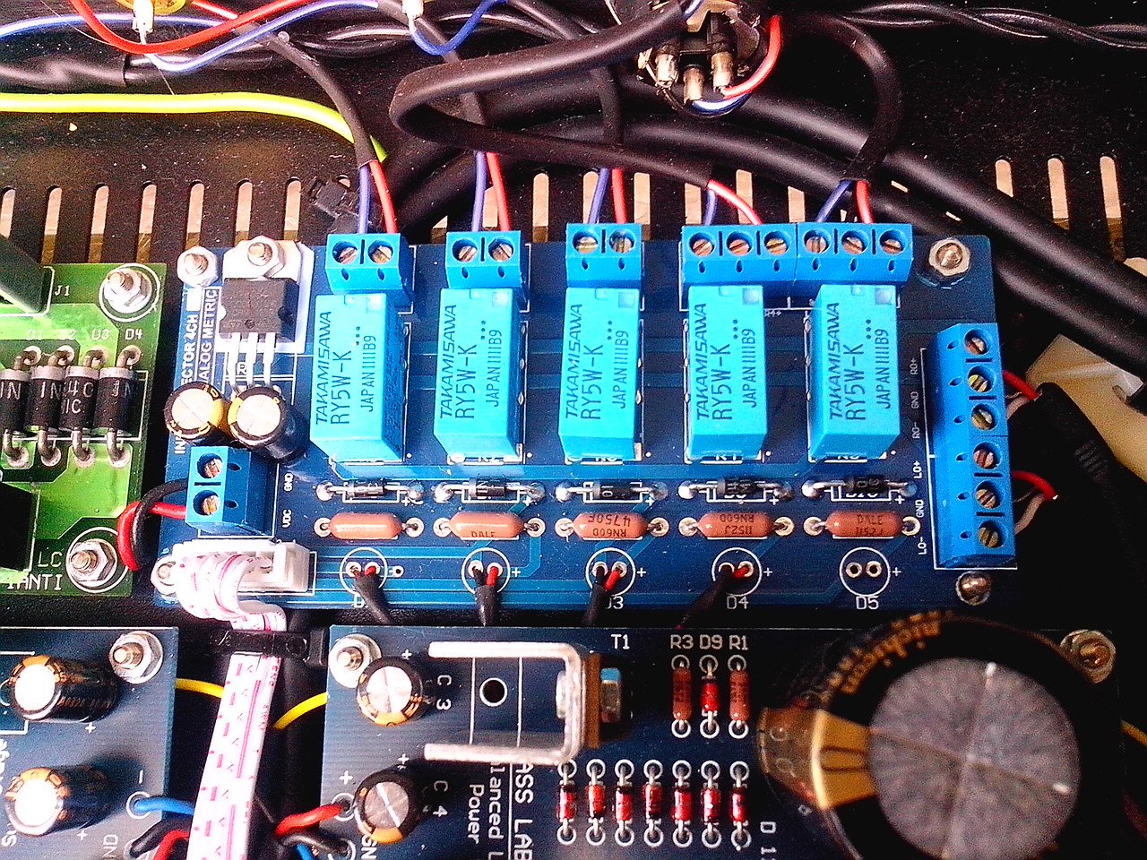

Hi Alex i will use the input selector and volume control showed in pictures attached (red pcb).
I had to change a few things to be able to make it suitable for balanced use . I also have replaced its original pot with a four-way 10K Alps (much better than the original).
In this way i will get the same functionality of the input selector shown in the last picture more the possibility of remote control.
In the third picture the last pcb on the right will serve to keep the outputs to ground for a few seconds (about 10) to avoid bump input to the power amp.
What do you think of this device?

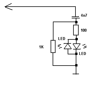

The question is about C5 1nF Polyester (as project) or 1nF Silver Mica (can it be a upgrade) or without C5 (can the amp be yet stable or not),in this last case how i can check if it is yet in sure zone?
check for oscillations on output with CRO
if you don't have any , don't use these 1nF
if you need them - put whatever you have in drawer - no need for mica

for start - if you're not having enough praxis with CRO , just connect this (attached) across spk terminals,of course - with amp powered on
in silent , then with some light level muzak
if LED's are silent , you're good to go , without those two 1nF caps
Cathode Ray Oscilloscope (CRO) ...Good to know,thanks Andrew!

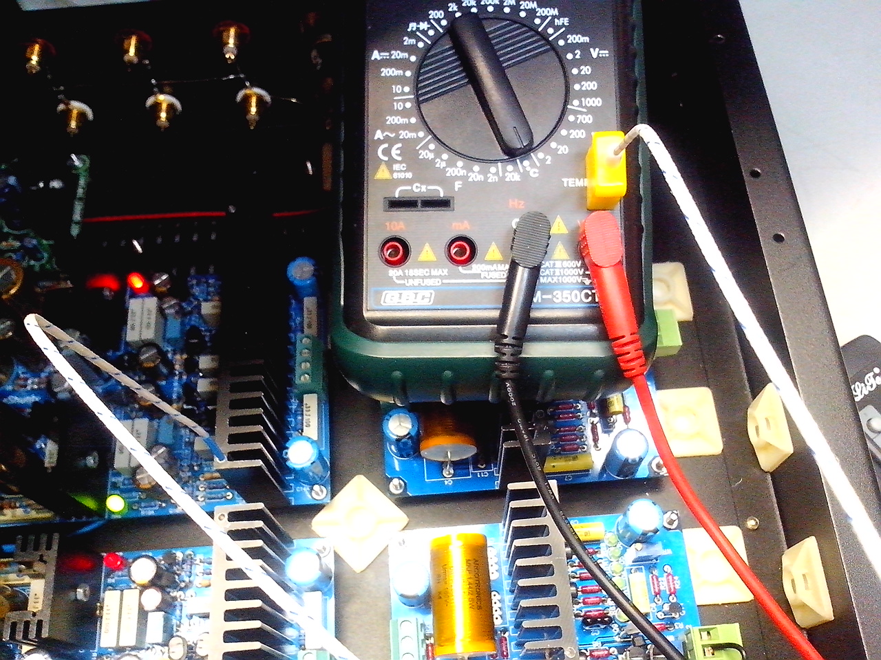

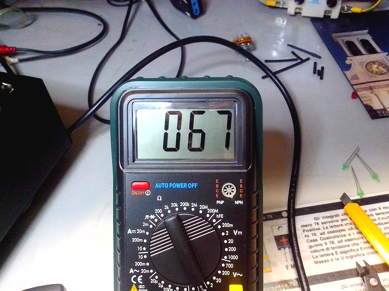

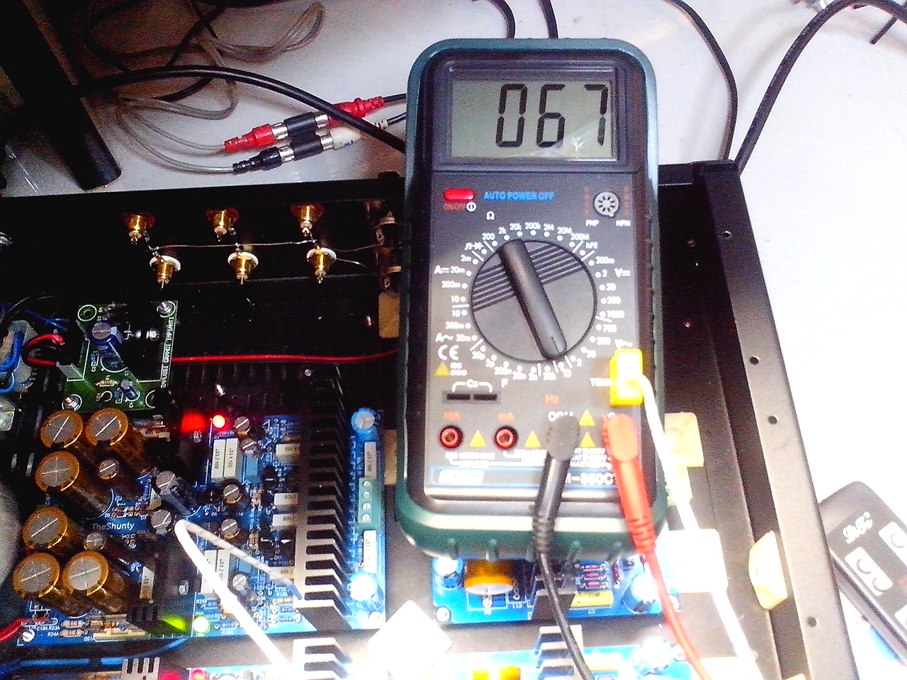

Hi at all! Please is normal about 70° measured on heatsink of shunty (no load connected and cover open ) ,or i have to add more alluminium sink?
Thank in advance
Antonio
Thank in advance
Antonio
without load , everything is dissipated on Shunty itself
when you connect load , dissipation will go down ........
so , just relax
Thanks Alex!
I supposed instead that connecting the load shunty would collapse!
Sorry my mistake
