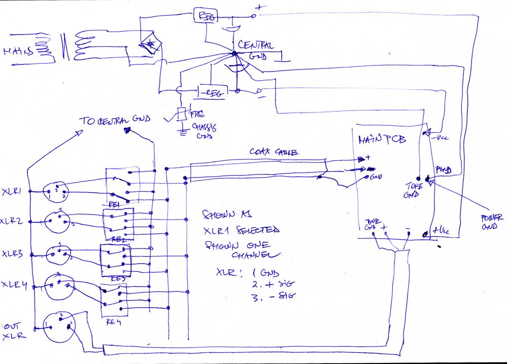

lykkedk said:
I give up on, and start all over again i think... This setup i have done is giving me sooo many problem's unfortunately.
This is where i am now...
:Pumpkin: is working 100% (told before i know :D), as long as i use 1 'directly' input with wire's soldered directly on +in pin's.
I will try to make a new inputselector, with balanced input's only. When i use unbalanced input, the -in will be shorted inside XLR ---> RCA adapter cable.
(ZenMod suggested this earlier in thread)
This time it should be perfect!
1. quistion. what about the -in connection on other side of attenuator ?
2. quistion. should i us a ''star'' ground attached in middle of chassic, where all GND wires go to...
including the 3 or 4 gnd connections from input XLR ?
including gnd from psu
including gnd from output XLR
etc.....
etc....
3. quistion. Will it be good to GND unused input connection's or should i gnd them through e.g 100K or 10K resistors, i mean... Can all sources stand up for a shorted output ? (dac / riaa / squeezebox / walkman :D etc.... ...)
Jesper.
hold your horses ;
I'll draw later tonight everything for you ........ balanced input selector with omrons or takamisawas , and grounding scheme, along with grounding of unused inputs
btw - source which cannot stand up shortie is good for nutin'
OK... ZenMod ... that's really great that you are going to make such drawing's.. I really appreciate it.
I will have a look at it, and make schm. / pcb-layout at end of week then...
Please don't hurry up for my sake... I am allway's glad when somebody want's to help, as you allways do!!!
Well... I am actually finding this amousing, not that i am not a bit dissapointed, that i coulden't make my ''fancy'' inputselector behave as i would... But thing's are really clearing up in my head now... if you know what i mean. All that stuff, i allway's was wondering about how it was working, is suddently comming clear to me, while learning... That's something i can thank you for ZenMod....
But no more thinking for me today. Looking forward to see that layout you are comming up with !
Keep it up...
Godnight from Jesper
Official Court Jester
Joined 2003
greedy danske - he is now going to sleep ;)
there it is
ask if you wanna ask ..........
I didn't draw 4 position switch for powering up relays...... that's even more trivial than this
also - I didn't draw attenuator .......... is that necessary ?
:clown:
don't forget to place diode across each relay coil ......... appropriately oriented , off course :devilr:
:devilr: Yes, you can tell me, what about -in connection when running unbalanced ?
As i see it, you are going to short pin 1 and pin 3 on XLR input's for running unbalanced input.
But when attenuator is placed somewhere at coax (russian?) cable the -in on pcb arent shorted anymore.
The shortning will be, whatever the attenuator is set to somewhere between 0 --> 10kohm in my situation ?
I assume that this is intented to be used with 4channel attennuator, so this is relavant for me to know...
