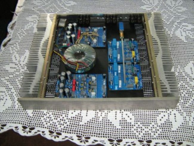

Hi Guys,
I got things working. I had a quick listen, it is one amazing amp. No doubt about it.
I had originally sized my cabinet for one trafo, it is a 14" Par-Metal cabinet. Due to my trafo problems mentioned earlier, I am now using 4 trafos. This eliminated the space inside the cabinet pushing one channel right up alongside shunty and very close to the trafos. Not surprisingly this channel has a pretty big hum If I removed the board amd let it hang outside the box putting some space between board and the supply the hum reduces. It looks like either I have get a new and bigger cabinet or take the trafos out and put them in a smaller cabinet and make a 2 box system.
Can anybody suggest some inexpensive cabinets?? Or could this be solved other ways??
So close, yet so far.

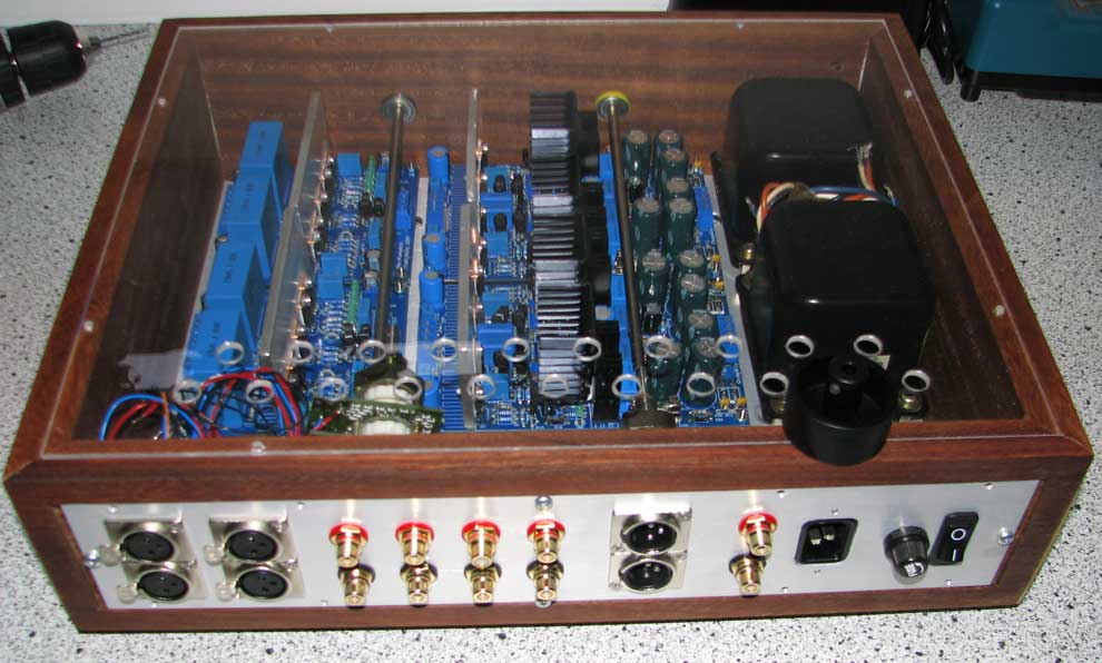

I'm just looking at steen's pics ....... in hope that I can find some adequate pic for dviswa but - naah ........ steen have just two xformers , potted , and Shuntys are between them and Pumpie pcbs ......
anyway , I'm just laughing ....... look at this drek - all that but only 4 active devices per channel (two per leg ) .... !

I am using the Mercury Magnetics TA110-W from ApexJr. 2 Trafos per channel. I also noticed these trafos do produce a good bit of audible hum, the Magnetostriction vibration variety. I tried tightening the screws down to stop the vibration, not much use. Don't know what trafos Steen is using. I am not too keen of pottig the trafos myself . Surely, the trafo vibration is another thing I need to fix. Any ideas on how to dampen the trafo vibrations down?

jacco vermeulen said:Already tried a screen between the TA110s and the pcb ?
Jacco,
No, I have not. What type of screen did you have in mind? Mumetal or something? Yes, that is possible. Any suggestions?

naah ....... steen is master scavenger , even if he certainly put nice gross of greenies in his scavenging

put these buggers in bucket of varnish or glue or paint ; let them soak for 30mins and pull them out ; leave them overnight in outdoor and pray
nothing better than separate box for noisy xformer ( or noise inducing , whatever )
mumetal will help just a little , if trouble with them is already apparent .

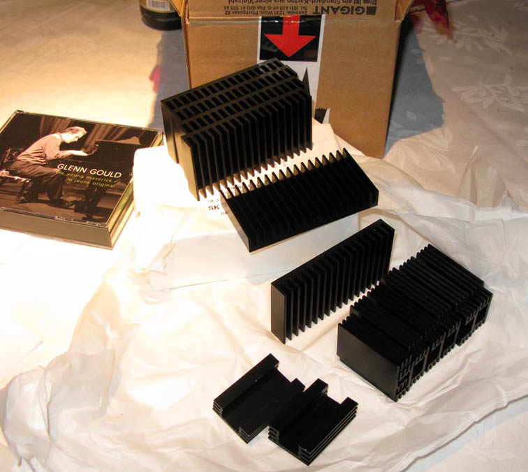

Returning to an old question, but here you go: They do fit, and they will run hot Weighing them in my hand tells me that they will get pretty darn hot....housing said:Do these heatsinks fit on the Shunty and the Pumpkin?
Thanks a lot, Manu
any heatsink requires ventilation ........ 'nuff fresh air ...........
seems that Steen neglected that fact slightly
conditio sine qua non
