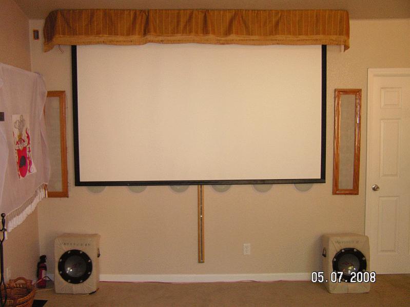

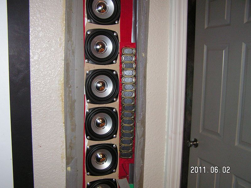

Nice job Wavebourn. Are the fostex speakers mounted on a shallow curved baffle. It kinda looks that way in the photo. Is there any weighting to the various units?
jamikl
No weighting, but a bit shallow (tweeters).
The much dreaded comb filtering always seems to come up when line arrays are mentioned. But that is not a problem compared to the alternative of point sources in a room and placed away from the walls. Actually, it is not a problem at all because even though it appears in simulations and is seen in high resolution acoustic measurements, it is completely inaudible where the listener is in the near field of the array (everywhere in the room!).
100% true.
