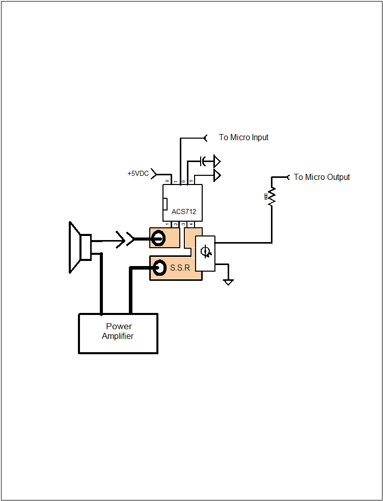

Test the prototype solid state relay in my amplifier and noticed no sound degradation or distortion. Test it with a sine wave and also no wave distortion was noticed. Next step it is to read the output current using the linear ACS712 current sensor. I was going to do it reading the voltage drop to a resistor but the voltage was too low and require an op amp. By searching the web I found the ACS712. The output voltage it is a linear proportional to the current. I am planning to install it as part of the solid state relay.
Attached it the design drawing.

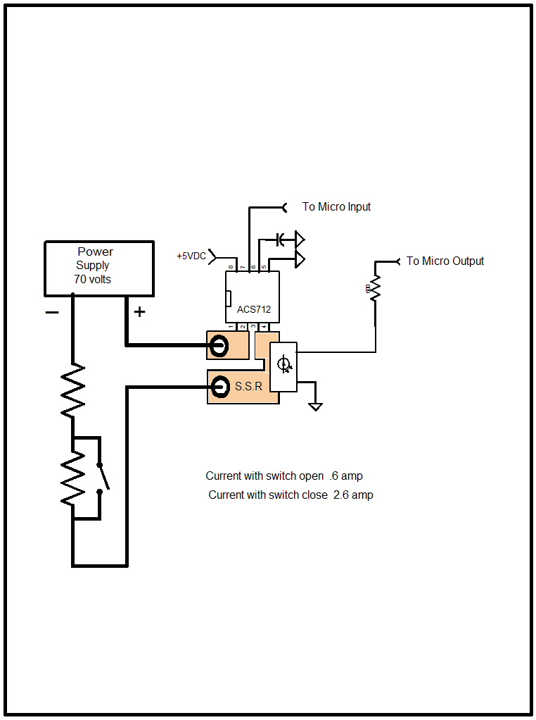

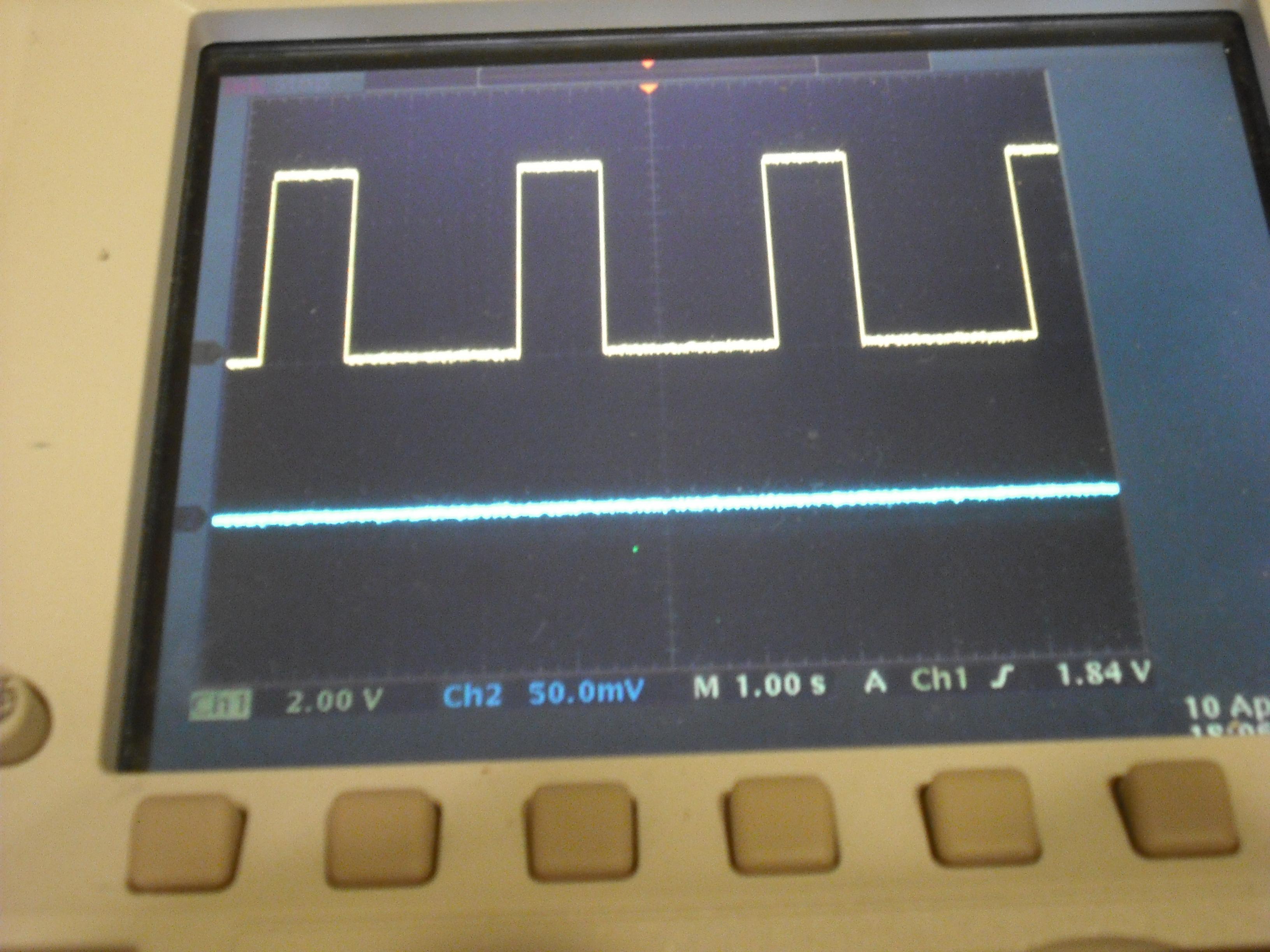

Finally the ACS712-20 amps Hall effect current sensor arrived today. I built a jig to test it using a 70 volts 4 amps power supply with two resistors and a switch to bypass one of the resistors when an increase in current it is require. Programmed the micro to monitor the current sensor and turn off the SSR if the current reached the 2.00 amps or higher. Also to test under load I used my SSR as part of the test since it will be part of the final project.
Some members requested the test to see the feasibility of monitoring the current to protect the speaker from high voltage. This is a big problem with high power direct output couple amplifiers.
The purpose of the test it is to simulate a failure of the amplifier output transistors and see if it is possible to disconnect the speakers by monitoring the current before they are destroy by the high rails voltage. This will be accomplished by shorting the resistor to simulate an amplifier output transistors failure. This will increase the current to a point that supposedly should burn the speaker but by the used of the micro this will be prevented.

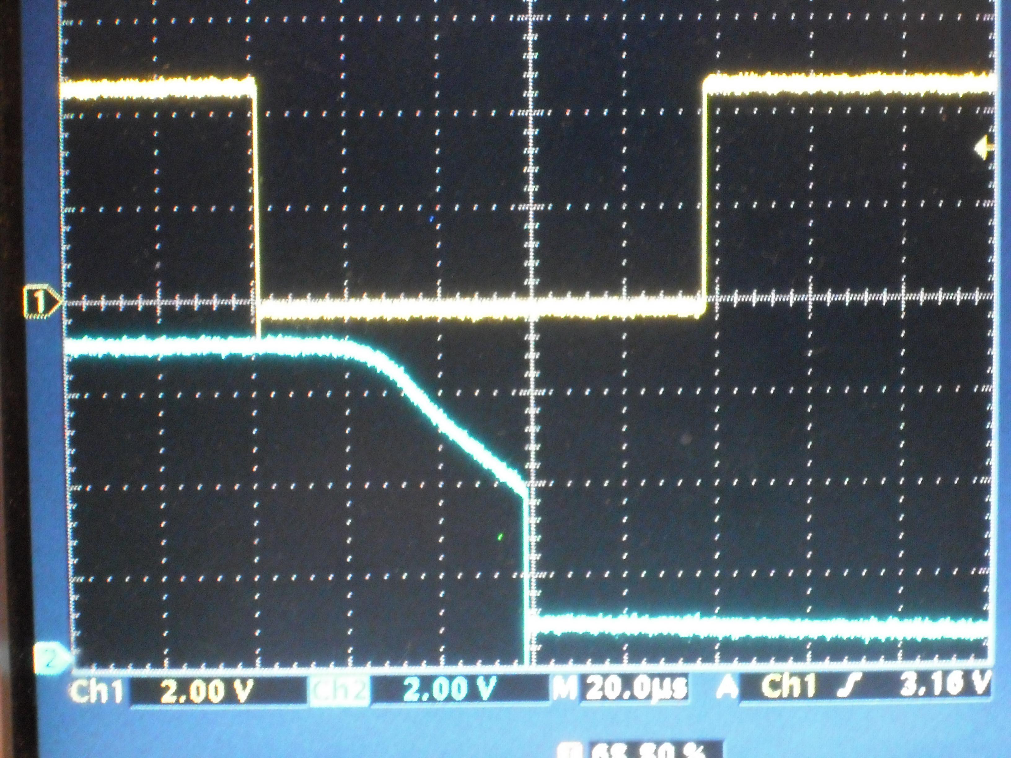

Attached is the scope picture showing the test resulted. The top signal it is the SSR enable signal and the bottom it is the signal of the 70 volts coming out of the SSR to the load, High signal means that the SSR it is enable and a zero means it is disable. The micro will monitor the current and when it reached a limit of 2 amps the micro will disable the SSR by sending a 0 volts to the SSR.
As you can see it took 60 usec for the output voltage to go from 70 volts to zero volts after the micro disable the SSR. This delay it is due to the Avago photovoltaic mosfet driver turn off time. This test proved that it is possible to protect the speaker from a total amplifier output transistor failure by monitoring the speaker current.

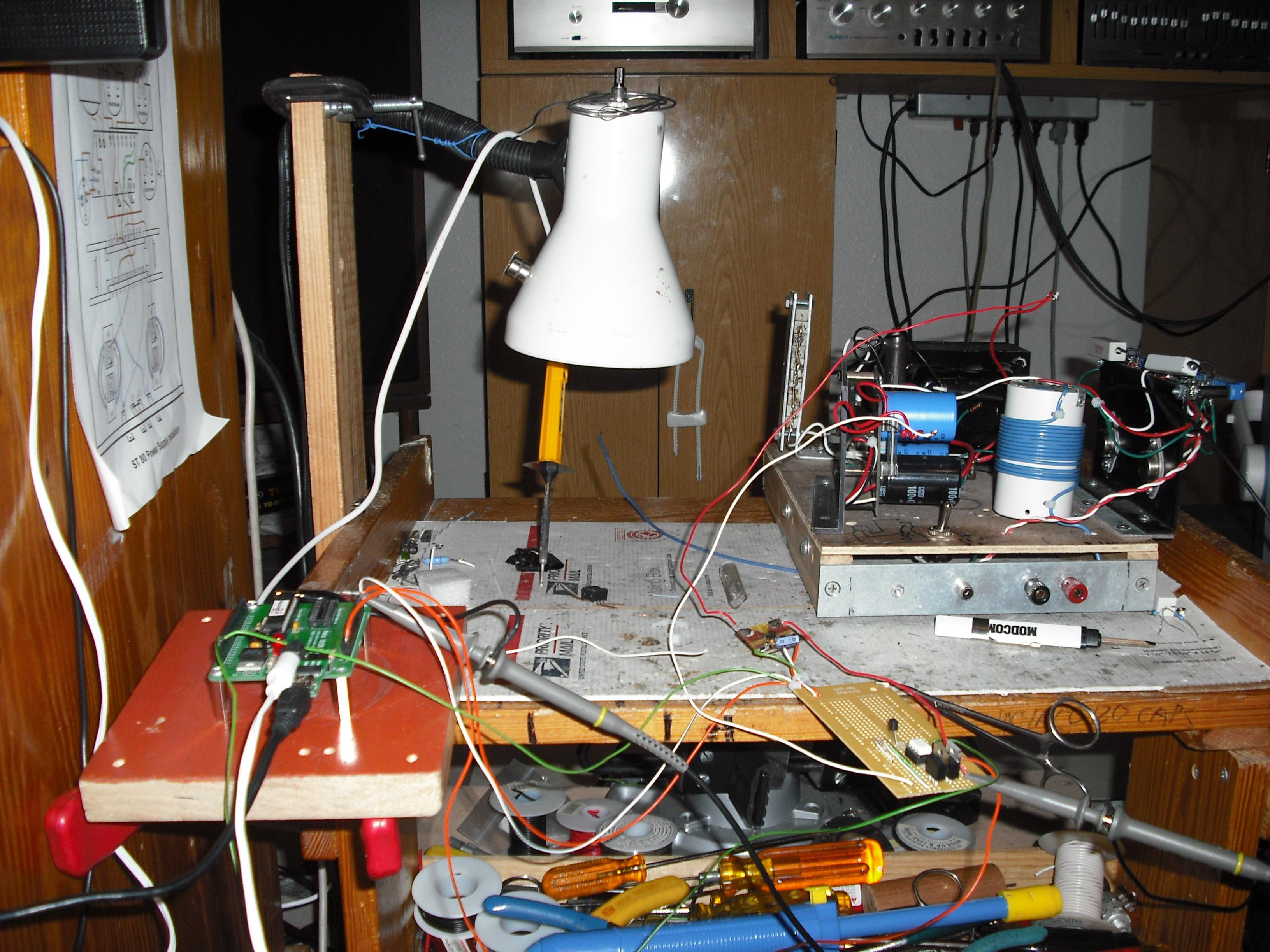

Also attached is the test jig schematic and a picture of my test area.

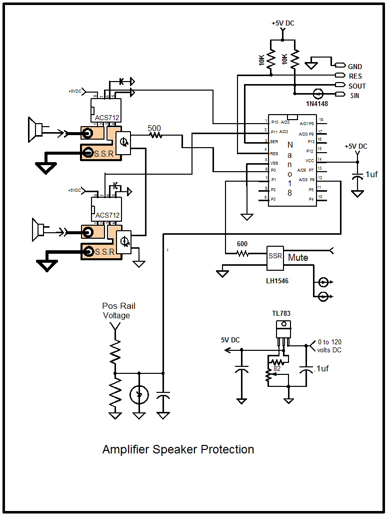

Right now I am in the final stage design of the project. Due to the good results of the current checking I am making the decision to design the output protection using only the current output. By checking the status of the current output I can determined the output health of the amplifier and it will let me to make a decision on disable or not the SSR to the speaker. I will used only the positive rail voltage to mute / disable the speaker output SSR when the amplifier if powered up/down. All other test are unnecessary in my opinion. Since the sensor can read +/- current it will allow me to check both +/- rails failures and disable the speaker output.
Please those that are following this tread your advices and recommendations are welcome for anything that I am missing out.
Attached is the final schematic.
