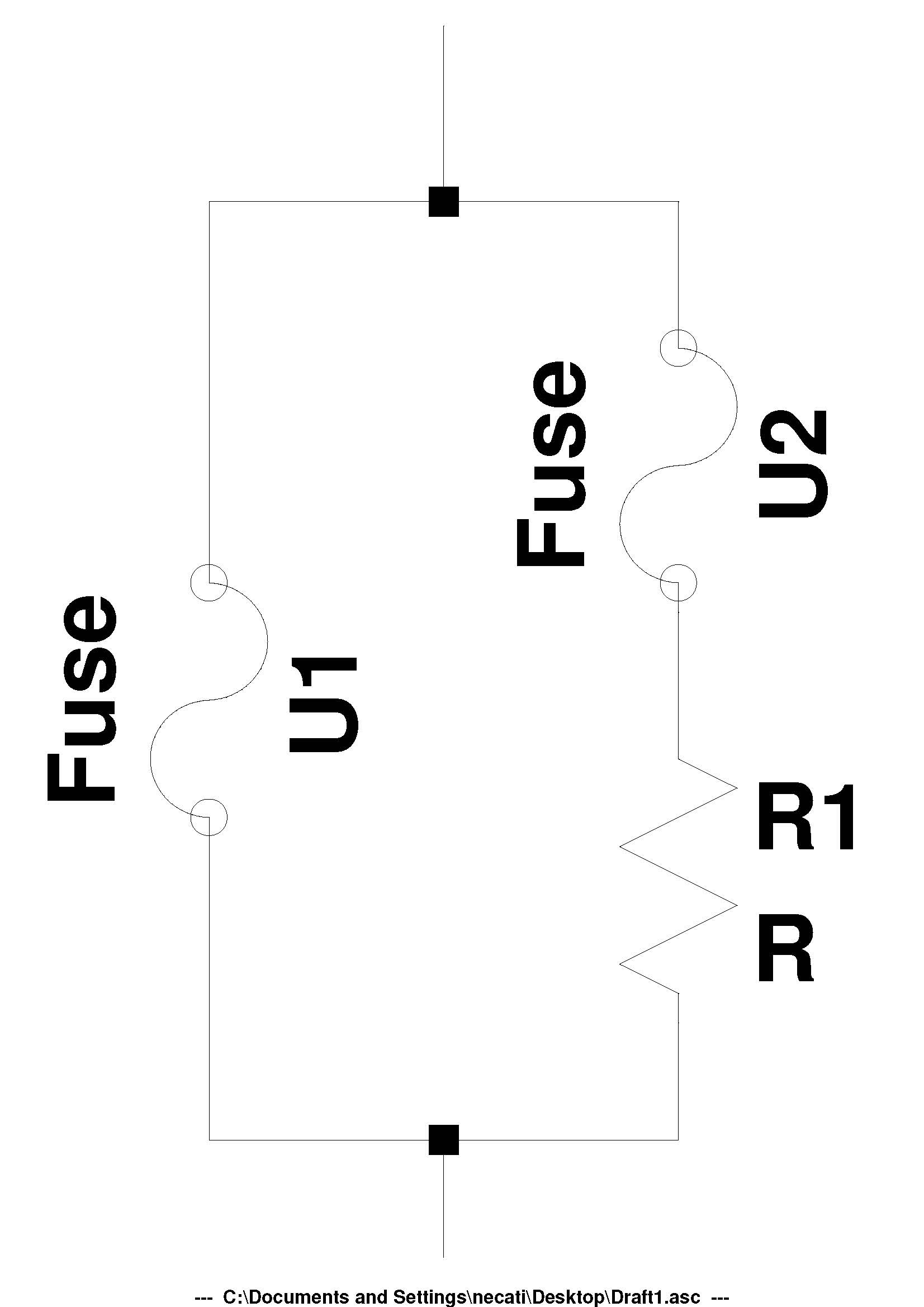

This will not supress the spark in a sudden completely but reduce to a harmless level before cutting the circuit off .
F1= desired cut off current
F2= 1/2 F1
R= slightly lower than B/F1
F1 cuts off. Current ( so the spark ) is limited to a lower value by R.
F2 cuts off .
Simple and, i think, reliable.

GDTs look to be very promising. I think I will buy one rated for 240VAC and put it across one of the primaries on my Plitron amp. That one doesn't normally have very high voltages on either of the primaries, since it is a 50% CFB design.

It's 335 volts on primary, approx 80 milliamps on each side of primary. 600 pf of primary capacitance. Don't know on secondary. 2k ohms impedance on primary using 5 ohm speaker model. It will be driven ab2 with individual mosfet followers per tube with only 10% cathode feedback from the OPT in the cathodes. That seems like it should be enough for you to work with.
I think I'll probably go with George's idea of GDTs across primary unless you have a compelling reason not to.
