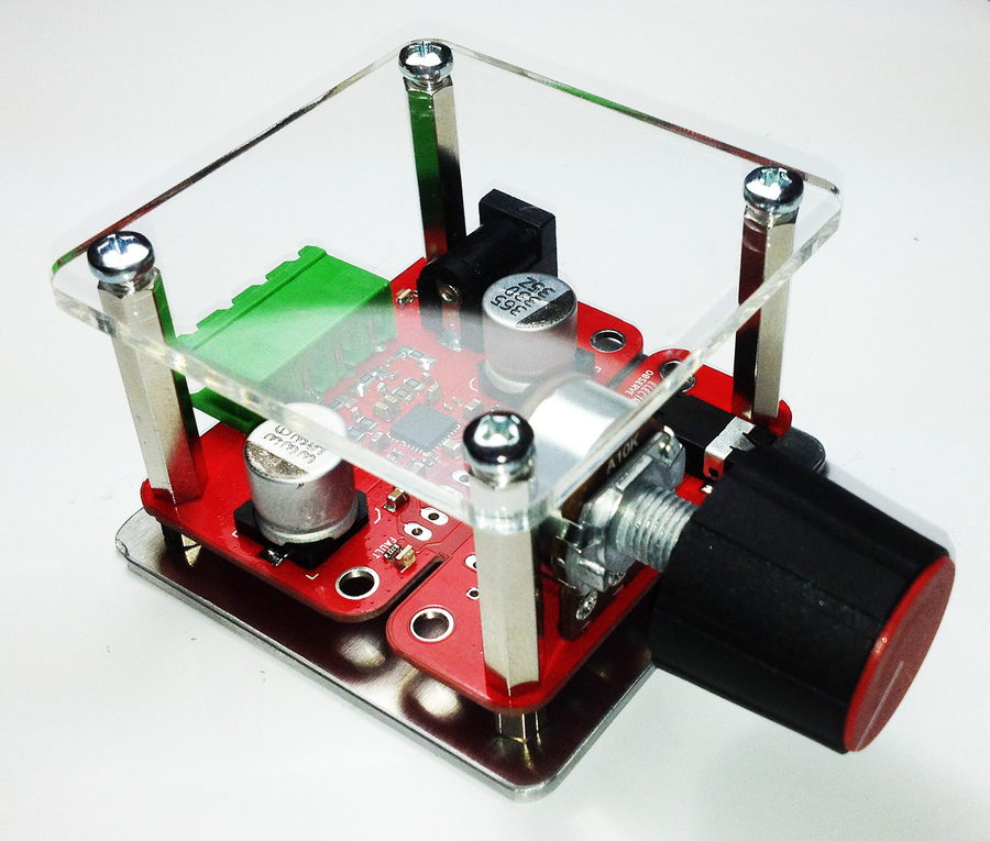

My first thought was a "sick of beige" case.is that a drool shield or maybe like a glass protector spotted in a smorgasbord.
^I like it! esp the way you incorporated your pot separation > clean analog section.
Sick of Beige compatible cases - DP
Wiener GB thread made. Hopefully some people will bite.
http://www.diyaudio.com/forums/group-buys/269855-wiener-tpa3118-amplifier-card.html
Yes, these boards are made to fit in sick of beige DP5050 at full size and DP5031 broken down. (You may even fit the pot-pcb on top upside-down da save space)
