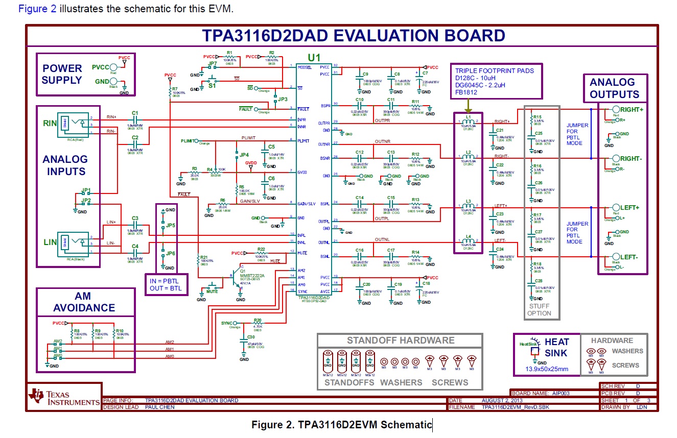

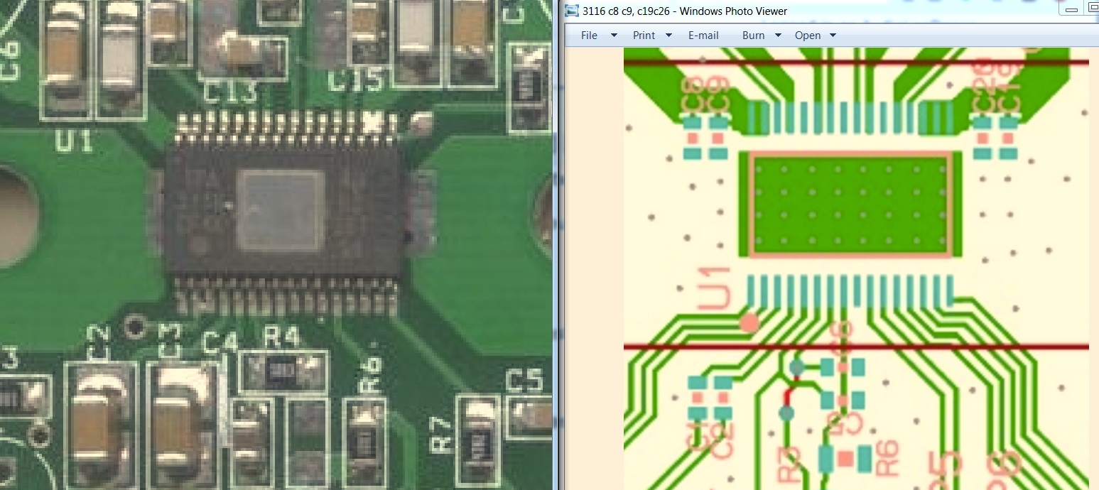

It has to have proper hf SM bypass since it's a 'digital' chip, like the EVAL:
Errr, I think the heatsink is overkill, so a smaller one that lets me get the PS Electros right next to the chip, would be perfect!
... and I'd love big, proper differential input caps, sm and th would be awesome! (even for single ended). You know how I love to tweak, Santa.

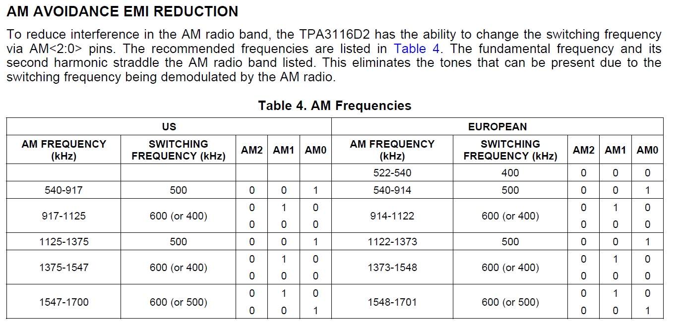

And of course retaining the ability to choose the switching freq is perfect.

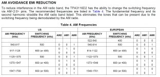

But I'm looking for selectable AM mode (at least) like the EVAL:
And I'm ... anal about high freq ps bypassing, sooooper-anal!
Regarding the bypassing, I like the EVAL's much smaller size smd caps (less package inductance and parasitics), slightly shorter traces (less inductance) and much shorter gnd path back to the chip (smaller loop area).

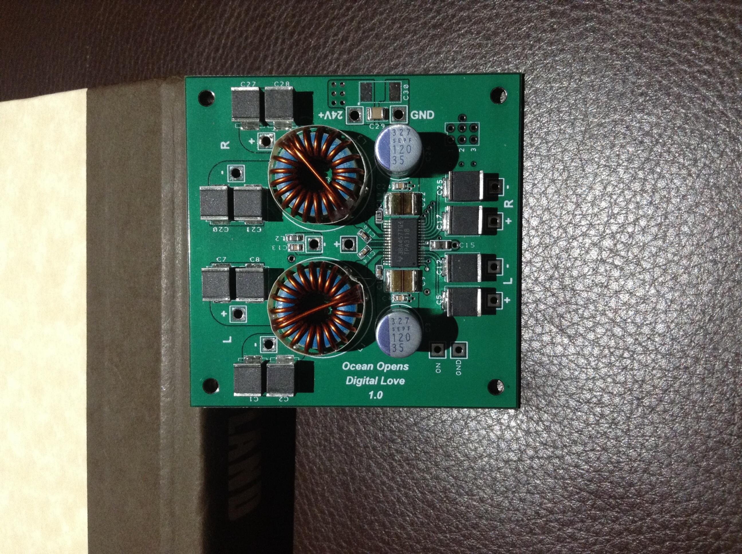

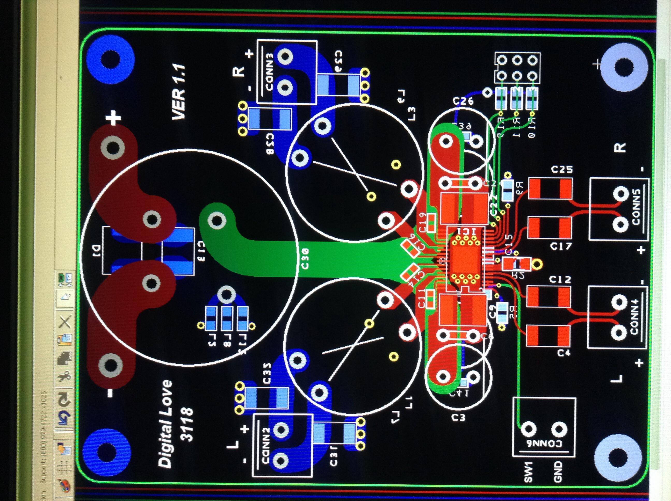

Couple thoughts...
*Move to a 4 layer board to have a dedicated Ground Plane. Improves layout options and deals nicely with the return current issues
*properly bypass the chip supply with either 1210 or 2220. Also note the recirculating current issues with a step down switcher. Make sure the main supply caps gnds are close to the chip gnd..
*Opposing Toriods on each side of the board. You can hide stuff underneath them. Allows for very short switching nodes.
Use the 3118 and dump the heat to the ground plane and remove via the corners. With the heat sink gone you can tighten up the design.
Time to move outside the box.
Dwight
Dwight

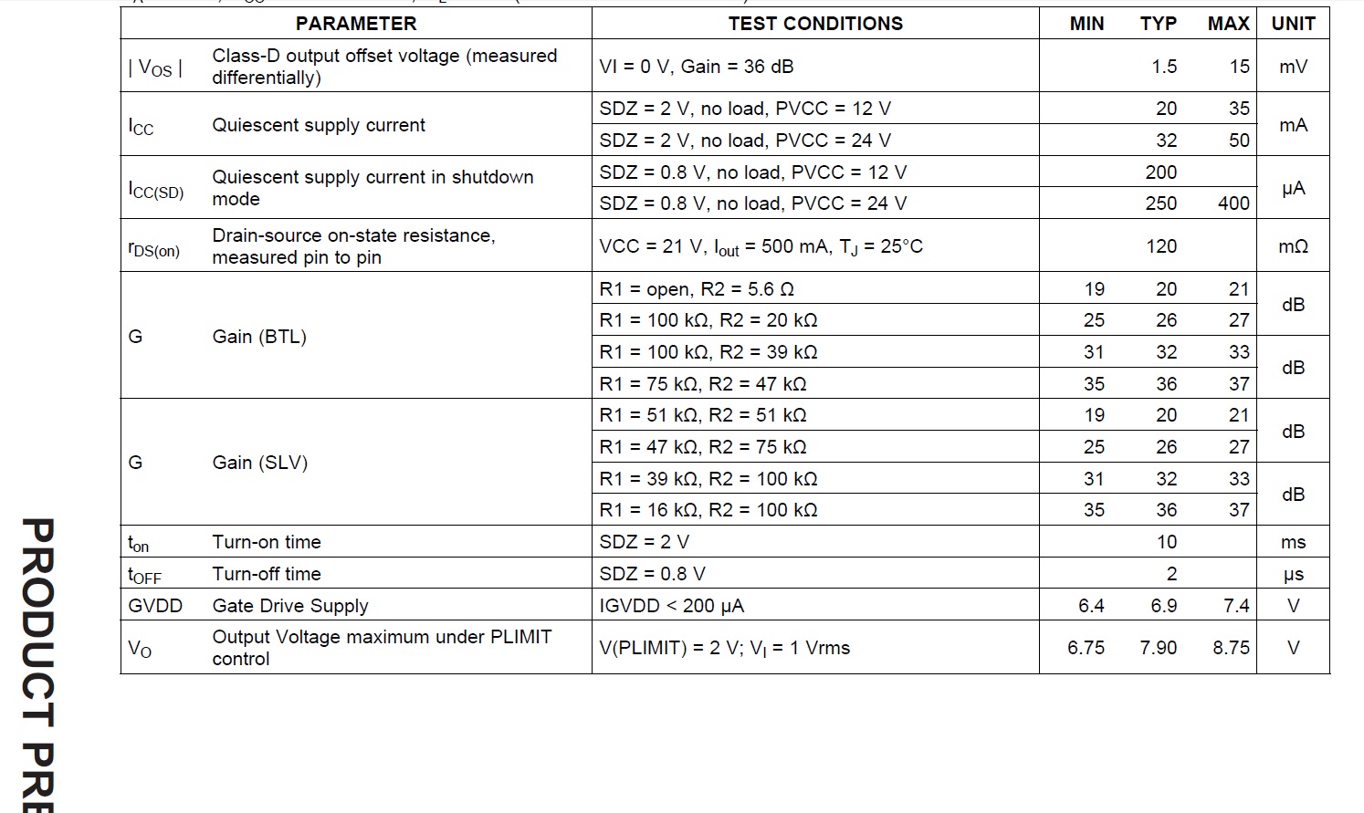

Wow, very nice! Where can a gentleman acquire this 'ocean opens digital love 1.0' ?
Can you tell me more? This is different from the TDA31xx spec :
PRINTED-CIRCUIT BOARD (PCB LAYOUT)
The TPA3116D2 can be used with a small, inexpensive ferrite bead output filter for most applications. However, since the class-D switching edges are fast, it is necessary to take care when planning the layout of the printed circuit board. The following suggestions will help to meet EMC requirements.
• Decoupling capacitors — The high-frequency decoupling capacitors should be placed as close to the PVCC and AVCC terminals as possible. Large (100 μF or greater) bulk power supply decoupling capacitors should be placed near the TPA3116D2 on the PVCC supplies. Local, high-frequency bypass capacitors should be placed as close to the PVCC pins as possible. These caps can be connected to the IC GND pad directly for an excellent ground connection. Consider adding a small, good quality low ESR ceramic capacitor between 220 pF and 1 nF and a larger mid-frequency cap of value between 100 nF and 1 μF also of good quality to the PVCC connections at each end of the chip.
• Keep the current loop from each of the outputs through the ferrite bead and the small filter cap and back to GND as small and tight as possible. The size of this current loop determines its effectiveness as an antenna.
• Grounding — The PVCC decoupling capacitors should connect to GND. All ground should be connected at the IC GND, which should be used as a central ground connection or star ground for the TPA3116D2.
• Output filter — The ferrite EMI filter (see Figure 34) should be placed as close to the output terminals as possible for the best EMI performance. The LC filter should be placed close to the outputs. The capacitors used in both the ferrite and LC filters should be grounded.
For an example layout, see the TPA3116D2 Evaluation Module (TPA3116D2EVM) User Manual. Both the EVM user manual and the thermal pad application report are available on the TI Web site at Analog, Embedded Processing, Semiconductor Company, Texas Instruments - TI.com.
" pg24

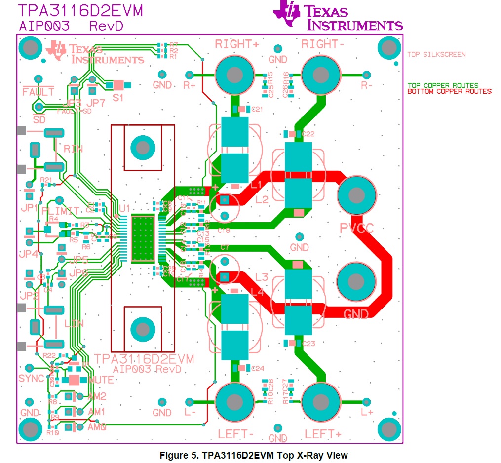

Here's the TPA3116D2EVM:
For ps it has:
CAP THRU ALUM-ELECT FC SERIES 220ufd 35V 20% 8x3.5x15mm ROHS
CAP SMD0603 CERM 0.1UFD 50V 10% X7R ROHS
CAP SMD0603 CERM 1000PFD 50V 5% COG ROHS
and see my ps reasoning here:
http://www.diyaudio.com/forums/class-d/267039-proper-tda3116-pcb-2.html#post4166799

I'll bang out a PCB design if anyone wants.
I concur on using the TPA3118 over the TPA3116. With good heatsinking to the ground plane, and good heatsinking of the PCB to a metal case (I use a Berquist gap-pad between the PCB and a Hammond box) the TPA3118 can happily put out 50Wrms x 2 into a 4 ohm resistive load without going into protection. I've tested and confirmed this myself with my Boominator amp.
4 layer PCB isn't really necessary, you can make a 3116/3118 layout with a pretty much solid ground plane if you want.
4 layer PCB for a 32 pin TSSOP and 20 or so external components? Well, if you have lots of money to throw around, then maybe...
You might be surprised at how much you can actually fit onto a dual layer board. It takes a bit more work than a 4 layer, but it can be done quite easily. Heck, people are doing 0.5mm pitch BGAs on 4 layer boards...

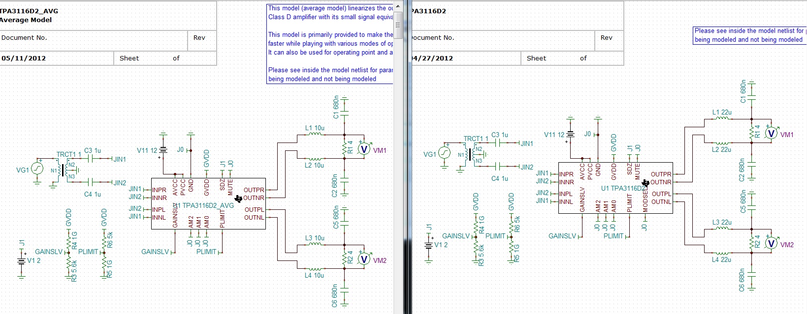

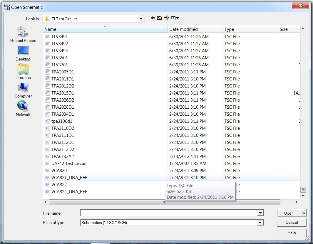

Holy crud, I was just reinstalling Ti's TINA after I switched to W7, and when I was downloading their 'examples' I spied ... TPA31xx!
Sweet! TPA31xx model!!!
http://www.ti.com/tool/tina-ti
You can model your exact x-over and drivers and choose components to max your ...
FR, dist, group dly, ... sim, sim, sim ...
SPICE-Based Analog Simulation Program - TINA-TI - TI Software Folder
Tina digi amps:
Bottom right, Open TI Examples --> TI Test Circuits --> ...
- Class D
- "Proper" TDA3116 PCB
