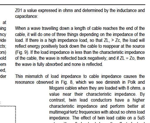

Dear Nelson: On page 4 of your 1980 Speaker Cable article is this paragraph:
"The explanation for this resonance is reasonably simple if we consider
that it takes a certain amount of time for the signal to travel down the
cable. A wave's velocity proportional to its "characteristic impedance,"
Z01 a value expressed in ohms and determined by the inductance and
capacitance:"
It seems there's a missing equation here? Because two paragraphs later it says:
"This mismatch of load impedance to cable impedance causes the
resonance observed in Fig. 8, which we see diminish in Polk and
Mogami cables when they are loaded with 8 ohms, a
value near their characteristic impedance. By
contrast, twin lead conductors have a higher
characteristic impedance and perform better at
multimegaHertz frequencies with about so [50?] ohms load
impedance."
Where does the 8 Ohm and 50 Ohm "characteristic impedance" come from, and how is it important? Should we aim to construct cables that match our nominal speaker impedance?
(I have been digesting this article for almost two decades, but never made it past this part...)

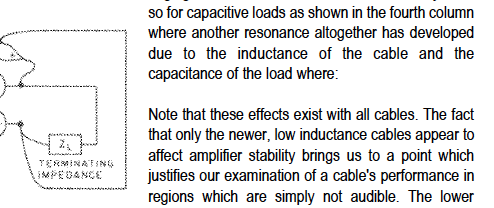

And then later on page 4:
"The effect of twin lead cable on a 5uS
pulse with an 8 ohm load shows the effect of a load
impedance lower than Zo, where the cable
inductance cable rolls off the edges of the pulse, but
where the 8 ohm resistance is sufficient to damp the
ringing which occurs with Z. = 0 or ZL = infinity . Not
so for capacitive loads as shown in the fourth column
where another resonance altogether has developed
due to the inductance of the cable and the
capacitance of the load where:"
There's something important missing here, too?

I think what you want to take away from that is if a cable is not terminated
in its "characteristic impedance" there will be a reflection back from the load
which becomes significant at very high frequencies.
These really aren't audio frequencies, but the effects can become quite
audible if the amplifier has very wide bandwidth and is capable of having its
frequency stability disrupted by this reflection. The solution for this is generally
to terminate the speaker end of the cable with an RC network as described
which dissipates some of the energy at a megaHertz and above.
You may recall that this was more of an issue around the time the article
was written when a number of wide-band high-feedback amplifiers were
behaving badly with a new breed of exotic power cables. I haven't seen
much of this lately.
And yes, little bits of the article did not get transcribed...
