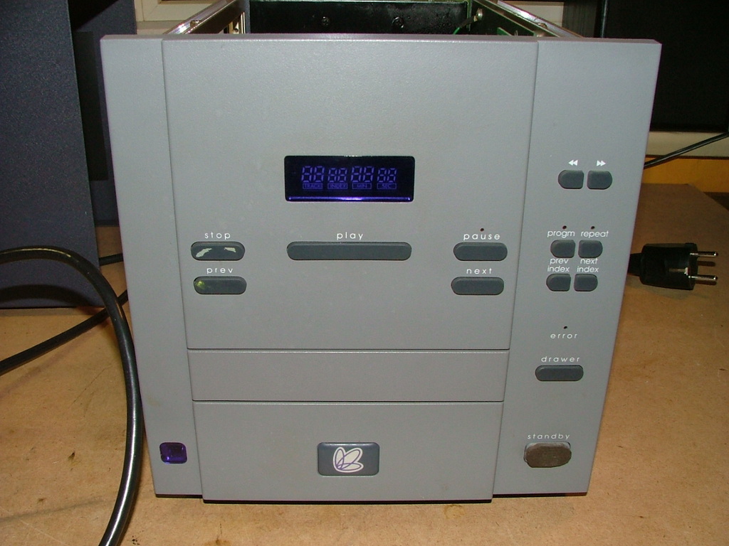

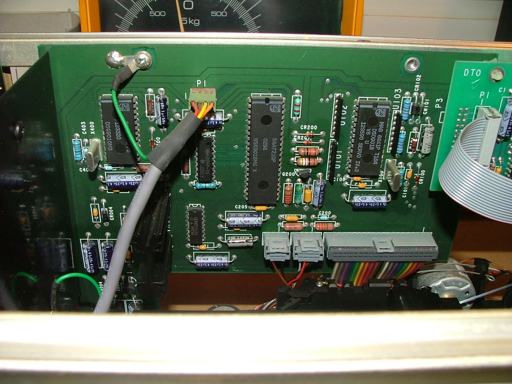

I got a Proceed PCD2 in mint condition. After I checked it plays well I could not resist taking the cover off. I love the built quality.
Now I am puzzled as I see two digital filters: SAA7220 and NPC5813 and also a digital input receiver chip YM3623. What is that one doing in an integrated CD-player?
The clock seems to be very cheap standard affair with the SAA7220.
Dispite that the sound is rather nice but bass is weak.
There are two DAC PCM58 and apparently AD845JN as IV-converter plus another one and LT1010 buffers.
Anyone can help me with this puzzle?

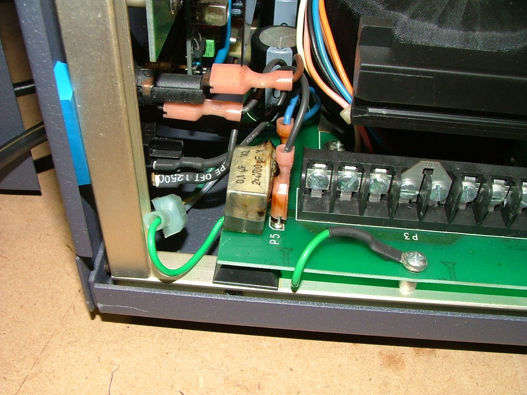

Thank you so much for the offer. I used to be service manager at a Levinson/Proceed dealer but since Harmon took over they will only work with their two service centers. I dove into the unit last night and confirmed my suspicions that the primary on the toroid power transformer is shorted. Sad! I also found a shorted bridge rectifier bypass capacitor. I bet someone replaced the rear panel fuse with a larger value and the shorted capacitor took out the transformer. I'm going to sniff around for the Holden & Fisher D1263A transformer. I may need the schematic for the voltages of the transformer windings.

Exactly this model comes to me for service for some months. Proceed don't release schematics, therefore I have created this one in "circuitmaker". because I have some macros of cd specific ICs, it was not extrem complicated.QSerraTico_Tico said:I got a Proceed PCD2 in mint condition. After I checked it plays well I could not resist taking the cover off. I love the built quality.
For me it was surprising that in an integrated CD player was built in a completely independent DA converter - that's the reason for this "puzzle". Very effective to fundamental enhance the sonic quality is a precision oscillator (jitter reduction), boosting S/PDIF out as well as MOSFET I/U converter of the Nelson Pass "D1"
I have found schematics, unfortunately not original. Only my own drawing (and some mistakes - so I think).

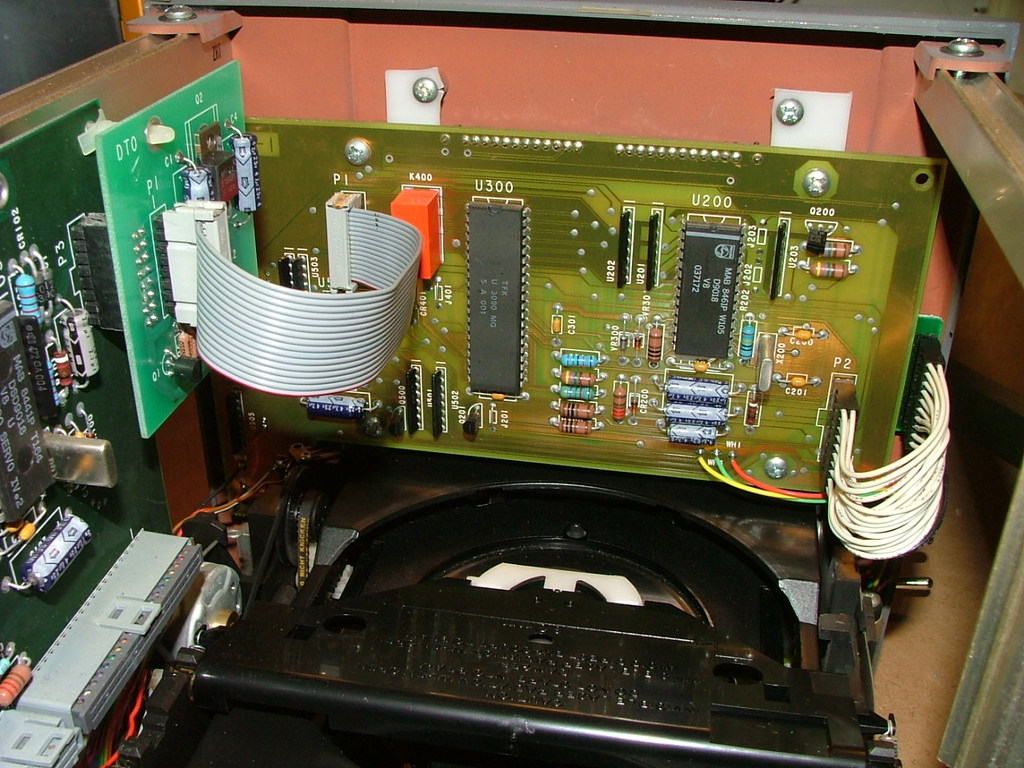

I am looking for the datasheet of U3090MG - go to

From ebay item No 180802251308 I have upload this high resolution pics.
Maybe very cost effective auction, because not complicated to repair.

The X-Y cap is burnt.
