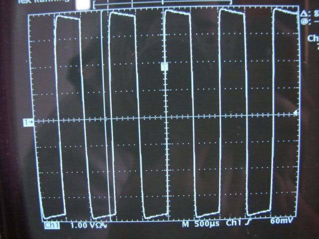

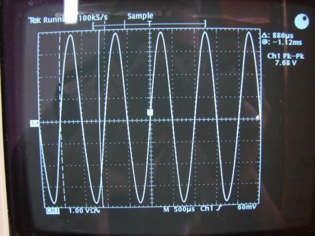

Response on the 4ohm speaker with 1Khz sine
1Khz square wave

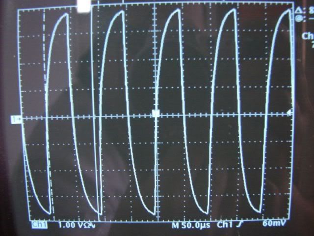

10KHz square wave, the rounding off is from the RC network on the input stage not the output stage

It does look pretty clean to me.. Richy what do you think?
Edit: Actually I noticed the scope is running at 100kS/Sec - so do you have access to a pure analog scope? Or can you select a much higher sampling rate? This low sampling rate may be misleading as RF oscillations probably can't be seen at all.
Worst case take a look at one single cycle at 1kHz or higher and continue to window in at progressively higher sample rates looking at progressively smaller parts of the sine wave across the entire cycle for HF content riding on your sine wave - note also that the amplitude may be much lower than the signal you are looking at. (Higher vertical gains may be used as long as you do not overload the vertical amplifier.)

Those waveforms look pretty typical, esp the lower with a heavy RC. I must confess that any HF would have been quite visible even with reduced scope b/w and quickly verified by measuring cathode currents.
Are we barking up the wrong tree ?

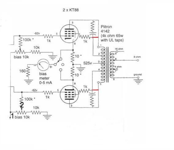

Here is the output stage in its current state
If I am not mistaken if i do decide to try out triode mode all I have to do is add the red wire ?
No, you need to remove the connections to pins 2 and 4 first before making the connections shown in red. As I noted I would also remove the zobel networks.

Can you show the schematic as it is now.
Does it still have the capacitor and resistor between the anode and grid? (Zobel networks). If it does take them out and see what happens!
