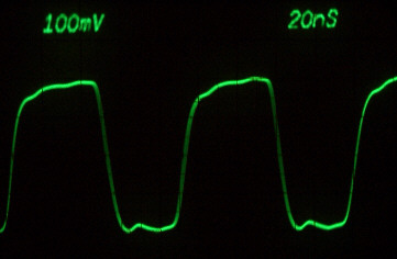

Re: to search or not to search.....
Really very similar. Doesn't look very good.
You can look at it like a very groundnoisy signal :-(
Andypairo said:Dosen't look that different..

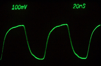

The SAA7220 is also happy with this adjustment.
Amplitude is smaller but still 0.5V reserve to trigger point.
When further decreasing amplitude, severe distortion and disc read failure occurs very suddenly.
I do not know how important is slew rate, but maybe a more smooth signal like this here gives less noise:

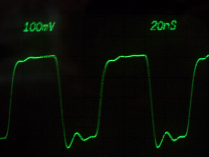

Bricolo,
The voltage pulse are not cause by the bead, it should be cause by the impedance of the decoupling cap, there are no voltage pulse before the bead because the bead blocks the high freq. noise, i can say the beads that you are using work very well.
what you need to do is parallel a small low ESR ecap to the 0.1uF.
Leo
Leo
The energy supply to the comparator are directly from the decoupling cap, not from the regulator, when the output of the comparator is 0V, it draws 6mA, when the output of the comparator is 5V, the current draw maybe increase to 1xmA, even 2xmA, if the energy store in the decoupling cap not enough to suply this current draw, a volatge drop will cause in the power line. you can't see any voltage pulse in the negative side since there are no netagive voltage output at the comparator, so the comparator keep a constant 6mA. i hope this will help you.
f.k.l.chan said:The energy supply to the comparator are directly from the decoupling cap, not from the regulator, when the output of the comparator is 0V, it draws 6mA, when the output of the comparator is 5V, the current draw maybe increase to 1xmA, even 2xmA, if the energy store in the decoupling cap not enough to suply this current draw, a volatge drop will cause in the power line. you can't see any voltage pulse in the negative side since there are no netagive voltage output at the comparator, so the comparator keep a constant 6mA. i hope this will help you.
Yes, this could explain some things.
You're right, the clock output is 0-5V. That's why there's not much current drawn from the neg supply, and no ripple on it.
I wonder why there's a neg supply for the comparator. But that's not the point here.
I'll try to add a cap.
The smallest I have here are some cheap 0.1uF film caps, 1uF wimas (there's already one in the KC, before the beads. Like in the schematic), and 15uF 25V FCs+
What will fit here?
Bernhard said:Is this normal ?
Output of my Kwak clock.
Probe is adjusted 1:10.

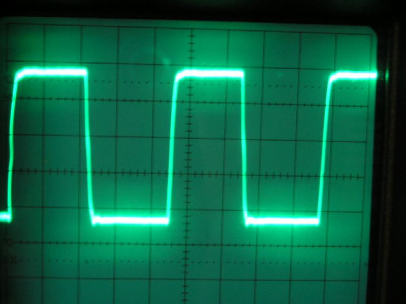

Hi
I wonder why these clocks loo so scary ?
Attached is one of my product range, same timebase (20ns/div)
cheers
