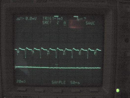

Again a comparison with 1541A nonos.
Upper graph SAA7220, lower graph Kwak clock.
SAA7220 is about 0,5 dB better ( I double checked ) for both distortion and noise.
Difference in distortion can be seen best on K3 which is close left of cursor.
Noise is shown in the readout on the top of the picture.
-68,3 for SAA7220.
-67,7 for Kwak clock.
K1 is equal (0,0dB).
-68,3 for SAA7220.

H,
distortion due to jitter is at a much deeper level, you are measuring something else
regards
Guido,
I honestly can not believe this.
Who said that I measure jitter ?
You are right, I measure something else:
The DAC @ -60dB signal level.
This is distortion caused by: TDA1541 + jitter + op amps + signal itself.
So if distortion looks exactly the same with to different clocks there are two possible conclusions:
1. Both clocks have same jitter. Very unlikely.
2. Jitter of the magnitude of SAA7220 is of no importance.

Bernhard said:So if distortion looks exactly the same with to different clocks there are two possible conclusions:

Hi
Spot on !
This is why I measure the spectrum of the jitter (this is not the RF spectrum !)
The ear is more sensitive for LF jitter
regards
