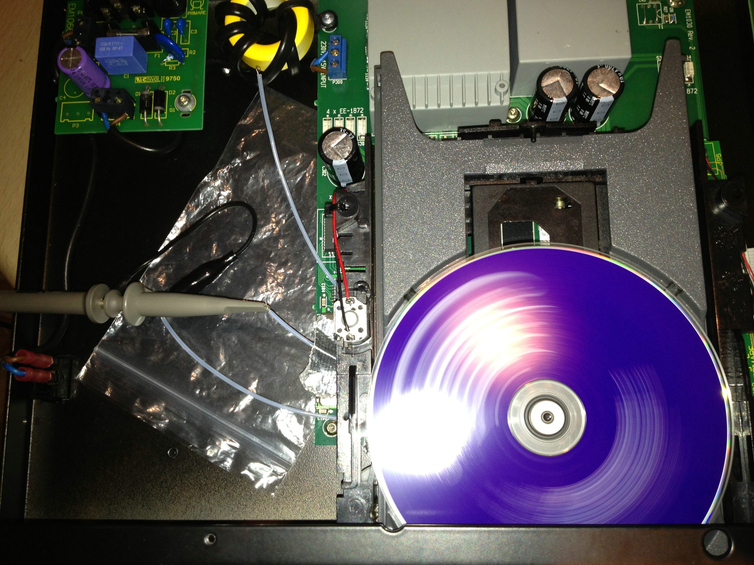

The measurement of approximately 1.5 volts pk to pk is as viewed on a scope. There's no other way to do it. If its difficult to access then you can solder a wire tag to connect the probe to.

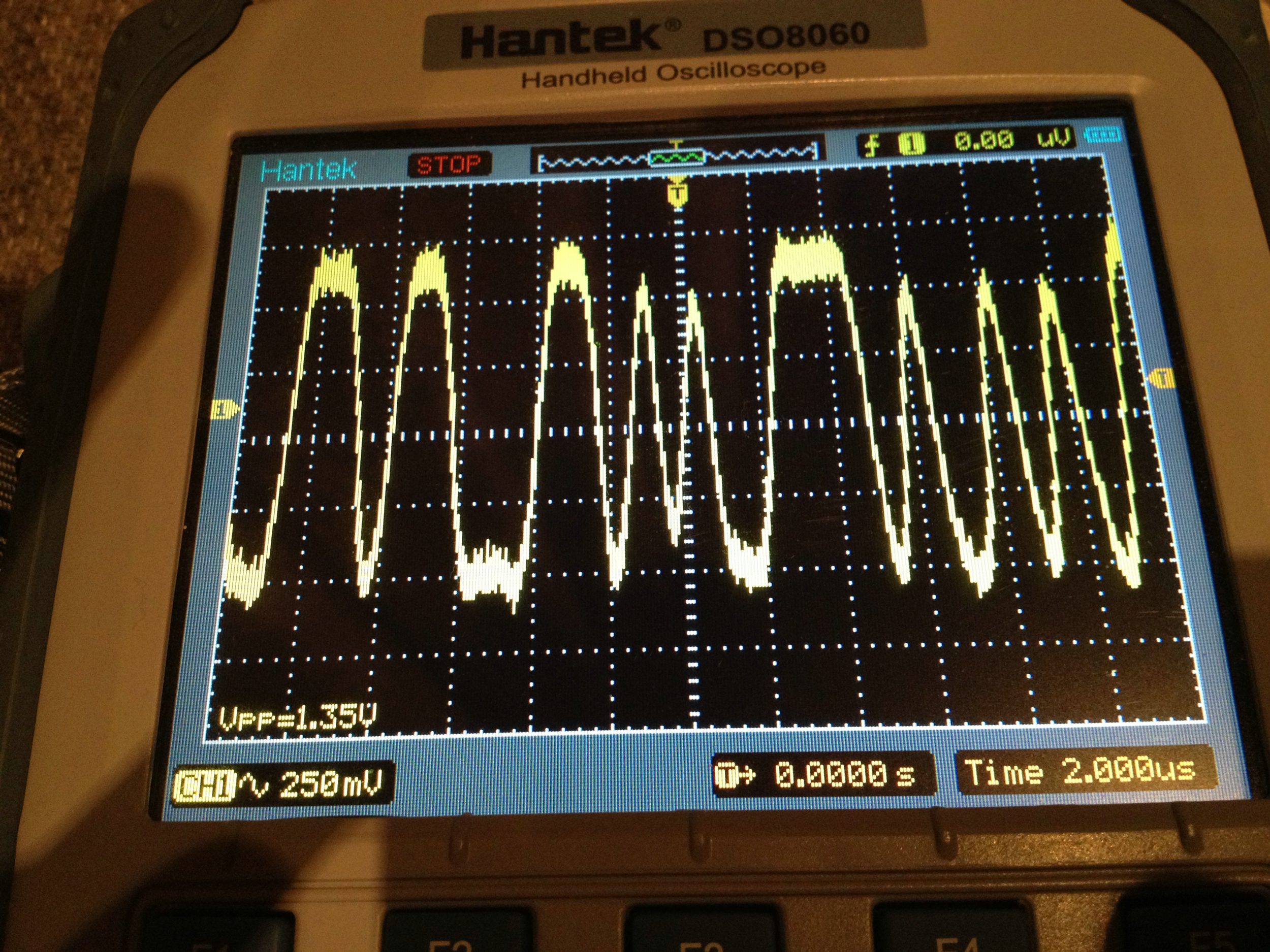

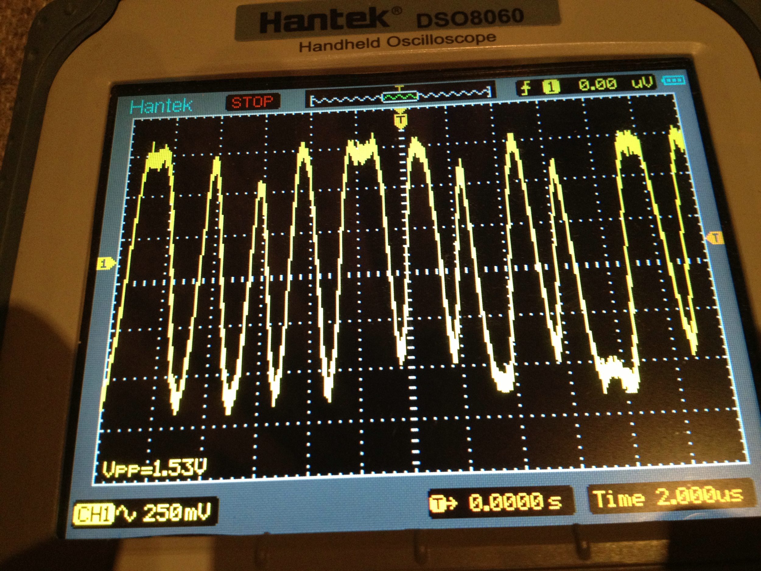

You would normally measure here (for example) on pin 8 of the SAA7345 (assuming thats what it uses)
Find the 2K2 resistor and clip the probe to that.
finally found some time and attached a wire to 8th pin of SAA7345 (1st three pics). The last pic is 9th pin of TDA1305 soldered to ribbon cable socket (was 10th before). I don't know, seems to me like same graphs as I uploaded above Moreover, when attached to SAA chip, pk 2 pk voltage is reduced by 10% roughly...

Also would be very delighted to correctly take pk 2 pk measurements as it seems i'm doing smth wrong...
It seems like the digital scope can't resolve the waveform, it shouldn't look like that If that's the case and I wouldn;t like to say whether the amplitude can be relied upon either.
The level decreasing when on the 2K2 resistor will be due to scope loading due to probe and cable capacitance. At high frequencies those effects become dominant. A divider probe (divide by 10) reduces that effect a lot.
