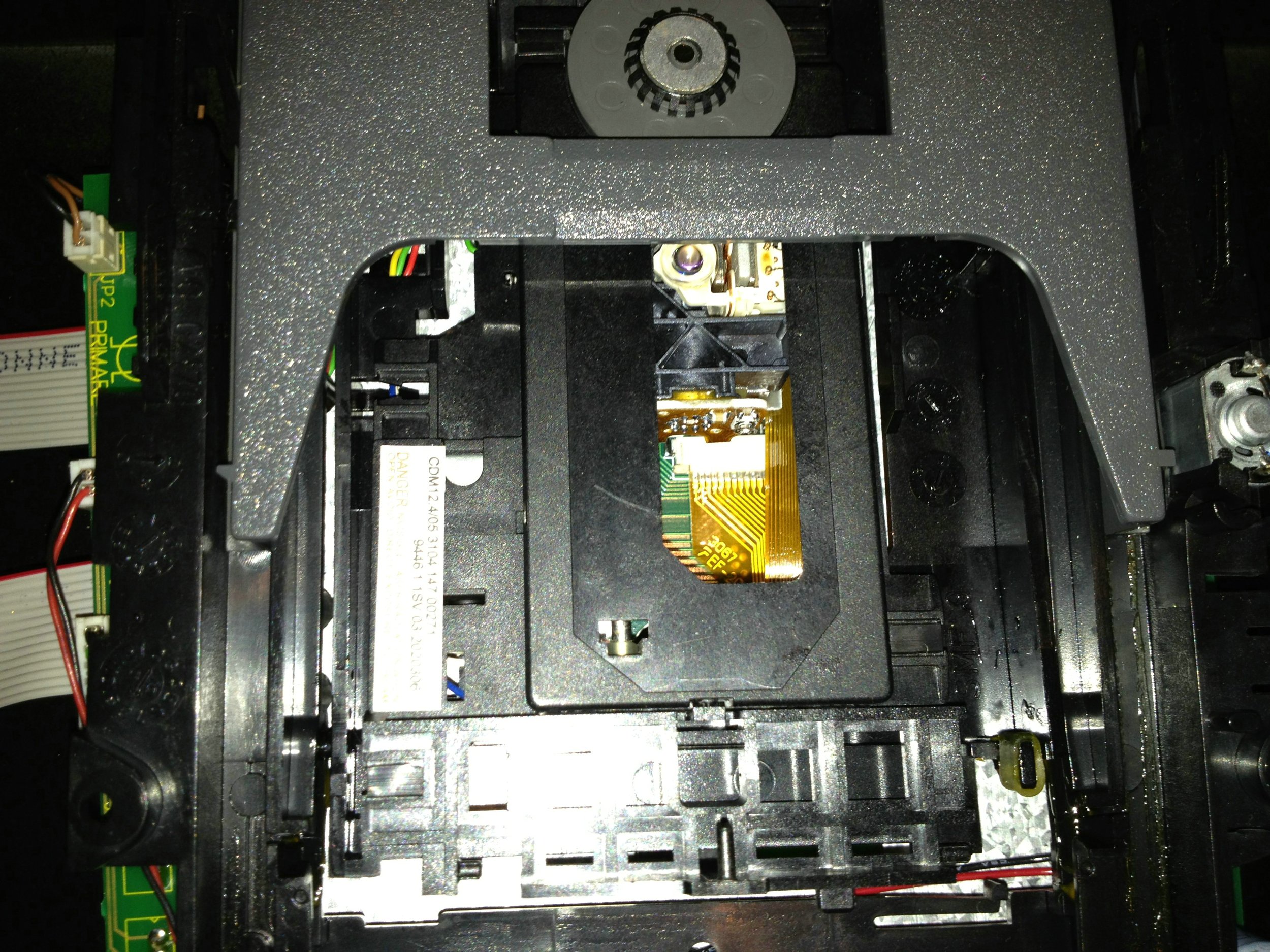

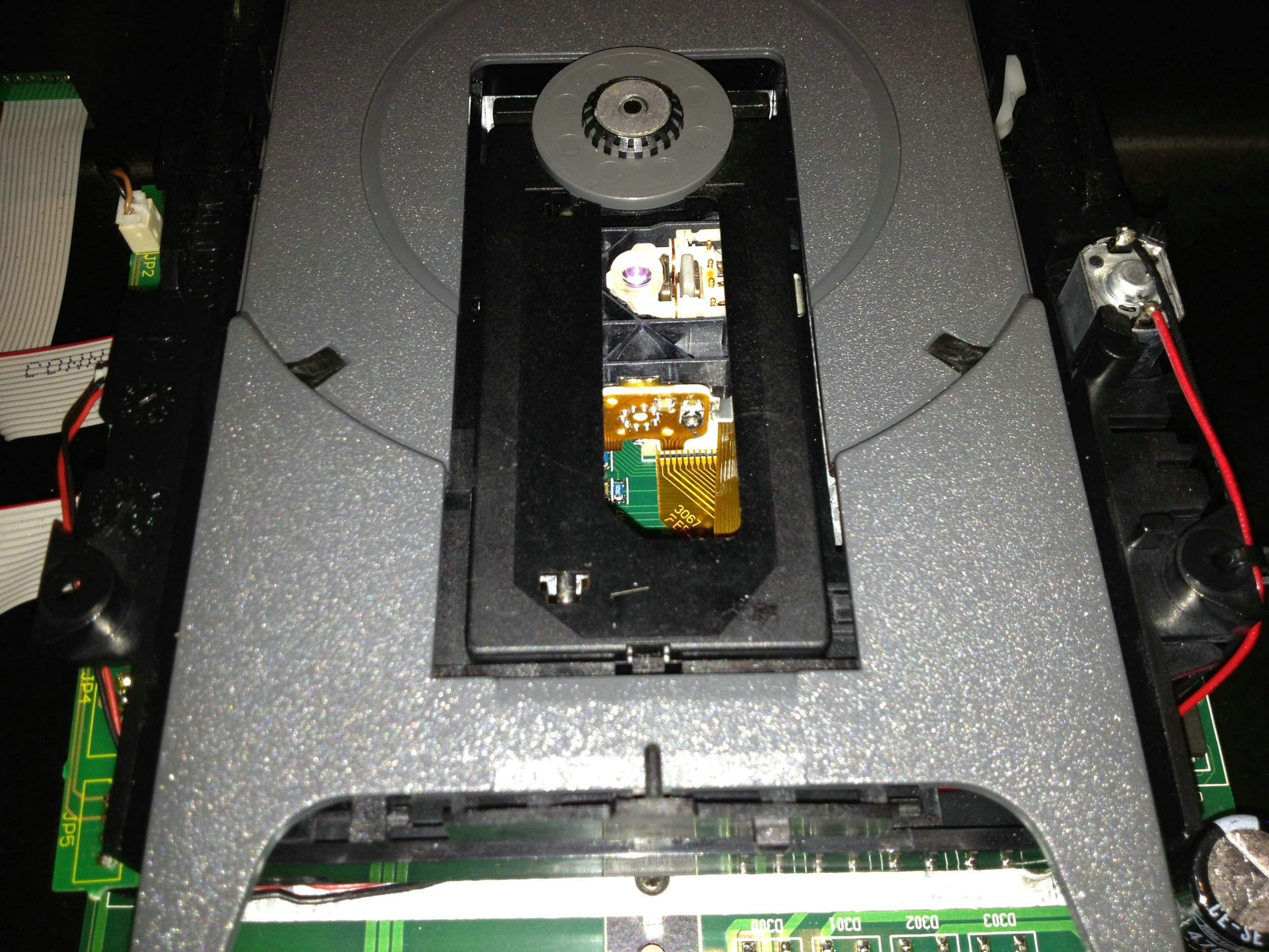

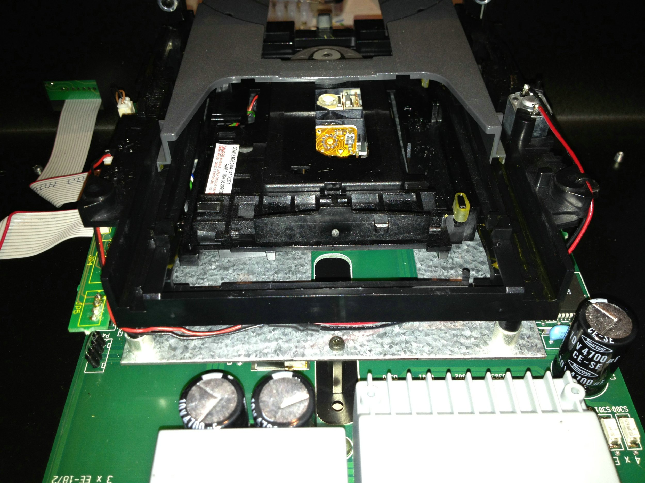

I have replaced the dead laser (there were no movements and motor didn't spin the CD) with CDM12.4/05 as should be and my Primare is alive:)
Everything is fine expect that 10% of CDs are skipping on one or two tracks, mostly in the first seconds. Some of them are quite scratchy and I could understand the issue, though others have little and barely noticeable marks, so that makes me feel puzzled.
The whole mechanism has been replaced very carefully and pot on the laser's head has been adjusted in similar position to the previous one. Is there something wrong with the laser itself or some other adjustments could be made?

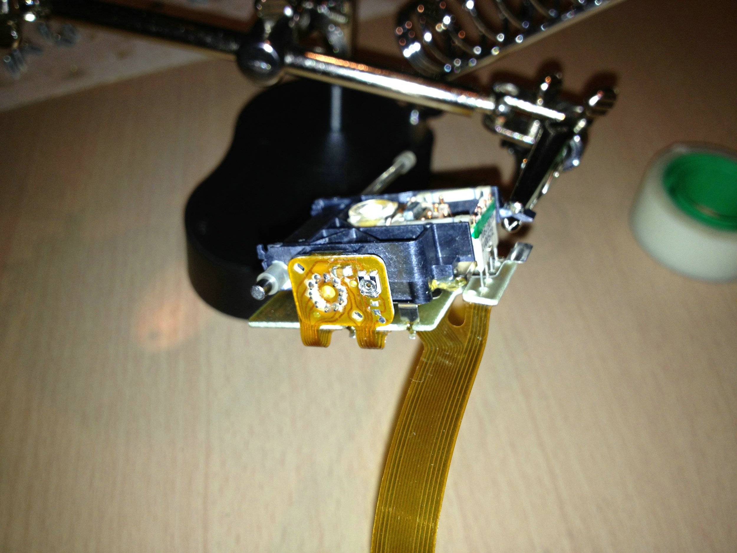

according to TDA1302 pinout, RF amplifier is 10th pin, however it's almost impossible to get to the ribbon cable and take the measurements. What I did is turned on the player without a CD and measured the pot (there are even soldered marks for that, so I supposed this is how it should be adjusted). I set the voltage to 0.92 vdc as on my other working VAM1205 laser on T+A :)
To be honest it skips almost the same tracks as previously when it was accidentally set by me in 1.05 position. However few tracks now are readable. That is a good point! I have also tried other adjustment positions in the range of 15-85% of the pot scale. The lowest voltage is about 0.55 and highest is 1.07 where laser is unable to read the CD.
So I guess it's the problem of the laser, probably it's not that good as original Philips lasers. :confused:

The measurement of approximately 1.5 volts pk to pk is as viewed on a scope. There's no other way to do it. If its difficult to access then you can solder a wire tag to connect the probe to.
It does sound like a suspect pickup. Even 6 years or so back I returned two CDM12.4's back to the supplier (I won't name them but they are one of the biggest suppliers to the repair trade). I was sent a boxed "Japanese" made CDM12.4 mech that was absolutely unbelievable in quality. The RF was amongst the cleanest I have seen. The other pickups looked and even smelled used and dirty.
No easy answer I'm afraid.

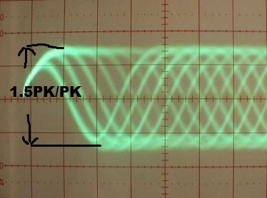

Yes, pin 15 but connect to the ground on the main PCB. There will be different "grounds" such as digital or signal. All are essentially the same but if you connect the scope to the wrong one the RF will look a bit noisier than it really is. To initially find the RF though you can just use the chassis ground for convenience.
It should look like this,
NDP 4 Quality Assurance
Thats a typical good quality signal. I would assume the scope is on 0.05V/Div and using a divide by 10 probe. So around 1.5 volts pk/pk.

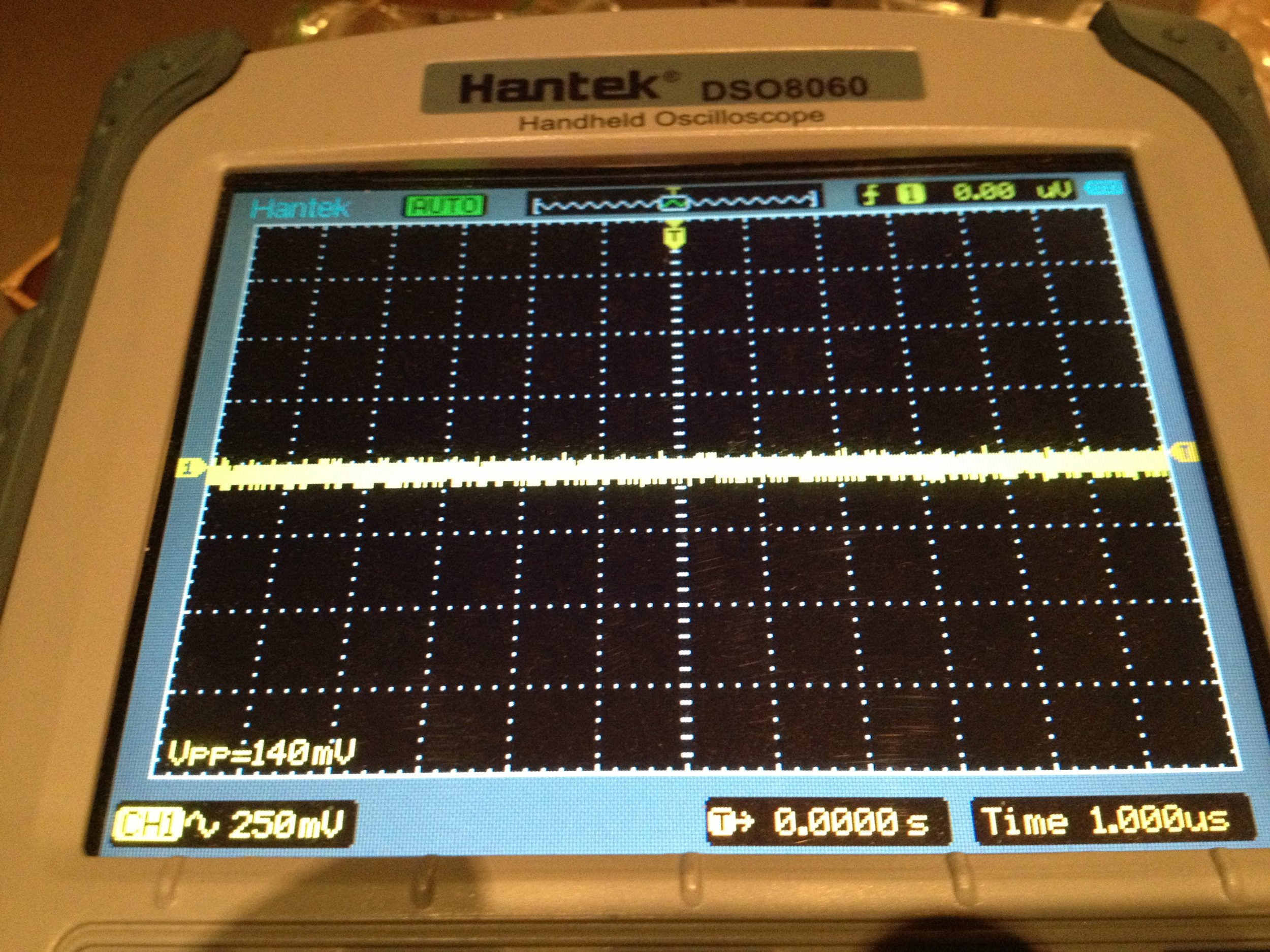

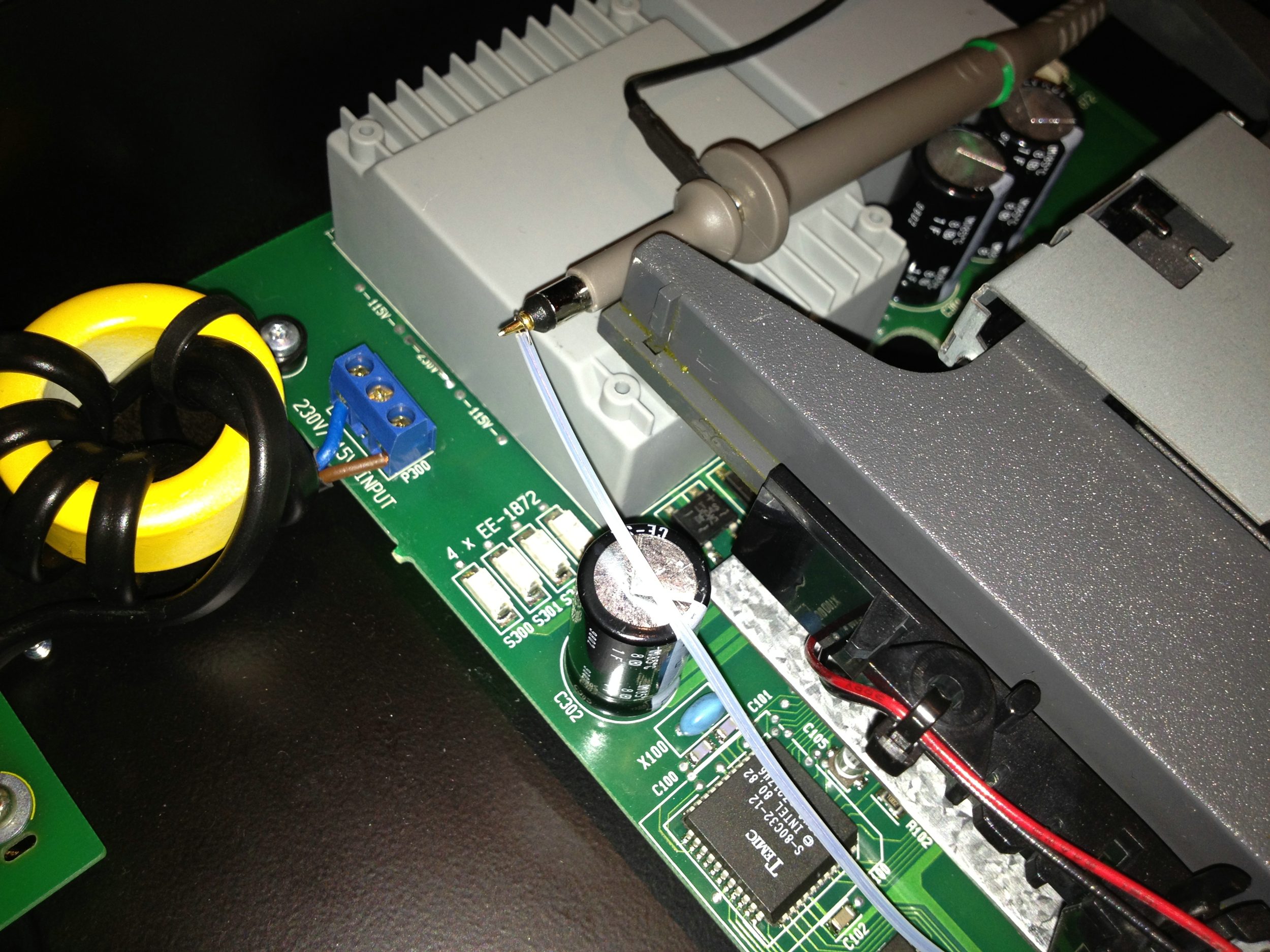

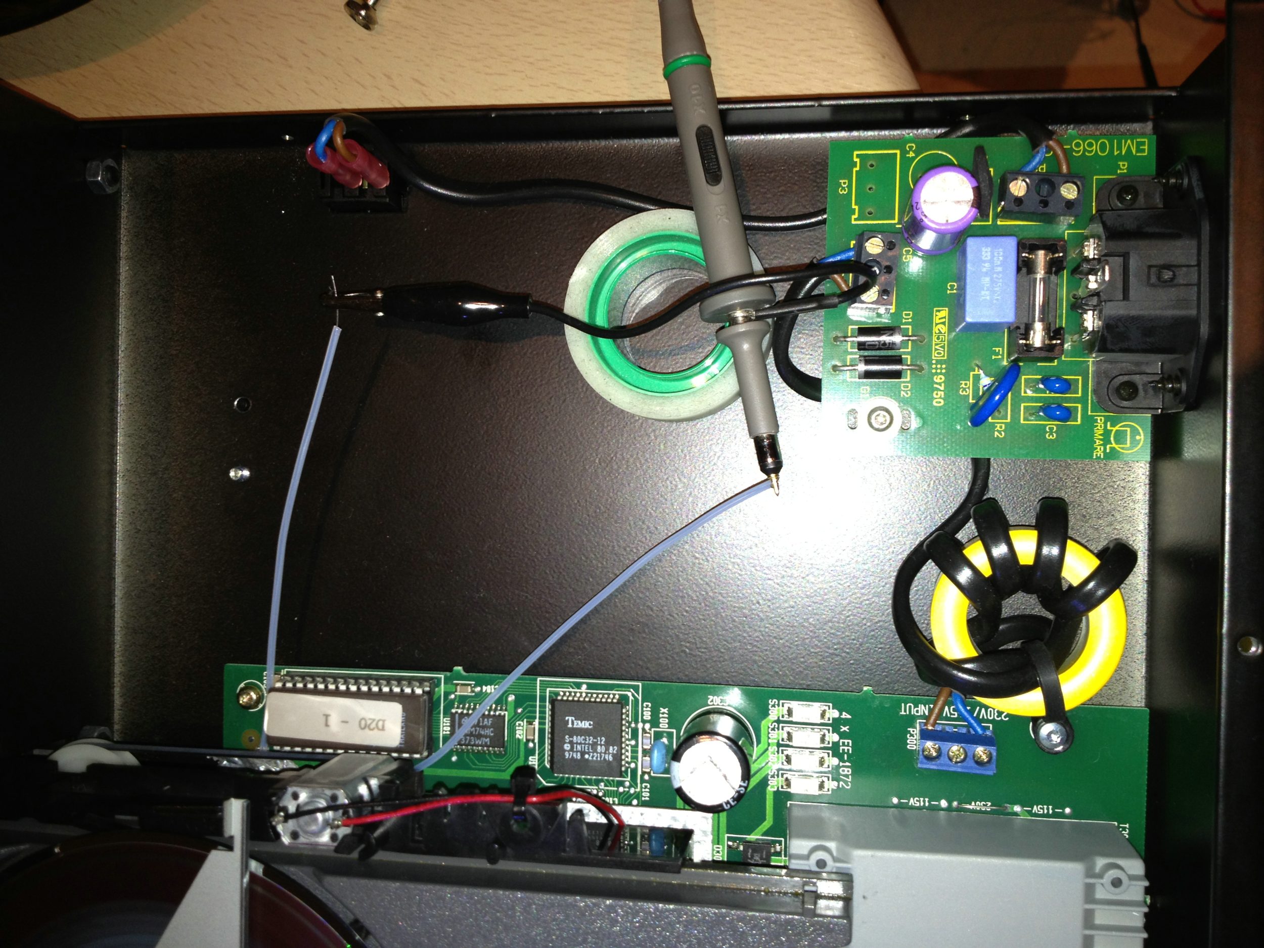

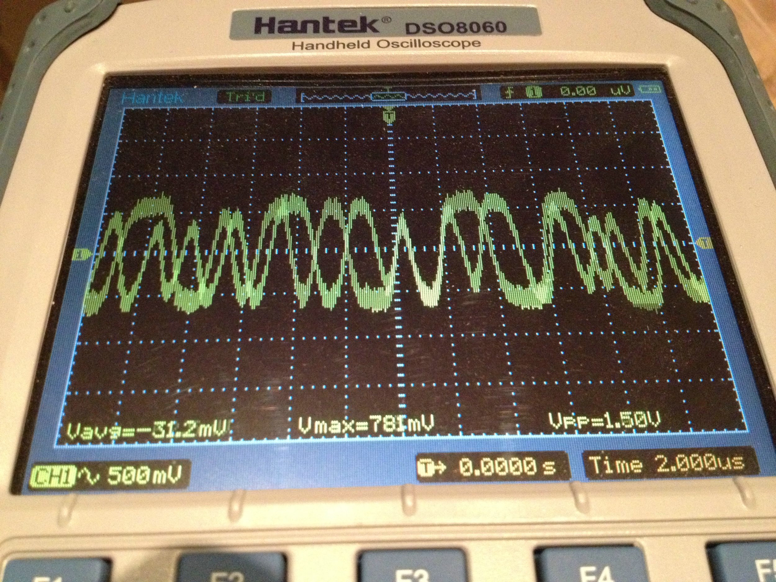

here are few pics I made. It seems to me that I got the wrong ground as the signal is quite noisy, though it's attached to the chasis bolt. Anyway I adjusted the pot to get roughly 1.50vdc on the scope (Vpp value changes very quickly from 1.42 to 1.60 according to the scope's build in functions). The probe is connected to soldered pure silver 0.3mm wire for hi-end audio measurement :D
It's working fine now, at least doesn't skip tracks that were fine before :)
thanks for new experience and your advices, Mooly:hohoho:
One last question to clarify, if I get a bit noisy signal, perhaps I should set the pk 2 pk value a bit higher, say some 1.55 average?
P.S. the coupling was set to AC on the scope, is that fine?

It doesn't look like it should :) Maybe its some artifacts of the digital scope and the complex waveform... can't say for sure.
It should be absolutely as like in the picture in the link in the post above.
Going to 1.55 v won't affect things unduly. The reason the signal seems to jump suddenly when the pot is turned is because the point at which laser action begins is sudden. As current increase through a laser diode it functions more like a side emitting LED until suddenly the lasing action occurs and then small changes in current show as dramatic changes in laser output. Thats why the laser current is tightly controlled in a closed loop system.
AC couplings fine. DC coupling just shows the signal sat on top of whatever DC bias is present.

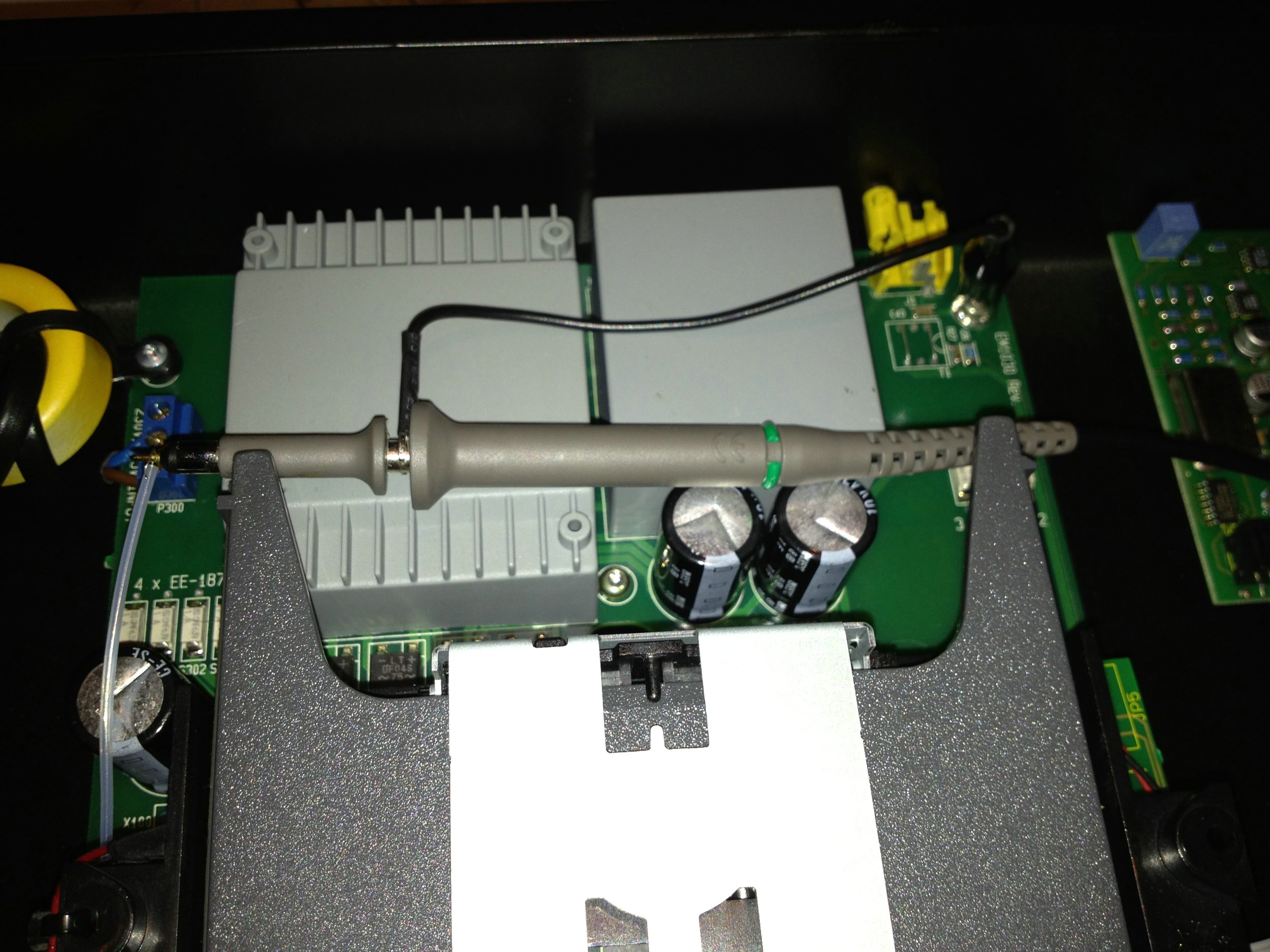

the wire till the probe is about 10cm. Transformers do not affect on the signal noise I assume as I've tried move the probe.
When I stop the CD I get a huge noise still - it's about 0.3v pk 2 pk, when I disconnect the mains, no noise appear on the scope, so I guess I need to play with the grounds. I'll try to solder another wire to 15th pin of the chip to check if that helps...
