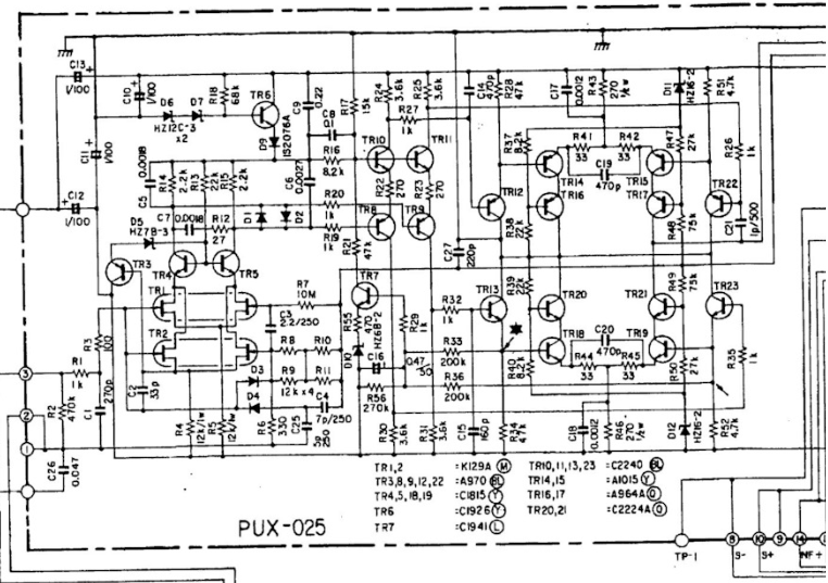

I'm just looking at the power amp schematic - thanks for sharing.
1. The Zobel is placed after the output coupling inductor and that's a pretty big no-no in Self and Cordell's books. You do run the risk of HF OPS oscillation with this type of scheme. By placing the Zobel after the output L, you are isolating the OPS from the Zobel. The Zobel is also not placed on the main amplifier PCB (where it should be to keep HF circulating current loops as small as possible), so any wiring L only exacerbates the problem.
2. The OPS is an EF3 if I'm reading the schematic correctly. These are prone to instability unless treated with care - again, Self and Cordell discuss this in-depth (see especially Cordell).
3. There are no values shown for the OP transistor base stoppers, so I assume they are linked out. Again, with an EF3, this is not recommended practice nowadays - typically you would use 2.2 - 10 Ohms. JC used 10 Ohms, I use 4.7 Ohms and both Self and Cordell discuss a range of values in their excellent books.
4. There is a base stopper network in the pre-driver transistors. Normally, you would place these base stoppers and associated base load capacitors in the base circuit of the driver devices. Cordell shows IIRC 10 Ohms with a 470 pF to the rail, but I have seen and used 22 Ohms and 470 pF. An isolation network consisting of 5.6-10 Ohms with a decoupling cap (20-50uF) to ground would be placed in the collectors of the pre-driver transistors. This latter newrok is to ensure there can be no coupling between the driver and pre-driver via the supply rail - see Cordell.
5. There are capacitors placed in parallel with the pre-driver base stoppers. Normally, you would not do this as it defeats the purpose of the base stoppers. What you want to do is dampen any oscillatory tendencies at HF with the resistors - the caps are bypassing them.
6. The VAS devices have 3p Miller caps that work in conjunction with 2 caps (can't quite make the value out) that go from the VAS collectors to the JFET device inverting input. You can use this type of compensation, but you have to be very careful about creating an HF zero formed by these caps and the gain setting resistor as this can cause HF gain peaking in the loop gain.

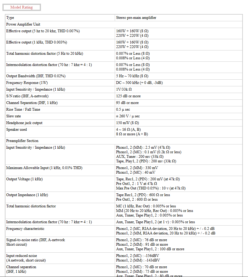

7. The slew rate is specified as 260V/us and rise/fall time of 0.5us. Given the vintage of this amp design and the obvious compensation design anomalies compared to modern designs, the alarm bells are ringing. The 1W 8 Ohm bandwidth is stated as 'DC~500 kHz' which opens the amp up to all sorts of RFI, and should it go into oscillation for whatever reason, these types of BW's don't help.
Since 1979, when this amp was launched, a lot of progress has been made in amp design regarding stability and compensation and its vintage in this respect is pretty evident looking at the schematic.
I suspect some of the things on this amp were done in the interest of prioritising distortion and slew rate over stability.
However, this is a beautiful-looking amp, so it deserves to be fixed/tweaked and take pride of place in someone's system!
I'd start by adding a 10 Ohm (5W) + 0.047uF (250VDC) Zobel on the amplifier side of the output coil (leave the original one in place). Place it on the main amplifier PCB, keep the leads short and return the 0V side of the Zobel to the 0V connection coming onto the PCB - don't run long connections back to the PSU 0V. The second thing I'd do is limit the input BW to 120-150 kHz. I can't read the component values (68o Ohms and 100 pF? If so, the -3 dB BW is 2.3 MHz) but 1k and 1nF would set the -3 dB BW to 160 kHz and clean things up IMV.
Specs:

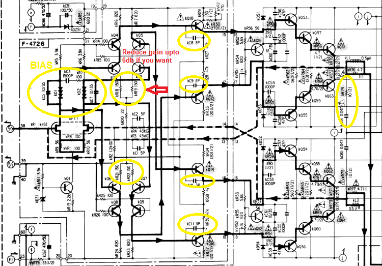

You have to be careful with that. What that does if chosen correctly (and after all other compensation design is completed), is get you a few degrees of extra phase margin. However, if you overcook it, you get loop gain peaking and you can cause problemsThe capacitor across feedback resistor (R38? 10k) is missing - usually something like 5...30 pF is found there.

Hi. This is a very good amplifier. I don't see how well it is assembled, but the design solutions are great. I bet a dozen virtual beers )) to that rare person who knows why the great Japanese used these diodes.
I believe the diodes form a Baker clamp: as TR13 approaches saturation, D05 diverts base current into the collector and prevents the transistor from saturating and "sticking". Makes for more graceful clipping behavior.
