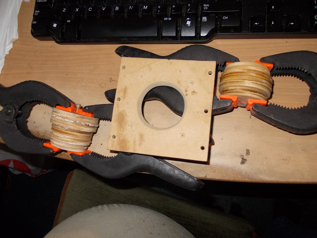

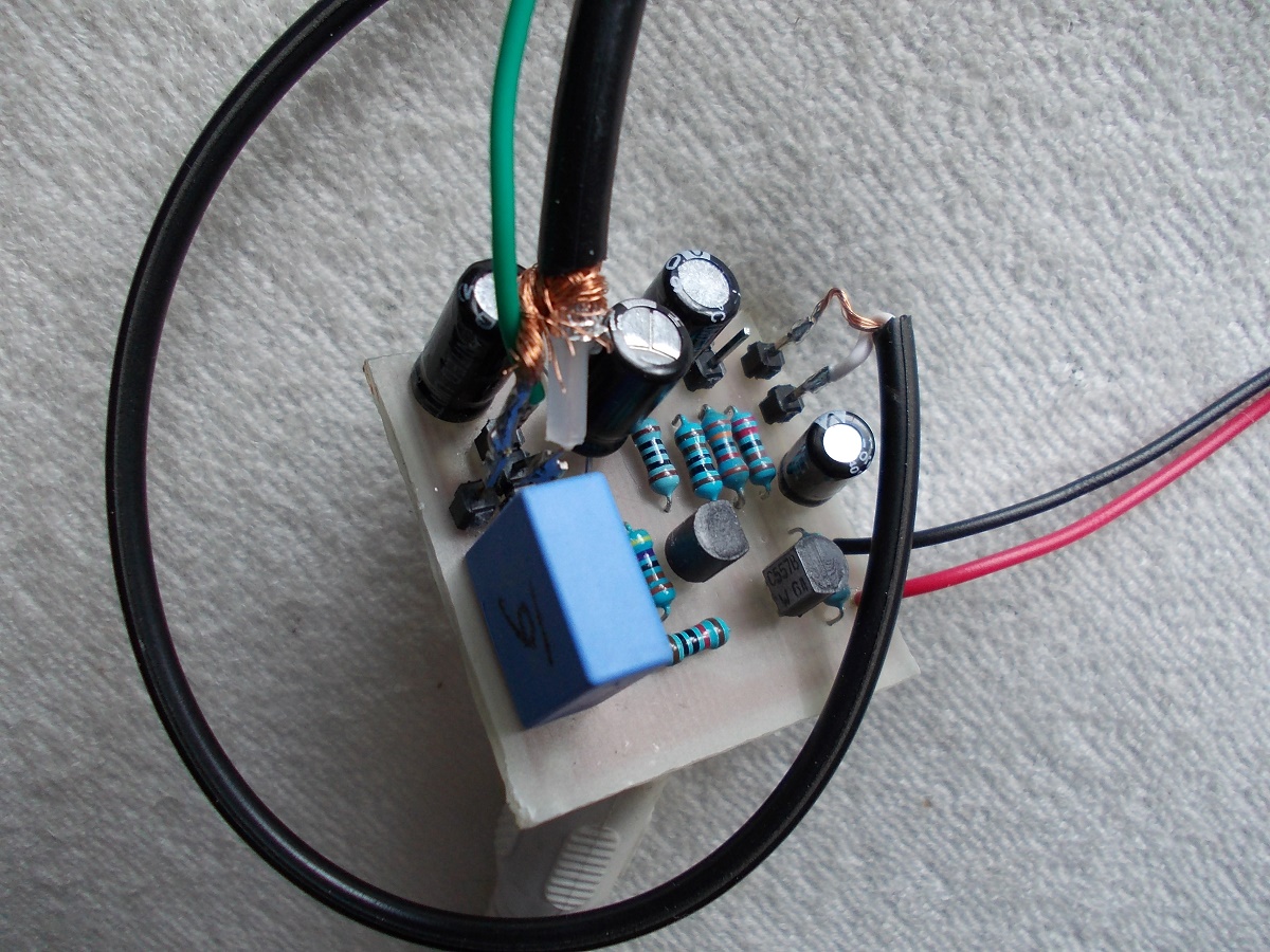

I have prepared now the mic amp and the faseplug, if lathe is ready then I give it a go.

I gonna make a faseplug al la compression driver, difficult but with patient like always is a matter in electronics I will succeed.

I have a wood lathe so will follow your phase plug closely kees.

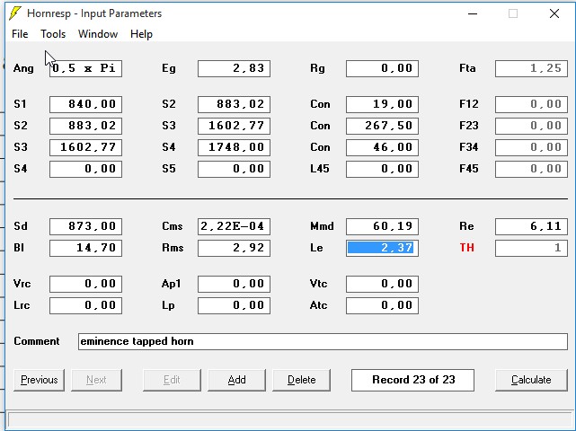

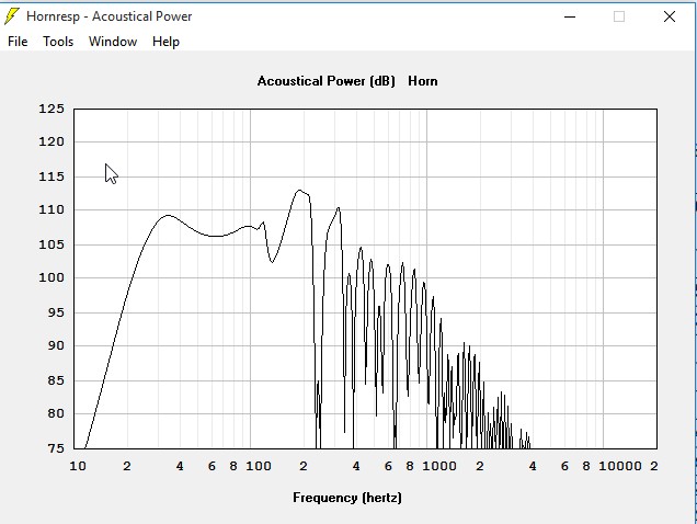

I am a little concerned that a driver like the Delta15LFA may not be well suited for a tapped horn. Its a paper cone on a pleated cloth roll surround with a pressed steel frame. I'll upload the spec sheet now.

Delta 15 has qts of 0.48 and i think some people has use them in a tapped horn, if you want go to 100 hz as a top you can not go as low as 20 hz.
I can try it in hornresp.

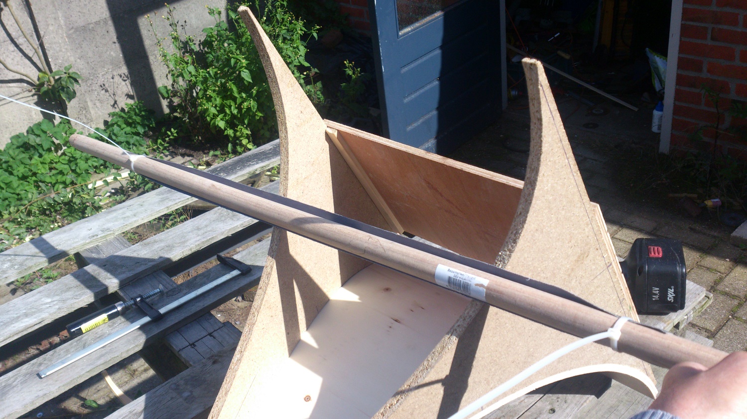

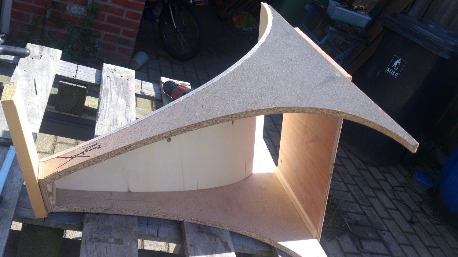

I have done it in sketchup and from there I did work on. I did use thin sheets gleued together for the flare with a mall.
Dit flatten the horn and print it for that purpose.
I have no plans so at hand because did it as a test first.
The eminence you use has to high qts, as a result the bump on 30 hz will nog go away except when make the box as big as your livingroom.

Some D15LFA Info
This Qts is too big for the Univ Classic - which likes strong motors and Qts below 0.4, and <0.3 if you can get it.
