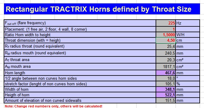

However, I did discover with the volvotreter tractrix calculator that I have calculated for free air, but I use the corners because most do of the wall, this makes the horn conciderable smaller if I see well, that will be good for HF extensions?.
Did you also see that? because yours is also calculated in free air, then I have to measure in free air.

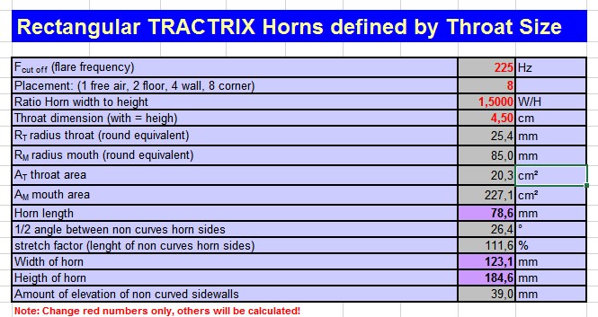

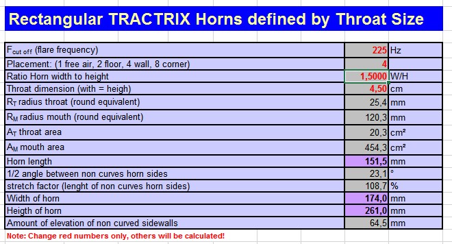

I put some pictures about the different places in home, like corner, wall and free space and see the differents, I do now that it is important how to calculate however I think I have not seen it.
work to do. Middle picture is I have build.

Yes I do now that but a smaller horn has also worked and better or high extension and if placed in corner
horn kan made smaller, that,s nice I did not see that in past.
akabak however do no show that, but I think small or bigger horn, the low pass effect of front chamber do all the trouble.

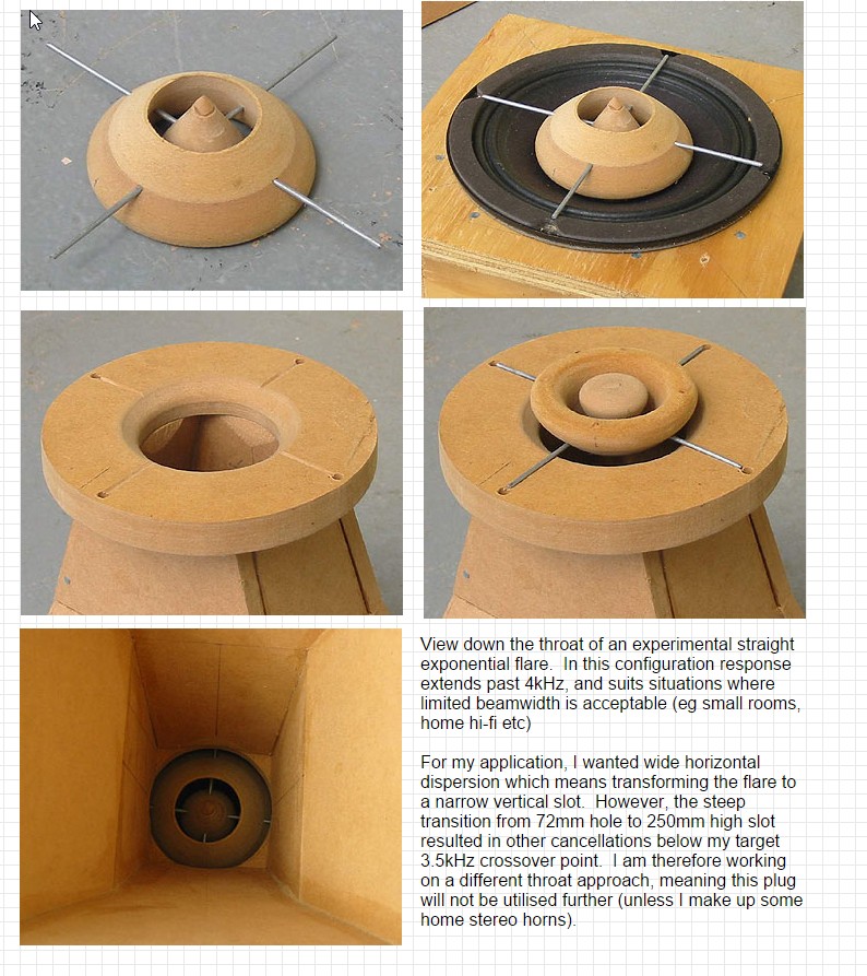

Would love to see photos of the phase plugs before you put them in next time.
I go use these, first make a print with plaster, then make it on the lath.
And test it, as I have read, a tractrix can go HF easely, I have also recalc the horn for wall, or corner, then it is a lot smaller and test it again, mucho work and learning.
