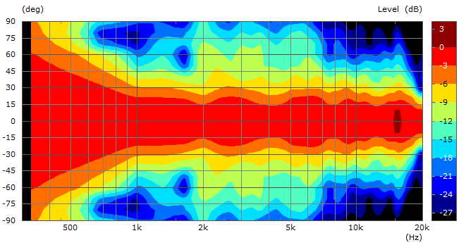

Regarding horns, I have yet to see mention of a horn that actually significantly impacts the first vertical reflection (from the floor). I have seen mention of placing the horn on the floor, but I suspect that sounds like it's on the floor, which doesn't appeal to me. (Correct me if I'm misinterpreting here. I don't know who is who, nor who has what variants of speakers at home.). There has been some discussion as to why horns usually don't have sufficient vertical directivity to attenuate the floor reflection (they would get very wide).
Regarding steering a null at the floor (and ceiling) if you look at the polar response image I attached to post 32, you will see that the null is carried across a very wide frequency range.
So in short, horn speakers (typically) don't significantly reduce the first vertical reflections, nor do traditional multi-way speakers, nor do the eXpanding arrays that have been implemented so far. But the approach I've detailed appears to have merit to accomplish exactly that, across a wide bandwidth in the middle of the audible frequency range.

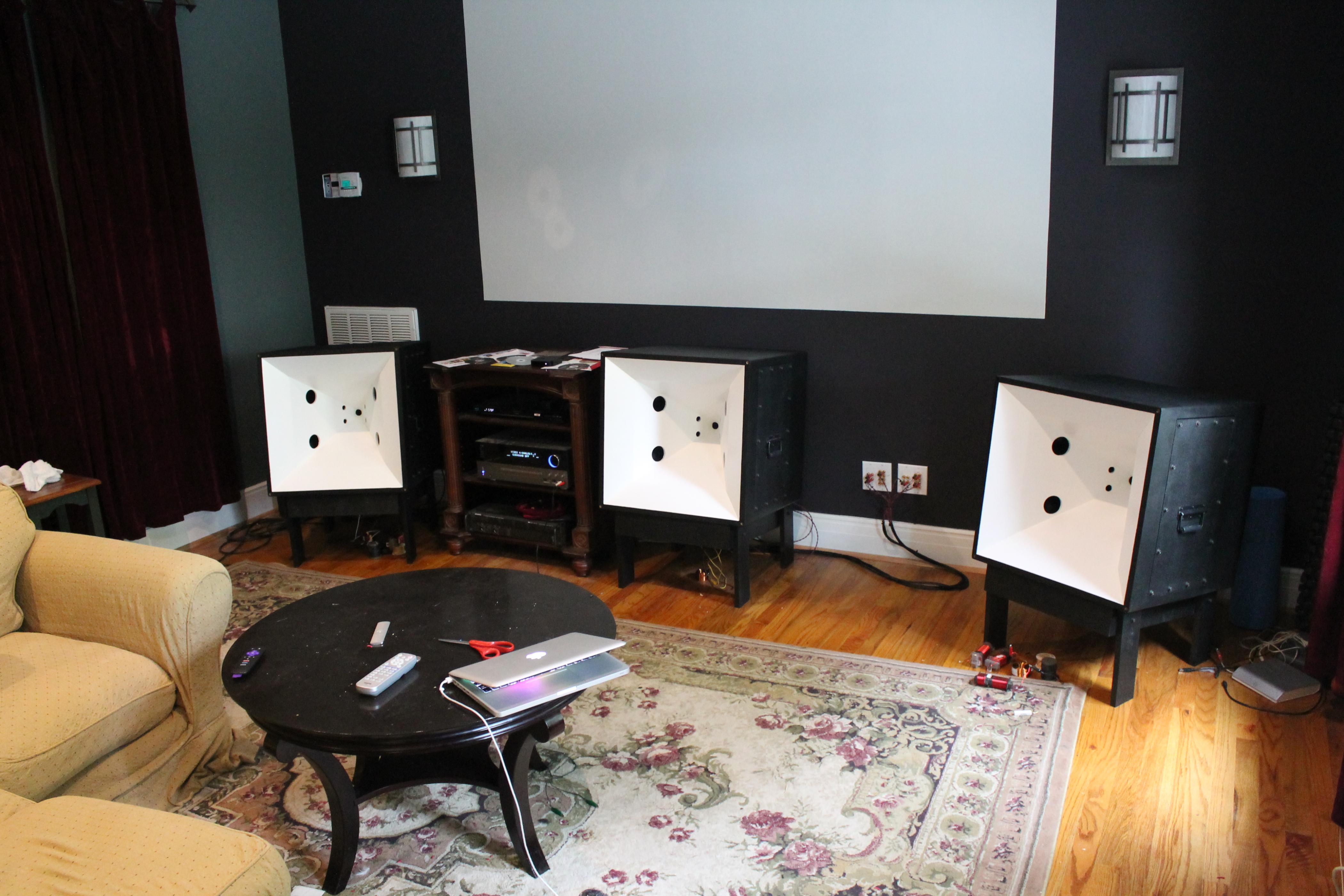

In a Synergy design, within the basic limits achievable with a quadratic or conical horn flare coverage angle you choose your horizontal and vertical angles and point them where you want to put sound.
It's that simple.
Practically you'll want to stay within 1.5:1 or at MOST 2:1 between horizontal and vertical (or vertical to horizontal) and tap into the horn at the spots most beneficial for the driver. Keep the crossover points within 1/4 wavelength and the maximum distance between injection points within 1/4 wavelength and don't screw it up in the crossover: you'll have the ability to place a unified single wavefront controlled directivity wavefront that won't diverge as it travels to your listening position.
Let me state that again: A single wavefront that won't diverge.
In a normal non-coincident speaker the wavefront from each driver meets and sums to some level of correctness that varies by position and distance.
In a Synergy horn...they don't diverge. They are blended in the horn and propagate as a single unit towards the listener. (That's one of the reasons to call the predecessor horn the Unity Horn.)

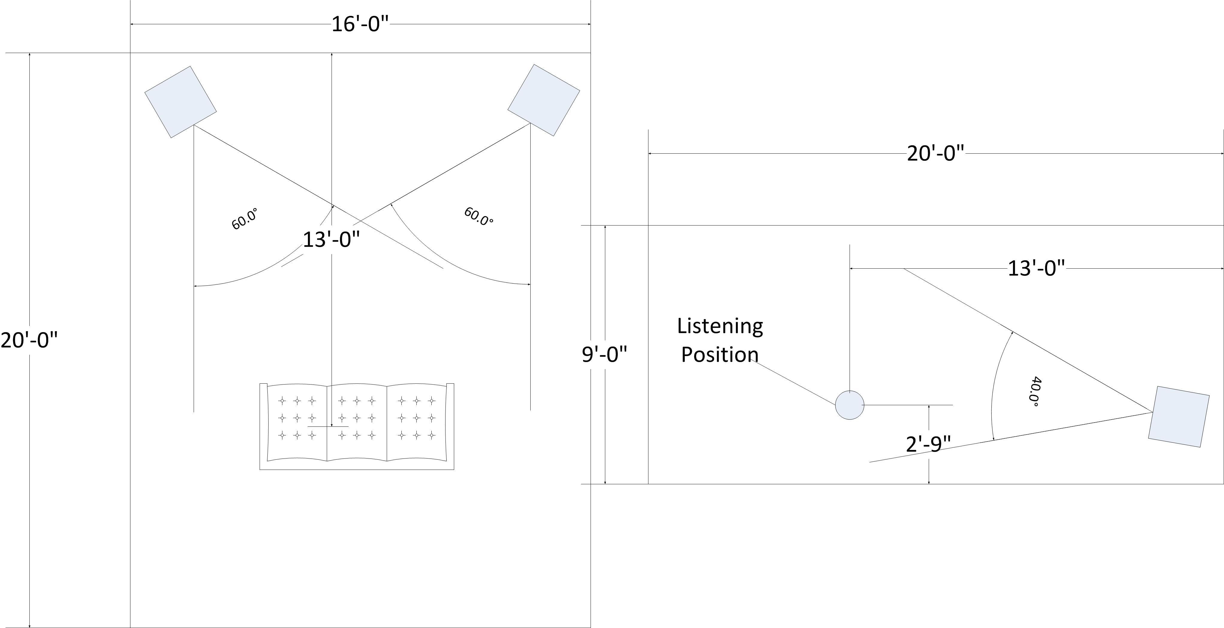

I've attached a simple sketch of a 20' deep, 16' wide, 9' tall listening room. Listening distance is 13' from the back wall, listening height is 33" The Synergy Horns in the diagram are represented by the light blue boxes. They have coverage of 40V x 60H. Tilting the horns up 10 degrees and placing the apex of the throat at ~30 inches. Each horn is tilted in towards the center of the room 30 degrees.
Not one primary reflection, floor, ceiling, or sidewall will reach the listeners seated on an average 3 seat couch 13' from the back wall.
In addition you get the benefits of being able (if designed correctly) of being able to reproduce a square wave with pretty good fidelity (for a speaker) over a region of the speakers bandwidth.
You also get the ability to use lower cost drivers because the injection ports along the length of the horn serve as lowpass filters reducing the distortion. I have used $.75 2" drivers in speakers that will hit 105-110dB peaks at a listening position 10 feet away as midranges, and kept THD under 2%.
In my application the horns are lower to the ground than I would like, but it's not that objectionable. I did that to keep them from visually blocking the movie screen.
It took me almost 20 years to catch on to what was going on inside a Synergy/Unity. I'm sure there's some subtle bits I haven't discovered yet. You have to build a few to realize what's really happening with the injection point/throat reflections, injection air mass/reactance, phase rotation...etc.... but once you do....it'll be hard to think of speakers the same way.

The directivity of the main lobe in post 32 is pretty nice, but the strength of the many 'parasitic' lobes.... not so much. Doesn't that sound sort of like a flutter echo? Or are the reflections from those narrow enough or late enough to not be a problem?
I agree about the vertical control being a problem with most horn speakers in general, though. In my (very challenged, 7 foot ceiling, basement) listening room, I have the ceiling stuffed between beams with deep absorbent, which works better than I would have expected. No idea how much better it might sound if the reflection control were more complete, though.
I have a revised Synergy horn planned that better addresses vertical control (vertical control is partly a function of horn height and narrow tall speakers are usually practical in a room). The issue (for a Synergy with linear phase pretentions) is to keep the z (depth) position of all the drivers constant. I want to try by having the horn depth be different for horizontal and vertical.

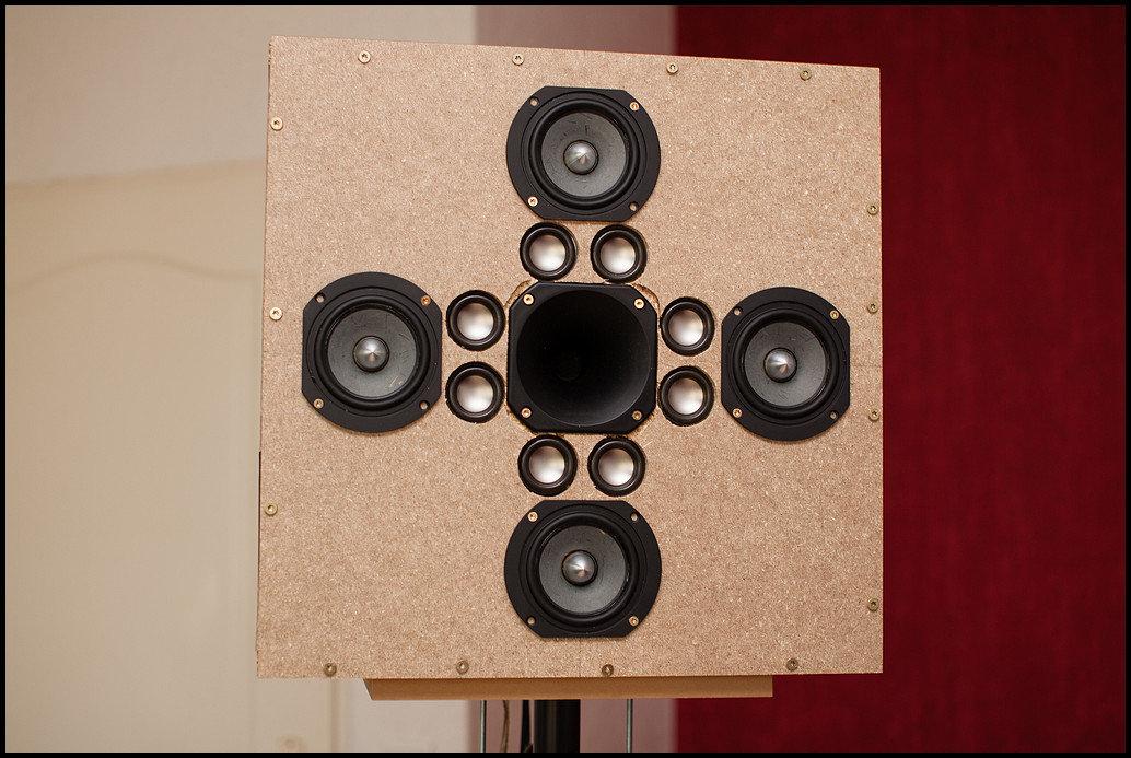

Horbach and Keele developed filters which shape the vertical directivity of a multi-way speaker. The drivers must be aligned pairwise with special distance to the midpoint. It works well with 4 ways. I'm working on a 2D version of this concept and it is very promising.
The only problem is the tweeter which is alone and doesn't come in a pair. To get a nearly constant directivity it must be horn loaded. But this horn can be pretty small (I use 12 cm diameter).
The filters must be linear phase which means FIR. But with RePhase and a MiniSharc or BruteFIR the costs are rather low.
Here is my prototype I'm working on. The 4th way (bass) is not implemented yet and will only be vertically paired to save width. :)
attachment.php
attachment.php
With this concept you get a speaker with narrow directivity in both directions without using big horns. The enclosure can be flat and there are no big problems with horn resonances. It even works very good in nearfield, because of the coax design. SPL is high and distortion is low, because of the high number of drivers. Of course this is also a drawback. The speaker will not be cheap.

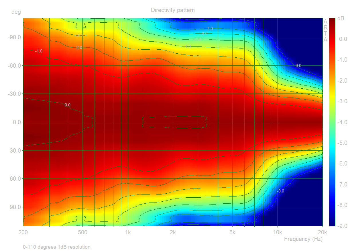

Simulation of 4-way WWMmmTMWW. Drivers are 1", 2x4", 2x6.5" and 4x10". X/O is common phase aligned IR as you can see. Off-axis responses are simulated by piston radius and baffle diffraction.
DI in vertical plane only (right scale).
This works just fine when properly designed.
It works ok, but there are still problems to solve. Vertically the tweeter is always a problem, because its dispersion is very wide in its lower range. The vertical DI shows this as a 5 dB drop between 4 - 12 kHz.
Above that the tweeter's dispersion is very narrow. The overall DI shows this behaviour. DI is going up 7,5 dB from 10 kHz to 20 kHz.
A small horn solves both problems.
