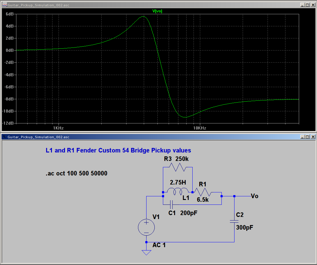

Looking at this, I also couldn't make any sense of what I was seeing, in terms of being able to correlate it with what I thought I was hearing. Adding the usual 10-foot (roughly 3 metres) cable I usually use changed the frequency response substantially, and now there was a peak at a frequency that would actually make it through a guitar amp and guitar speaker.
I no longer have my old measurement data, unfortunately. But, for the purpose of discussion, and maybe to stimulate some ideas, here is an LTSpice simulation I did recently.
For the simulation, inductance and resistance values for the pickup were taken from a table of measurements I found somewhere on the Internet. The self-capacitance and cable capacitance values are just my guesses.
Whether or not those values are accurate, the simulation shows some general features of interest: the pickup acts as a low-pass filter, with some peaking on resonance, and a roughly 12 dB/octave (2nd order) rolloff above it.
Both measurement methods we've been discussing on this thread multiply the curve in the LTSpice simulation by frequency (voltage output is proportional to dphi/dt, where phi is the magnetic flux, and for a sinusoidal change, d/dt is proportional to frequency). This is equivalent to tilting the whole LTSpice plot counter-clockwise, multiplying it by a rising +6dB/octave response.
The test-coil measurement method could be modified to generate (hypothetically) the same curve as the LTSpice simulation, if the constant current coil drive were replaced by a current falling at 6 dB/octave. This could be done by using constant current drive from the output of an integrator, for instance.
The same thing could be done mathematically too, by simply dividing each data point by its corresponding frequency.
It would be interesting to see if the measured data in any way matches up to the simulation, which is based on electrically modelling a guitar pickup as an inductance, series resistance, and parallel winding capacitance.

I'm simulating what the pickup coil actually does in a guitar, not the measurement method you're using.Your simulation is wrong.
Replace the voltage source by a piece of wire and feed a current source into the pu.
When a coil is exposed to a fluctuating magnetic field, a tiny voltage is induced in every tiny length of wire in the coil, adding up to a much bigger voltage across the two ends of the coil. (The relevant Maxwell's equations being: curl of E = - dB/dt).
This simulation should show the frequency response of the voltage generated by a pickup in response to a fluctuating AC magnetic field with, with dB/dt having a constant magnitude. That in turn is equivalent to a sinusoidal string vibration, with an amplitude falling linearly with frequency (- 6 dB/octave).
I am not sure if that last part is the proper frequency dependence or not, but anyone who has played a stringed instrument will have noticed that the bass strings vibrate through a much larger amplitude than the treble ones. We know that in reality the amplitude does fall with frequency, but I'm not sure if this is a -6 dB/octave rate or not.
(If all strings were equally thick, I think the amplitude would fall at -12 dB/octave - just look at the formula for total energy of a harmonic oscillator, which is proportional to the square of the amplitude. A constant energy input (pick stroke) should therefore result in an a vibrating amplitude that falls as the square of frequency. However, we don't use equally thick strings for the entire piano - and putting equal energy into a thinner string involves a larger amplitude of vibration. I think the use of progressively thinner strings has the effect of causing vibration amplitude (for a given picking impulse) to fall at -6 dB/octave.)
-Gnobuddy
