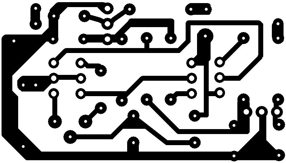

juma-- just ordered the parts to build 3 of the preamps for the F5--i took one of my F5's to a friends house to use with his epos speakers and with a passive preamp the F5 didn't have enough gain--would you have a pic of the underside of your board to help me with the layout??? thanks mark
This layout?
(bottom side view)
Re: PC board layout.
increek22 said:
Hello Stein2, any chance you have an image of this board without components showing copper only? CAD files?
thanks, Joe

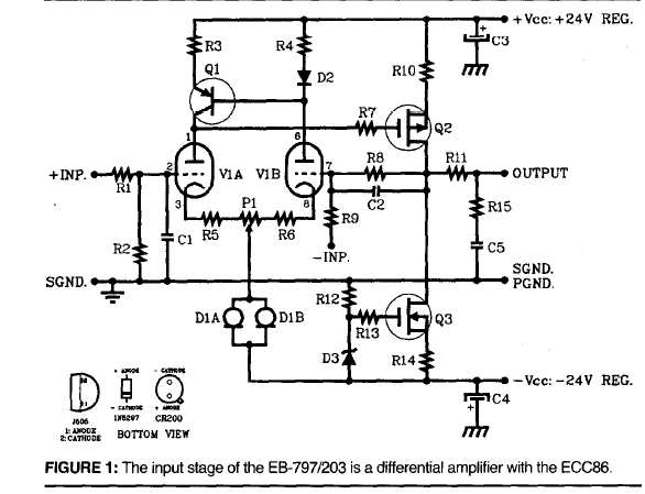

That layout is Juma's, borrowed from our local forum. I'm about to start working on my preamps, one of them being a simpler one... and one designed by Borbely with ECC86... I guess Juma will see this and act upon request.

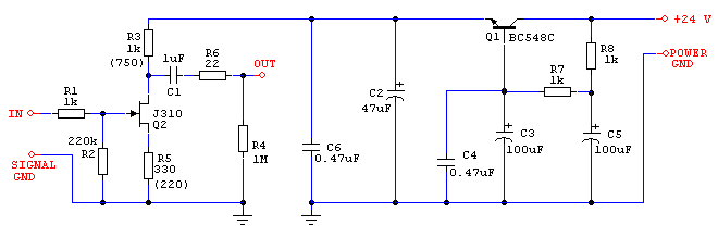

F5 has a very high Zin (101k) so it doesn't need high current drive i.e. EF (Q5,Q6). Without EF Vbe multiplier(Q7) makes no sense so we will lose it too. What is left is schematic from post #53 of this thread (which has higher Id through JFETs in order to avoid that grainy sound that makes some people to hate JFETs).
