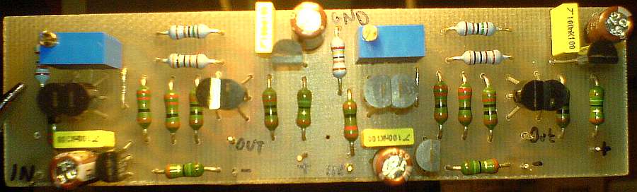

After few months of experimenting here is the circuit that sounds best to me - it's the same topology as the first one in this thread but with BJTs in output and higher Id through JFETs (6ma).
It takes the +/- 24V from F5 (they are both in the same case - F5 as integrated amp) and preamp's OUT is connected directly to F5's input.
I used the PCB from the post #3 of this thread but with some diferent components and values.

Thanks, estman.
Yes, the MOSFETs could be an option if higher output current is wanted. For driving F5, this preamp sounds better with BJTs. I tried IRF610 and IRF9610 - some smaller MOSFETs, like ZVP3306 and ZVN3306 might sound different but they are unobtainable to me.
