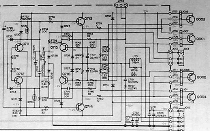

Hi, all,
I have a question about Diamond buffer used as power amp output stage. From some examples, I see 2 kind of DB used for power amp. One is CCS feeding (like the one here and also Walt Jung), the other is only R loading, like this one I attach. It comes from a respectable sounding Marantz. Using 7W 8K2 plain resistor, even without bootstrapping.
What is the pro/con between using CCS and R for feeding diamond buffer?
2nd. Is it necessary to put Capacitance between upper and lower diamond buffer? The Marantz has 2 x 10uF cap around DB, while Walt Jung uses none. Again, what is the pro/con between these 2?
David,
as you know, I also built a diamond buffer based power amp with R feeding, see http://www.pha.inecnet.cz/macura/next.htm. Though CCS should be superior due to maintaining the constant current even for large output swings, the results do not seem to be that different. The capacitor between bases in my circuit reduces distortion and helps the transition to class AB, if needed.

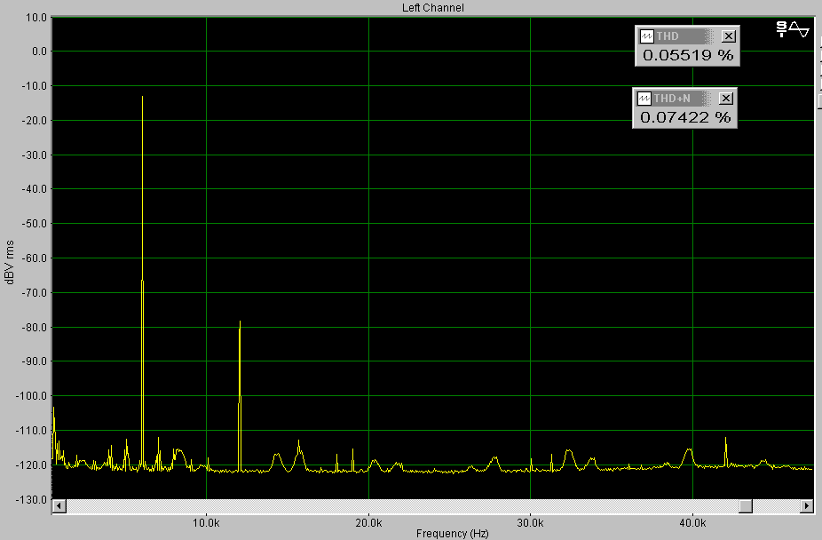

PMA said:And here is the spectrum of the circuit. As Nelson says, "distortion is almost purely 2nd harmonic". It does not depend on frequency in the audio band, same for 1kHz as for 10kHz.
means that origin of it from third bjt which is between symmetric input and symmetric output.
Now for 100 mV:
1 -12dB
2 -79 dB
3 -120 dB(?)
and due to exponential BJT for 500 mV INPUT:
1 +2dB
2 -51 dB
3 -70 dB (approx)
for 1000 mV INPUT:
1 +8dB
2 -38 dB
3 -45 dB (approx)
4 -55 dB (approx)
and a fifth quite high
Is it not too much even for 500 mV?
