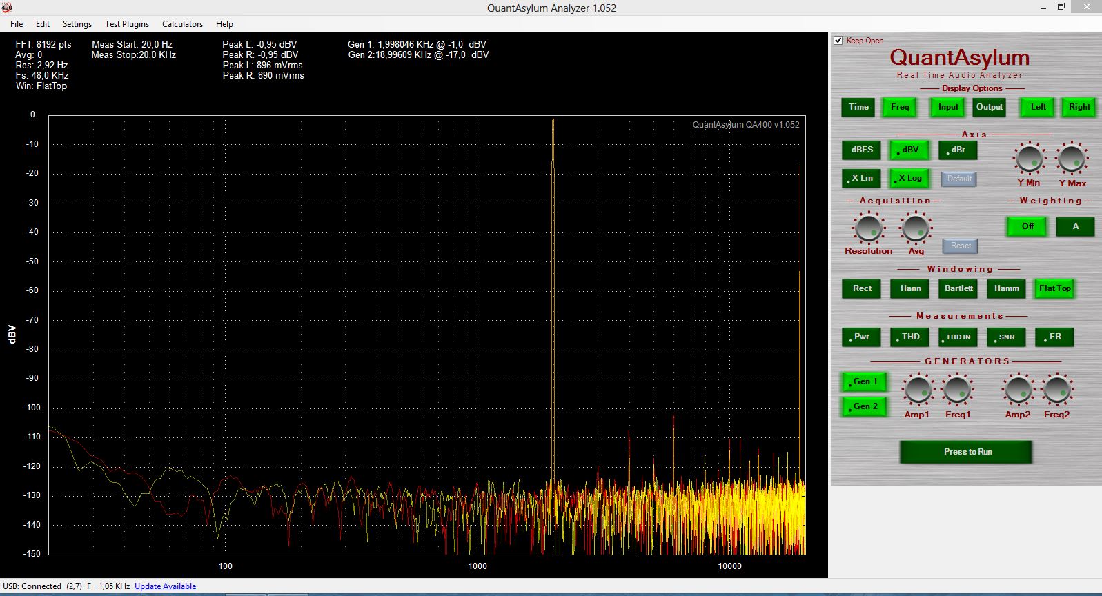

The buffer is very low distortion. Here is an overlay of the QuantAsylum 400 in loop back (red ) and the buffer ( yellow ). Distortion is under the resolution of the QuantAsylum ( -105 dB/V ). There is even some distortion cancelation going on because the amplitude of the buffer distortion is lower. Maybe that is the low output impedance driving the A/D converter.

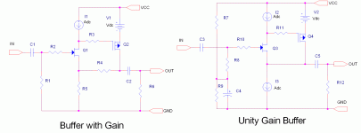

I've been working with buffers w/ gain and followers of the general form shown in the attached picture for a few years. In the case of the buffer w/gain, the input element (Q1) has been either a jfet or a mosfet w/feedback. The other gain element can be either a darlington or a mosfet. I1 has at times been a bipolar current source of some sort or a depletion mode mosfet source. Generally a compensation capacitor is needed across resistor R4. Vi has been an N-channel mosfet with gate connected to drain or an LED, depending on the voltage drop necessary for the proper voltage across I1.
The unity gain buffer actually came first, and has assumed several forms over the years. I have used both mosfets and jfets for input device Q3. The same variations used in the buffer with gain have been used for I2 and V3. Q4 has been a p-channel mosfet or a darlington.
The circuits simulate well, and sound good.

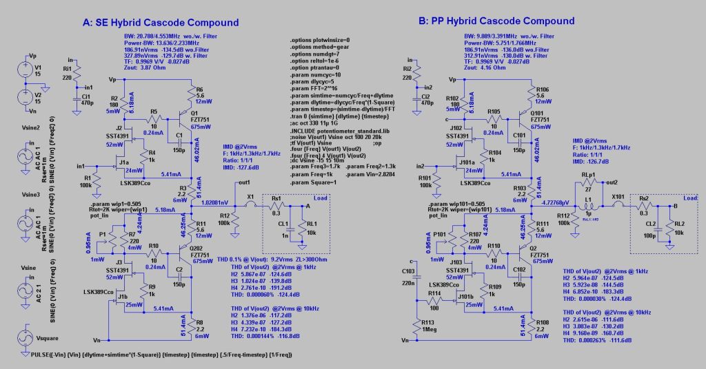

Joachim, the Rsx, RLx and CLx are no Filter but a simmed load of cable+Load impedance. The Rix, Cix are a input LP-filter. Response to a squarewave shows indeed a slight overshoot at the falling flanks but maybe tamed with a simple RL parallel network (27R||1µH/0R3) in series with the output.
I have no model of the SK369 so I simmed also for the BF862/SST4391, since it is closer to the SK369 in Transconductance and Id. Similar to Joachims transistor configuration the Idle current through the JFETs rise slightly to 6.5mA (Vds 4.31V) and considerably through the PNP to 75mA. Current through the 2R2 resistors rises to 81mA. FZT751 or FZT753 make hardly any difference.
Using the original BF862 Model of NXP the overshoot is completely gone. Maybe due to a lower Gate capacitance than the 2SK389/LSK389?
Btw: The small offset, is it due to matched SK369 or did You use the trimpot as in the schematic?
EUVL, yes, the simple cascoded JFETs are absolutely sufficient for higher impedance loads. The idea of the Sziklay is just to increase current drive capability/lower load impedance drive capability without giving up too much on simplicity and to stay with SE circuitry. The choice of parts is such that only active and SMD-parts are used instead of obsolete and throughholes.
You can increase current drive further by going push-pull as for example in Your suggested circuits. This requires modulating the ´negative´ part of the circuits. You can do this with the shown Hybrid Cascode Compound Buffer (HCC) also by adding a simple RC series network. A technique Erno Borbely showed in his article about JFETs "JFETs: The new frontiers, part 2", Fig. 16A. This transforms the circuit from singleended to push-pull, but may be a bit harder to stabilize. see attached file, C103,R113, circuit B:.
