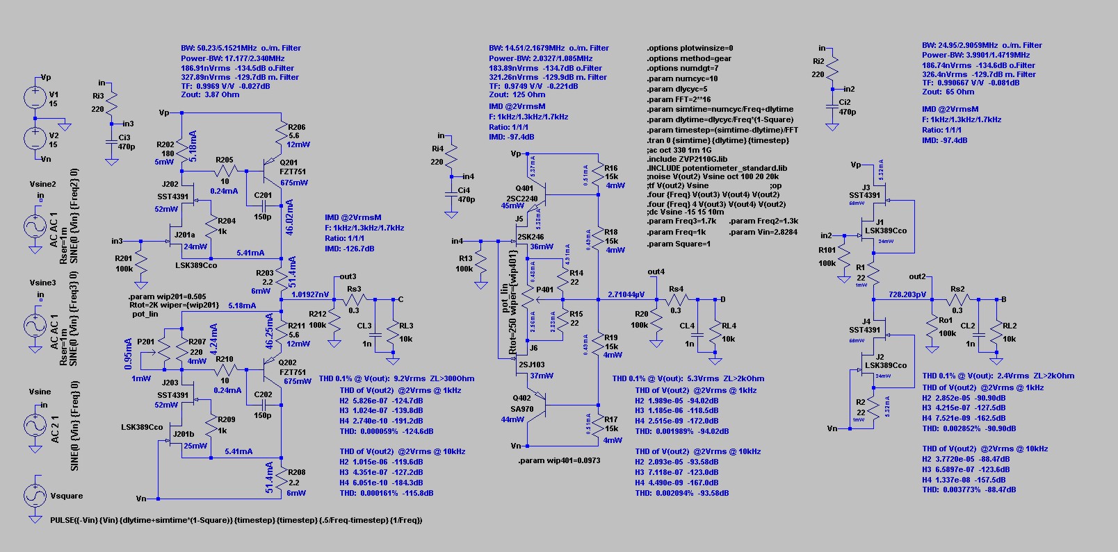

circuit A, the simple source follower sounds very natural, but is what I´d call a connoiseur´s circuit. It is excellent for classical music, but may lack a little bit on authority or massive slam with Pop or Rock. This is a sonic impression not just of me but also of different persons. The ´weight´ or impact seems to be directly related to the amount and quality of decoupling capacitance in the power supplies. More seems better here.
circuit B already adds the weight and authority with less demand on supply capacitance.
Since George´s driven cascode shows more similarities to circuit B in circuit structure and in simulation, it´d be interesting to hear, if there are any differences and how they manifest.
Both circuits are suited only for higher load impedances from 1-2kOhm up.
The driven cascode allowing for higher maximum output voltage at the cost of slightly more loss in tranfer function and higher parts number count.
As one can see from the wiper position and the currents through each Poti-part the NJFET and PJFET differ considerably. The part of the poti towards the negative branch is set to mere 24Ohms. Hence roughly half the current is running through the lower part and wiper of the poti. I wouldn´t want to allow for more than 1/4 to 1/5 of the branches current, or max 1mA, running through the trimpot due to quality of wiper contact and high temperature coefficient.
The combination of 2SK170/2SJ74 sims clearly better with regard to THD.
Also, using EUVLs trick of matching N- and P-JFETs transconductance curves by adding a small (or slightly higher) source resistor to a 2SJ74 with slightly higher IDss might even render the trimpot obsolete. At least it´d reduce the amount of current running through the trimpot.
Still though, does the driven cascode not match the cascoded compound circuits in THD and drive capablity. This would require different parts allowing for idle currents around 25mA.

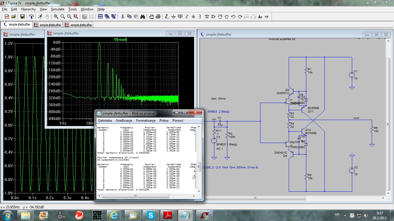

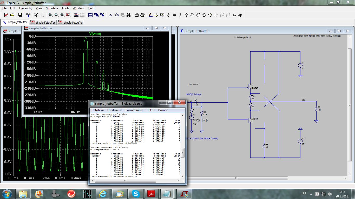

To get better out of this simple buffer(not so simple any more) it needs proper bootstraps.
You can add the nulling pot here too.

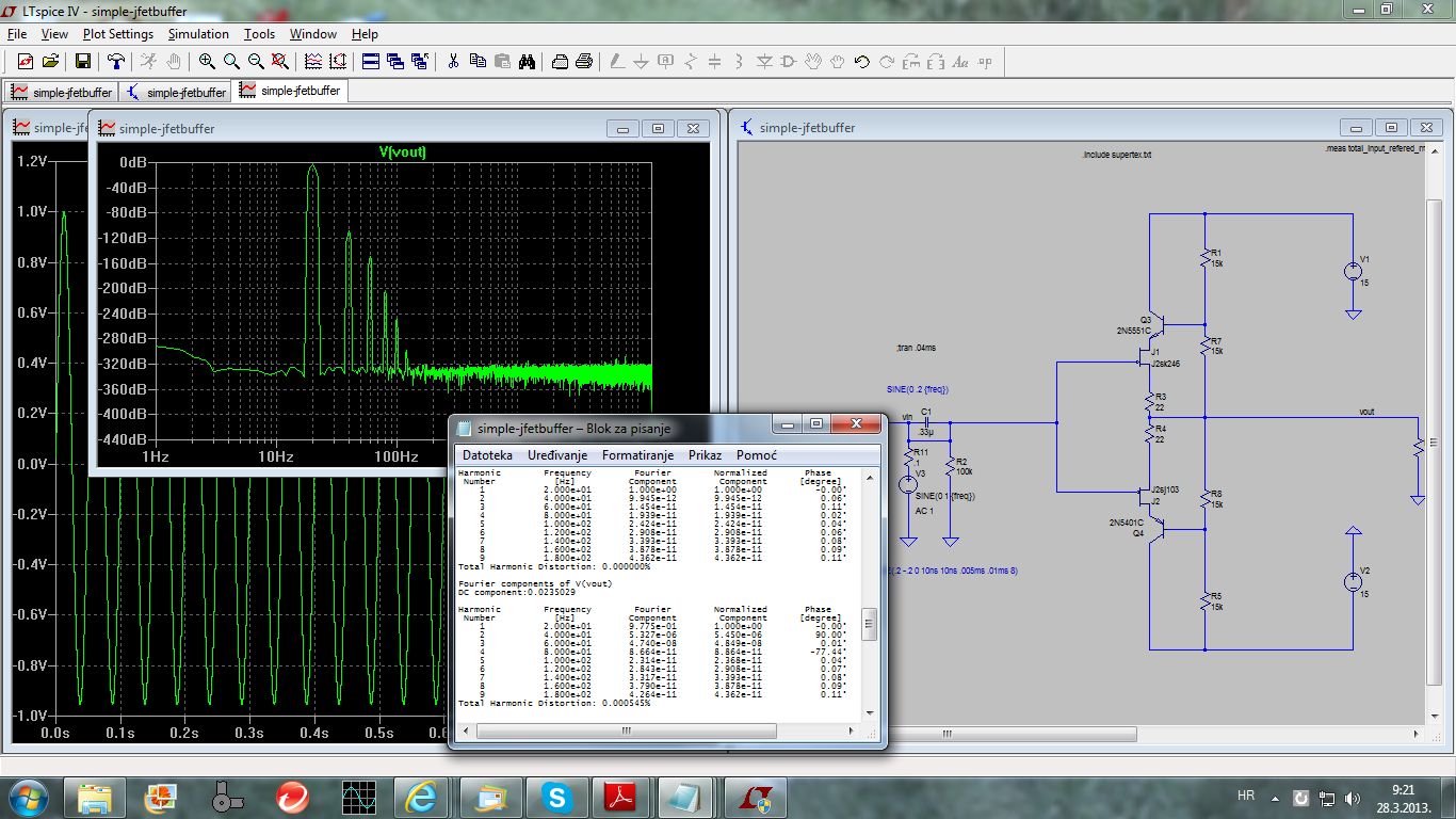

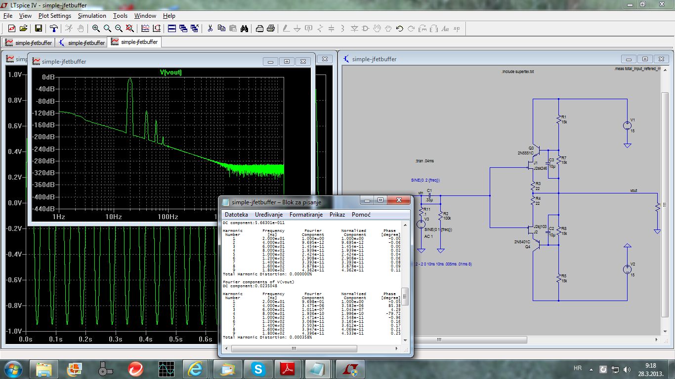

Dadod, You´re sure that te parameters for THD-simulation in Your .asc are complete and correct?
Is there a plotwinsize=0 command and are sim-time and related parameters as required for a reasonable THD-sim?
I get certainly worse results, around 0.001% for 1Vrms@1kHz.
jauu
Calvin
