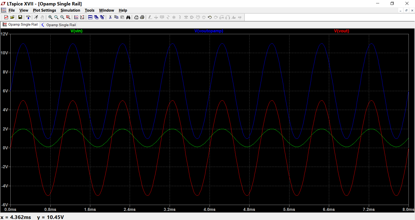

I'm not sure quite what you are trying to do there.
For that configuration (inverting) the reference voltage needs to be Vcc/2. You can alter that for certain situations but audio usually requires symmetrical clipping to maximise the available non distorted output level.
Your numbers don't make sense :) Vin max = 5v and Vin min =-5v means you need a gain of 1 or less to get an undistorted output from the opamp on a 12 volt supply.
That lower gain is what is represented by the -0.35 V/V figure.

To design an opamp preamp stage we need to know as a starting point:
1/ The supply voltage.
2/ The expected input voltage range. A CD player could be as high as 2.4 volts RMS (that's 7 volts pk-pk) at max output (some players are specified above the 2 volt RMS accepted standard).
3/ Your desired input impedance.

The supply voltage puts an absolute limit on how muh voltage you can get from the opamp output. A 12 volt supply means you are looking at around 10 volts of signal as a maximum for a common opamp.
'Common mode' means in a circuit where the two inputs see essentially the same voltage, then that voltage has to stay within given limits... and that often the supply voltage for the opamp as a general rule or as here, the negative supply plus 2.5 volts and the positive supply minus 2.5 volts. So on a -/+15 volts supply you can not drive both inputs to greater than -/+ 12.5 volts.
The input impedance is how much of a load the circuit places on the equipment driving it. Normally we like the input impedance to be high, say over 100k ohms so that it doesn't affect the previous stage. The input impedance of the opamp itself is very very high so high in fact that it doesn't really figure in the equation, it is the components we place around the opamp that determine the final input impedance.
Given that a CD player (any CD player) is going to produce around 2 volts RMS for the very loudest bits on a disc then your preamp running on 12 volts can not have much gain or else it will clip and distort.
Administrator
Joined 2007
Those values give you a Vout max of around 10 or 11 volts DC and a minimum of around 1 to 2 volts DC. The output from the opamp would be AC coupled as well as the input.
So the maximum allowable gain would be around 5.3 for that input voltage.
This shows the input voltage (0.1 to 2 volts), the opamp output voltage and the preamp output voltage after AC coupling. Notice how the opamp goes from 1 to 11 volts and also how the output cap makes the final voltage symmetrical around ground.
If input signal Vin max amplitude will exceed 2V signal will be clipped?
Looking at this again, yes, since most of modern digital sources produce output more than 1V RMS, which is already sufficient to drive audio Op Amp (LM324), then it doesn’t need another preamplifier. So preamp only needed for microphone input in this case. And Line in input can be directly connected to VR1 trimpot via decoupling capacitor after Mic/Line switch?

You can work it out very simply like this...
For a single rail amp you take the supply voltage and divide it by 2. Now take that result and divide it by root 2. So for example with a 24 volt supply we get (24/2)/√2 which is 8.4
8.4 is the maximum RMS output voltage we can get from a single rail amp running on 24 volts.
When designing the amplifier stage, the maximum RMS input voltage multiplied by the gain of the stage has to give a number less than 8.4, otherwise it clips.
Administrator
Joined 2007
So then :)
your maximum RMS input voltage multiplied by the gain of the amplifier stage must come to less than 4.24 for it not to clip.
eg, opamp gain of 20, maximum input of 100mv RMS give 0.1 *20 which is 2. That would be OK.
Input voltage of 300mv RMS gives 0.3 *20 which is 6. No good.
