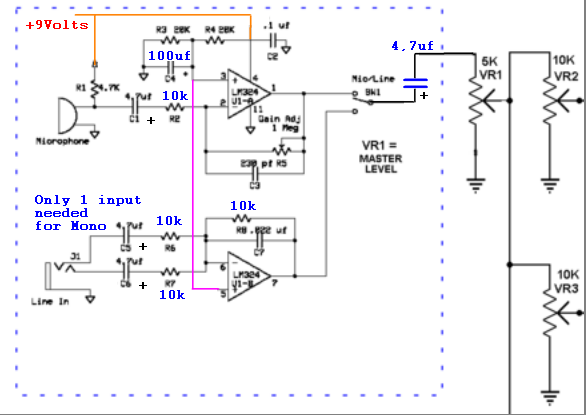

I want make pre-amplifier part for analog electronic circuit (color organ). Audio can enter the circuit in two ways: either thru the electret mic, or thru Line-in jack. The audio from two different audio sources (electret mic and Line-in) need be amplified before being fed to four separate filter circuits and processing it with band-pass filters.
The example below show pre-amps built on LM324, I want replace it with OPA2172 op-amp. Need help to construct this correctly, your advices and suggestions are welcome.

The OPA opamp should be OK as it is specified down to <5 volts supply voltage. Feeding 2.5 volts DC into each pot (which is what the circuit will do) is bad design, they should be AC coupled. Having a pot (or preset) in the feedback loop is not optimal for gain control but it does have the advantage of simplicity. If you use a pot then it needs to be well shielded with the body grounded to avoid pickup.
The line inputs have a very low input impedance of 1k, and a pretty high LF roll off point with just a 4.7uf coupling cap.
The mic input is low impedance too. Can an electret drive 1k ? Both inputs are inverting of overall phase.
It is what it is... a workable but pretty generic type of circuit. It is simple and easy to build though.
Hi, the LM324 would be fine as it doesn't need to be HiFi for this aplication. But if you want to use the OPA2172 ok.
I think at least a 9V power supply would be better, with the 100uf cap too. You only need one half supply to feed both OpAmp + inputs, as i've shown.
Note that C1/5/6 polarity are reversed, & i've added a 4.7uf to the output. R2/6/7 changed to 10k.
You should then be good to go :)

Hi, thanks for the advice.
LM324 would be OK, but its quad channel op-amp, though. It would be preferable double channel version. Power supply for all circuit is +12V.
For microphone input main trouble is that capsule microphones don't have a good low frequency response and they can also pick up echo sounds.

Use any decent dual OpAmp you like on 12V. You should have said it was going to be 12V & not 5V !
A capsule microphone should be fine for your purpose. Or just use the line input.

Well, how this design can be improved, from your point of view ?
Administrator
Joined 2007
Looking at the full circuit and seeing what it all does...... well I don't think much in the way of changes are needed. The use of an OPA opamp is not really called for because the final output is an incandescent lamp. So noise/distortion/slew rate, non of it really matters now.
The changes that were mentioned to raise the input impedance are still worthwhile though. I can't see the FET type mentioned anywhere but something like the 2N7000 type of device looks suitable.
