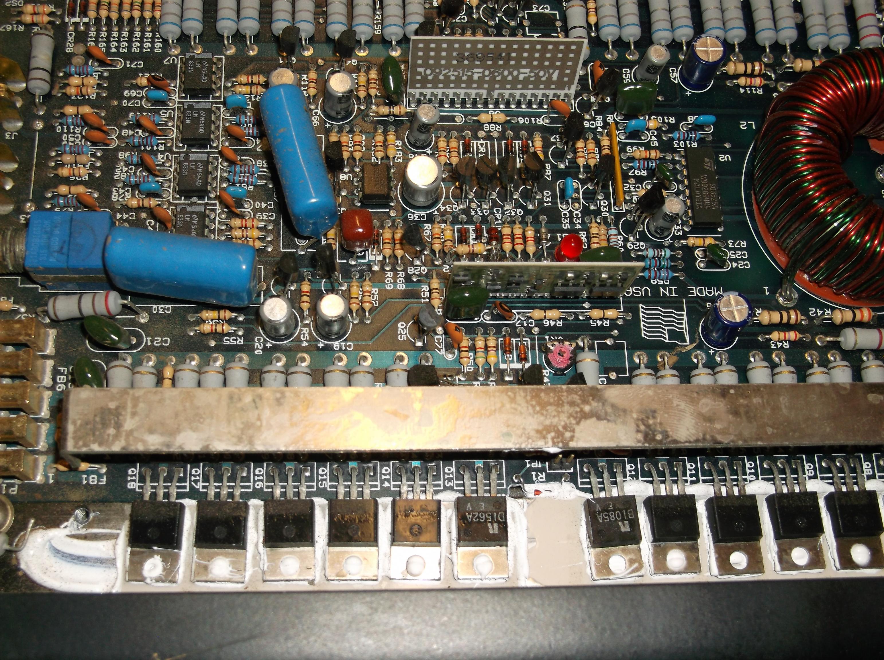

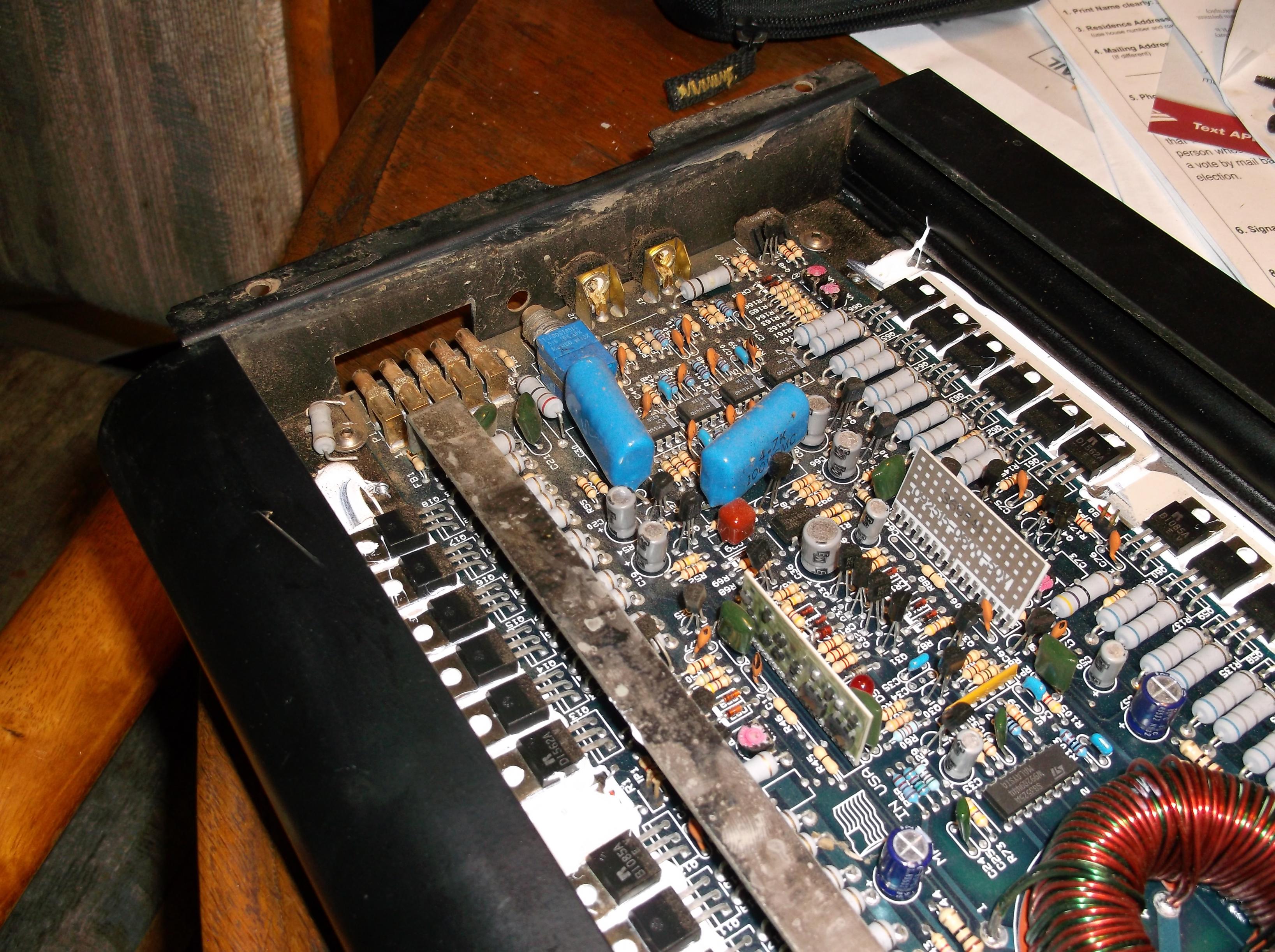

Sorry guys it tooked me awhile to post pix of ppi A600.2
Hi guys sorry it tooked a while to post a pix of the amp. This is the first amp that has power and low ohms light both lit up. in the pix i found R57 is open not on the board will that cause sound problems here are a few pix i would like to know what to test and what i should do next thank you

Now I see you posted the same pics for both threads so your gonna need to differentiate between the two amps and repost pics of the correct amp in which ever thread they need to be changed.
You see the same pics in both threads causes confusion because a lot of the visual information is incorrect for one of these amps.
I am taking it that these pics are the ones for this thread description so I am posting in this thread for now.
1: I see a 10 ohm current limit resistor loose up front. This melted its solder and fell off the board just behind one of the RCAs. This is a good sign of which channel is damaged as when these amps blow outputs they tend to load a high amount of current thru that resistor back onto the RCA shield ground back to the HU. They often just blow open, but in this case it appears to have melted its solder and allowed the resistor to fall out of circuit. I am 99.99% sure this channel has blown outputs, or its passing huge amounts of DC voltage out of it due to some failure related reason.
Based on your description of the leds operation I would ohm meter the outputs for this channel. It's likely that only one or two are bad but due to the parallel design I would replace the entire set with as closely matched as possible new ones. The center two transistors < B1058A and D1562A > are drivers and they can also be damaged if the outputs failed.
Replace the resistor with new, and replace any damaged outputs and drivers in that channel.
Have you studied up on Perry's web-site yet? On his web site it will show you how to meter these devices and it will show you the acceptable meter readings for a GO- No Go test with a meter for these devices.
2: up under the big metal ground buss bar the very last resistor is part of a output zobel filter for that channel. it could be damaged < I.E. burnt or blown open > from the channel failure. It can not be seen in the pics you posted but I have done too many of these to overlook it as possibly failed due to excessive voltage on the speaker terminals. its failure is always linked to number 1 above.
You should look at this and test it to make sure its like its mate near by closer to the speaker terminals < one for each channel, the suspect is hidden under the bar > Replace as needed.
3: I also see a fair amount of water damaged on this amp < corrosion and silt build up etc..> This will have to scrubbed off somehow. I recommend a paint brush with semi stiff bristles and some cleaner like pure alcohol or PC Board cleaner you can buy at the electronics store. not the alcohol you buy from a pharmacy labelled as rubbing alcohol as it contains 30% fragrance and moisturizers to prevent sink irritation. < this stuff is no good on electronics so you don't want to use it. You can use denatured alcohol from a hardware store found in the paint section if you like. It quality is ok to use in this case.

The other resistor in question in the one just at the end of that big ground bar and just underneath it near where the bar is soldered to the board. I have seen them burn up when a channel fails. if it shows no signs of heat stress and it reads like its match just to the right of the speaker terminals then your all good on that one. I would replace the ones behind the RCAs and the one floating. They burn up somewhat regularly and I even stock them just because of their high failure rate.
so are u talking about FB1 resister and right behind U3 rca that blue resister i should test or replace sorry maybe u can draw a arrow to show me on the pix ? lol cool yea i live by chico cali been wanting to learn hands on working on amps, and my next thing is i dont really have a good solder gun either so i need some help on which stuff i should get for soldering stuff on amps. Thank you again
please see attached pic it has been marked up to show where the loose resistor went, and they both look burnt. 10 ohm 2 watt.
also you will see another resistor has been circled its also desoldered and likely burnt, and a small arrow points to it sister for the other channel under the bar and it also is likely damaged. These are the zobel output filters and they overheat when a amp is clipped badly and or it has some out of bandwidth output on the speaker terminals.
These device die due to abuse of the amp, and are side effects of the amps failure mode so fixing these items will not completely fix the amp. they are just symptoms of a greater issue lurking elsewhere in the amp channels.

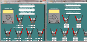

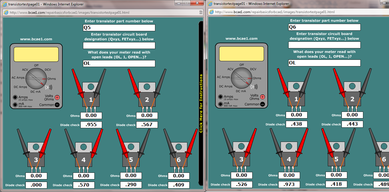

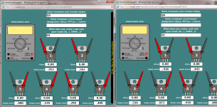

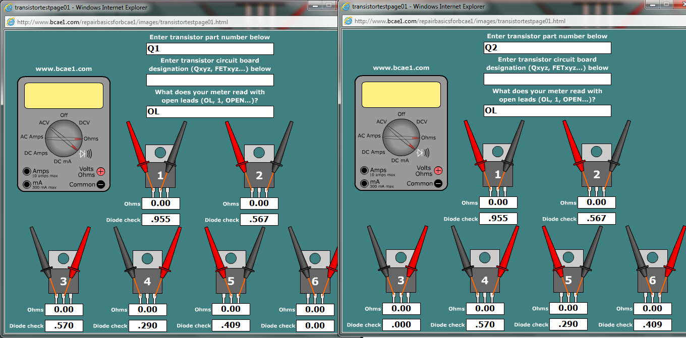

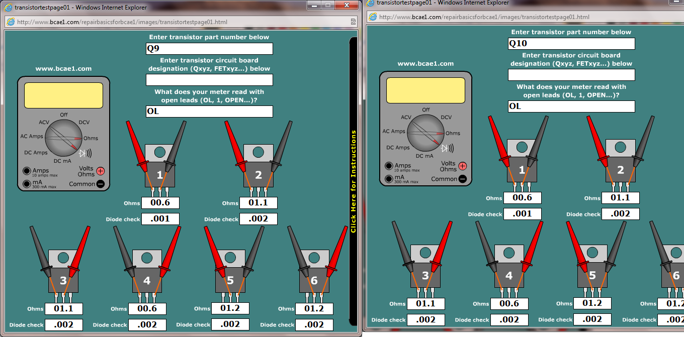

Got some of the transister on the side of the amp tested
Hi guys i got some of the transister tested only have Q1 to Q6 tested so far i'm working on the rest of them thank you Joey:)

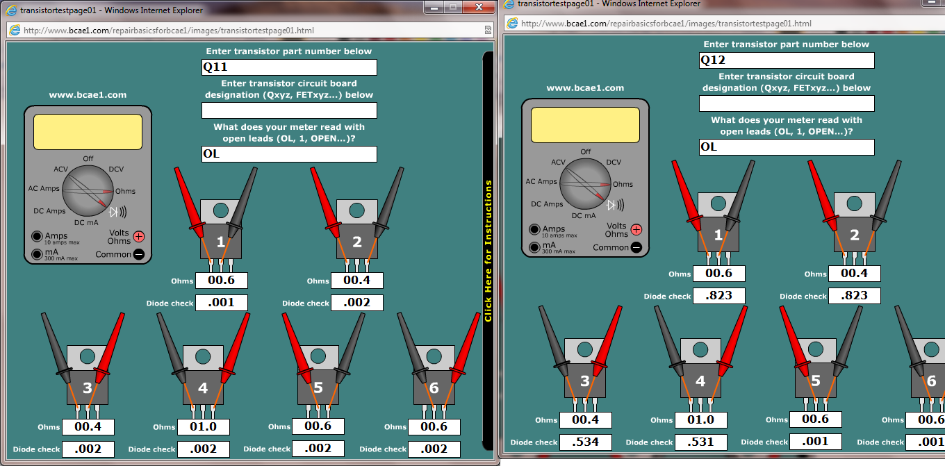

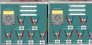

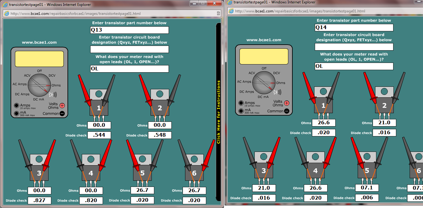

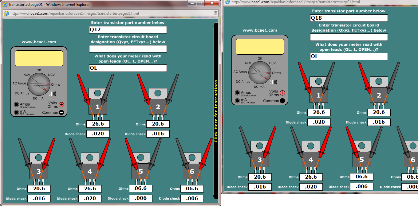

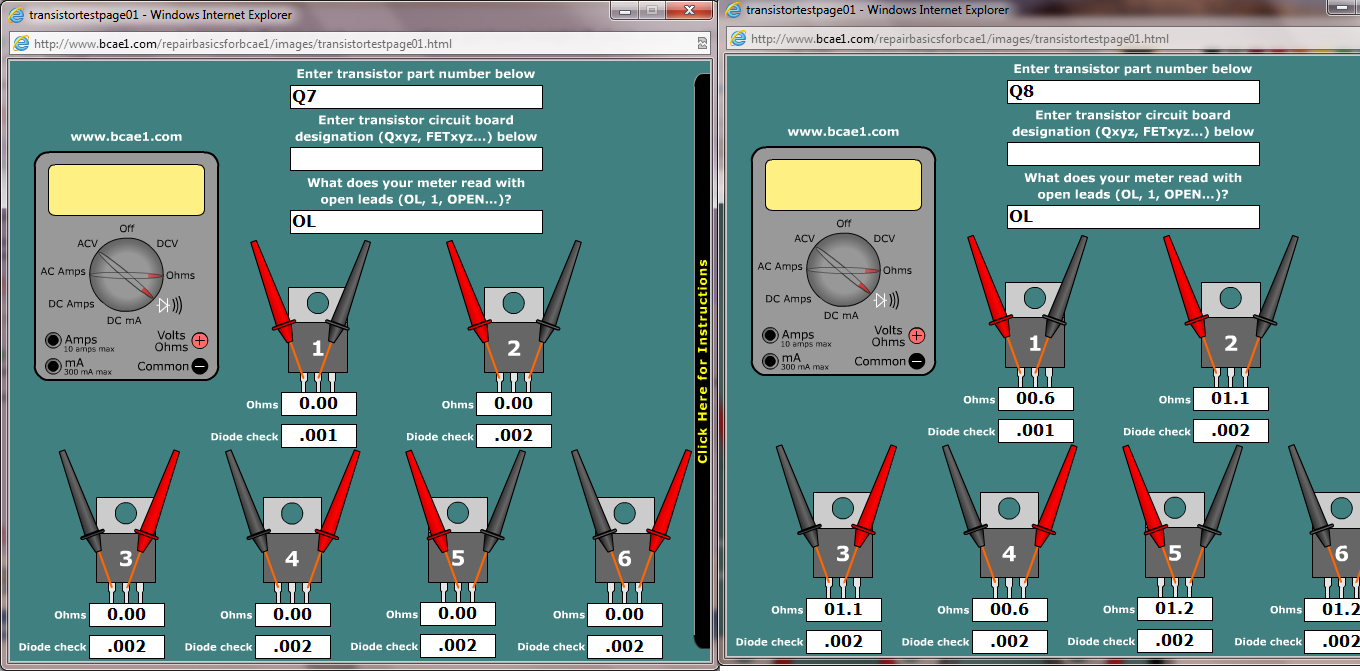

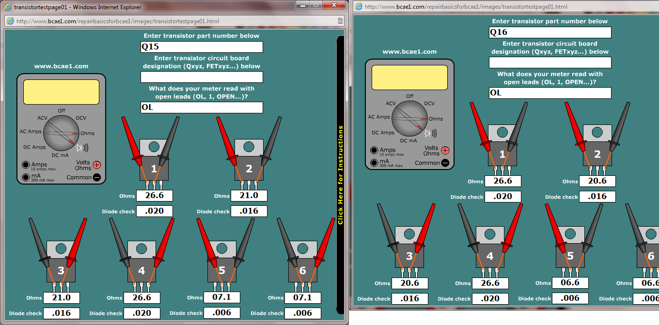

hey guys i finally got one side of the amp transister done
hi guys i just now got the one side of amp done testing the Transister here are the rest thank you for ur help and i been reading a bit on perry site it helps alot takes me a bit to learn but willing to try from Joey
