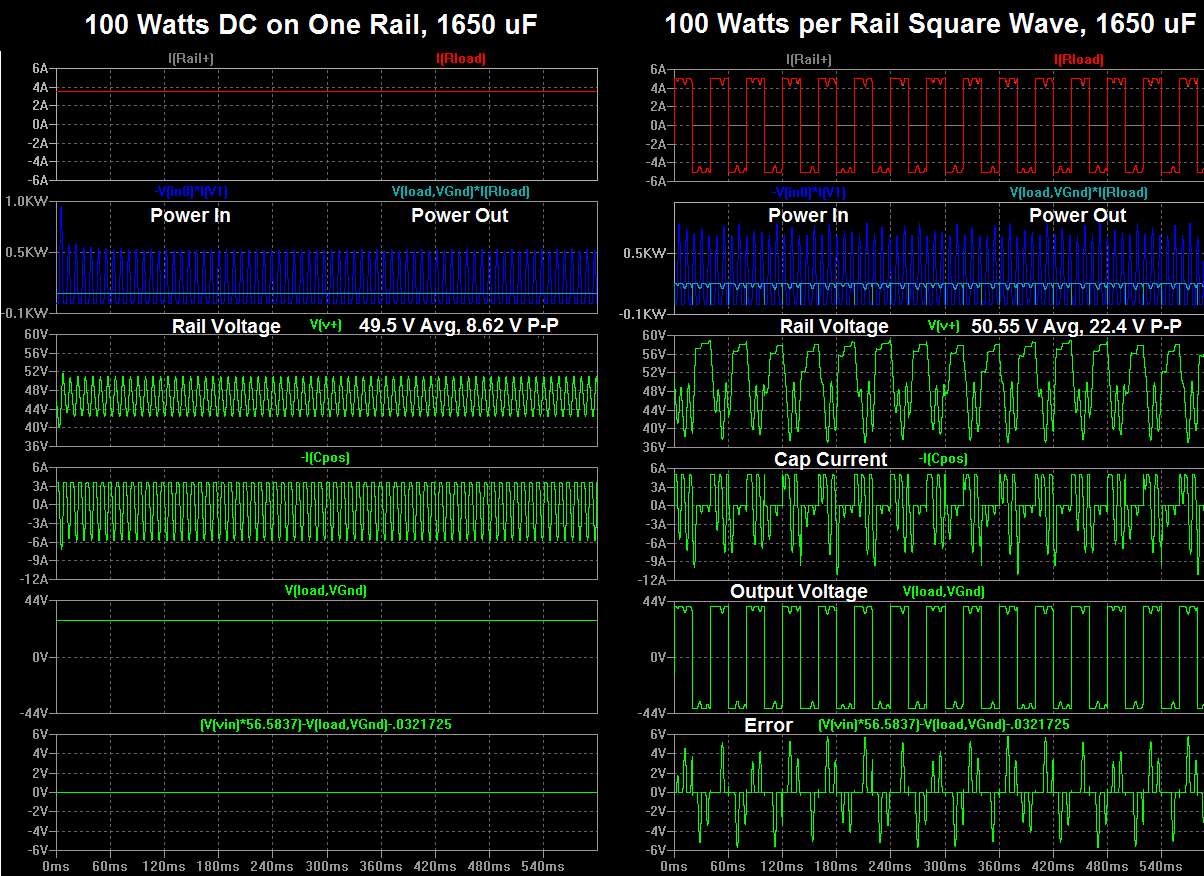

At any rate, my original plan was to try to use simulations to find the ACTUAL lower bound for the C value, for different cases, and then compare that to what the standard equations give, and then try to move forward from there. I think that I am just now finally able to compare the simulation results to the standard equations' results, which I attempt to do, below or in another post.
I do realize that you pointed out, correctly, that it will also depend on the amplifier topology, since the actual absolute-minimum C depends on the minimum voltage that can exist across the amplifier, i.e. between the rail and the high side of the load, with the minimum C being the one that allows the rail voltage to have a worst-case drop that doesn't quite reach Vload_max_peak + Vamp_minimum, for the worst-case timing of a load current peak and the first quarter of a charging pulse. But I can either leave the minimum Vamp as a variable, or, just add a few volts (for a minimum Vce plus a small series resistor), for now, and be close enough for this purpose.
(Yes, it appears that a rail-voltage incursion into the output voltage only occurs during the upward-curving portion of the beginning of a current pulse from the transformer, between zero and the first inflection point. Made me wonder if the second derivative of the transformer current was important.)

But, with a 240 VA secondary for each rail (a 480 VA transformer), simulations found the "actual" C_minimums to be:
C = 330 uF, 770 uF, 1540 uF, and 6650 uF
It appears that the standard equations are assuming an ideal transformer, and that they also don't account for the occasional badly-timed load current peak relative to a charging pulse.
So the standard equations do well when the transformer is ridiculously over-sized compared to the output power spec.
HOWEVER, as I've been saying repeatedly, everything in my simulations depends on how good the transformer models are. And Terry Given just mentioned that it looks a little wacky.

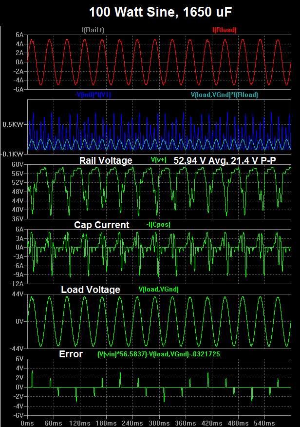

I think you have demonstrated that the 'standard methods' are completely adequate, when used properly i.e. circuit theory actually works OK.
gootee said:
Anyway, I think that the part where you say "Then double it." would need to be justified.
The justification is simple: normal engineering caution, combined with broad electrolytic value tolerances (can be 20%). The calculation gives the minimum. There seems to be no harm in increasing this (within reason) so increase it. There is no point, and possibly some harm, in increasing it too much. Hence double it. x3 or x4 would be just as good, although maybe unnecessary.
The calculations you have done show good agreement with simulations for lower powers. The discrepancy for higher power mainly comes from Vmin being a bit too small. This has little effect at low power (i.e. high ripple voltage) but is critical at high power (low ripple voltage). As you have included the 0.22ohm drop in Vmin (not a good idea, in my opinion) your Vmin should be bigger for greater power. Try repeating your calcs for Vmin=4V instead of 3V.
Including transformer resistance in the calculations gets messy, unless the resistance is sufficiently low that the cap can recharge more or less fully on each mains half-cycle. As I said in an earlier post, this gets worse for really big caps which may be a reason to avoid really big caps.
So we are in a position where we can calculate, with some confidence, the minimum cap value. We can also estimate, roughly, the maximum. Isn't that 'job done'?

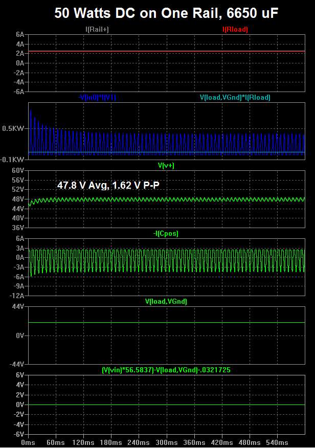

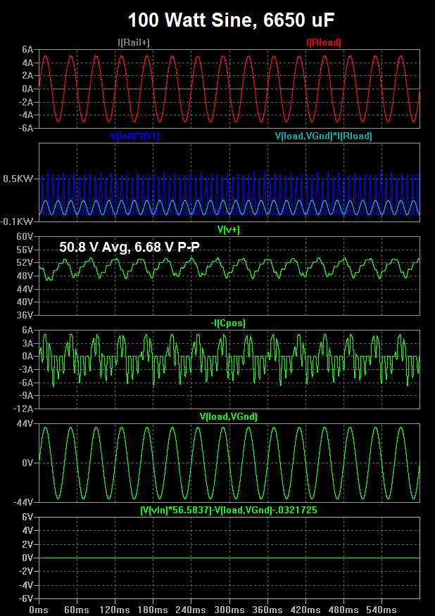

Attached are some plots for comparisons but I will not be able to analyze them until tomorrow or the next day. They include DC, sine, and square wave loads, with 1650 uF and 6650 uF.
