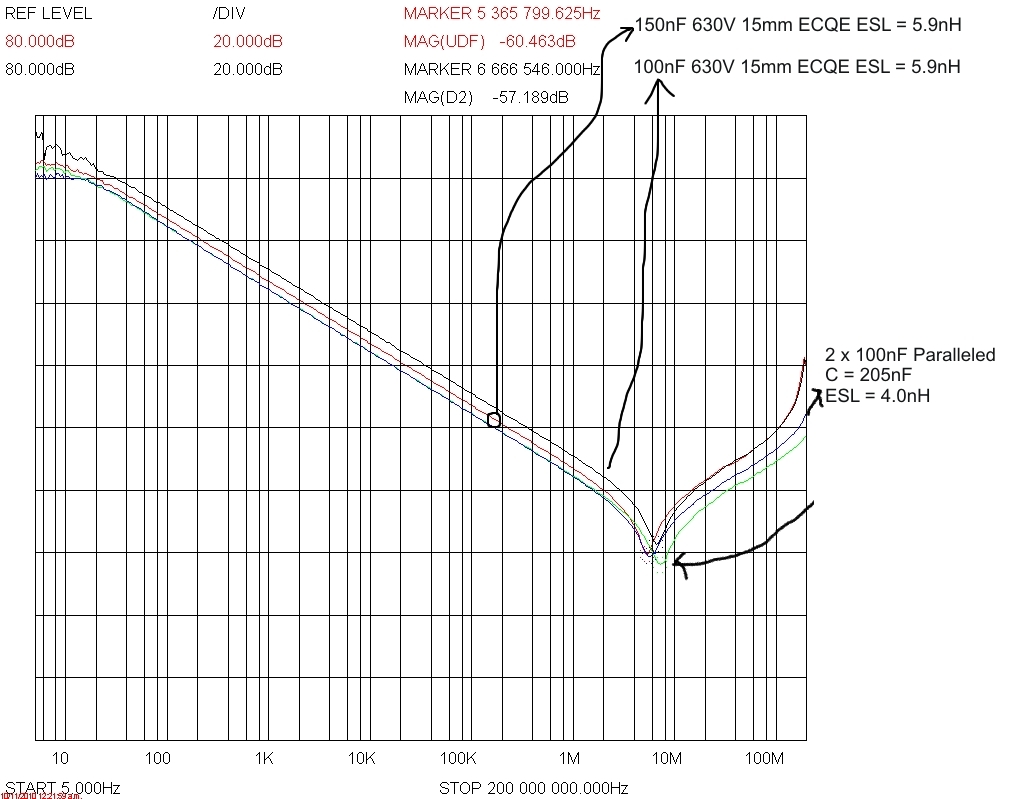

Even with planes, the problem that can partially ruin the improvement from paralleling is when the conductors are no longer completely separate, i.e. the currents have to share some length of conductor. Then there would be MUTUAL inductance. And that wrecks the algebra somewhat so that the inductances don't fully reduce from paralleling.
Tom, thats not actually correct - there is mutual inductance regardless of whether or not they share some length of conductor, as long as the flux of one current-carrying loop cuts another current-carrying loop (think loop antennas).
If the currents share some length of conductor then there is more mutual inductance - this forces the flux of one loop to cut the other - it has to, as they share a common conductor.
This shared-conductor method is actually quite common in small loop antennas, and is used for impedance transformation. The transmitter drives a small (often rectangular) loop, which shares a segment with the main transmitting loop, making what is basically an air-cored transformer (hence the impedance transformation)
I should have pointed this out some time ago, but forgot. sorry, my bad.
Unfortunately this kind of ruins your "n parallel sets of wiring" approach - in order for that method to work in practice, you must ensure that there is little or no magnetic coupling between the parallel sets of wiring.
This also occurs when you parallel a pair of film capacitors - the overall ESL does go down, but it does not halve. see the attached plot. I paralleled a pair of 5.9nH 100nF Panasonic ECQE caps, and the resultant inductance was 4nH, not 3nH as you might expect. the caps were hard against each other (6mm between pins), and I calibrated out the test fixture PCB they were mounted on.
interestingly enough this doesnt really happen when you parallel electrolytics (on a PCB set up as a parallel-plate transmission line) as most of the ESL is inside an AL can, which does a pretty good job of eddy-current shielding (what with ESL effects occurring at high frequencies). If, however, you have a horrible wiring layout (ring terminals and widely spaced wires) rather than a well laid out DS-PCB, then all the wiring inductances mutually couple (IOW with electrolytics the overall ESL is dominated by the wiring/pcb layout)

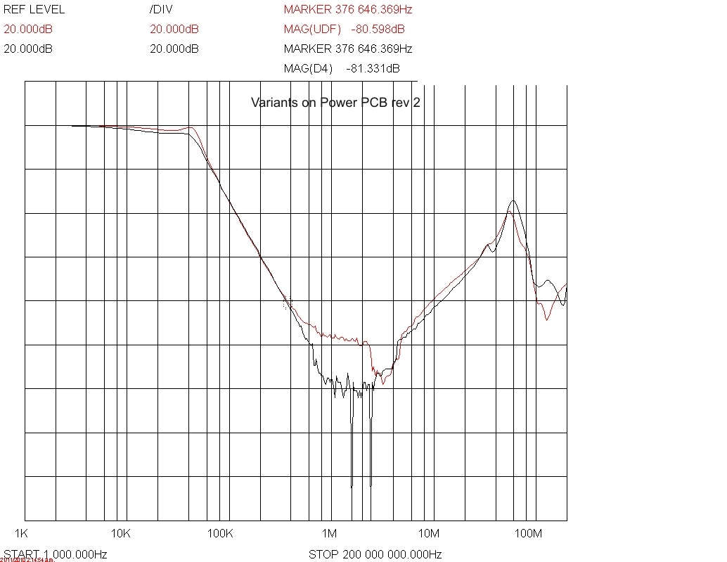

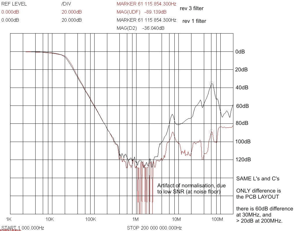

I spent about 3 months working on this a couple of years ago - it was a DM filter for a PFC flyback smps. the first 8-10 weeks were spent fiddling around with various stupid layouts, measuring the results with EMI scans, and not getting anywhere. then I spent a bit of money and bought an HP-35676 50R signal divider for my HP3577A network analyzer, bought/made some calibration standards and started to accurately measure the actual impedances on assembled PCBs.
Once I could accurately, repeatably measure down below 1nH (up to 200MHz) I made significant progress in 2 weeks. Until then, I got nowhere - even though I've got 15yrs experience in this area, guessing my actual parasitics just wasnt good enough.
See the attached plots. The red trace on "EMI filter 1.jpg" was where I started, and I managed to get to the black trace after 8 weeks - all I managed to do was make a 20dB improvement between 600kHz and 2MHz, but all my efforts had no effect whatsoever above 2MHz.
Once I could actually measure the in-situ impedances though, I got to the red trace on "EMI Filter 2.jpg" in 1 PCB revision. I took those plots using the same inductors and capacitors - I de-soldered them from the rev 1 PCB and soldered them onto the rev 3 PCB. t took 2 weeks, but 1 week was waiting for PCBs, and about 0.5 weeks learning how to make the precise measurements. it really only took 1 day to get an extra 60dB attenuation at 30MHz.
This is why I harp on about parallel-plate transmission lines for multiple paralleled caps. all you need to do is not chop great big holes in your V+(V-) & 0V planes and voila, you get an excellent, broadband layout. try pulling clever tricks without measuring anything and you just wont (think wheelstands and endos at 100mph with your eyes shut. how well is that likely to turn out)

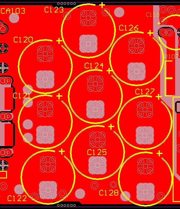

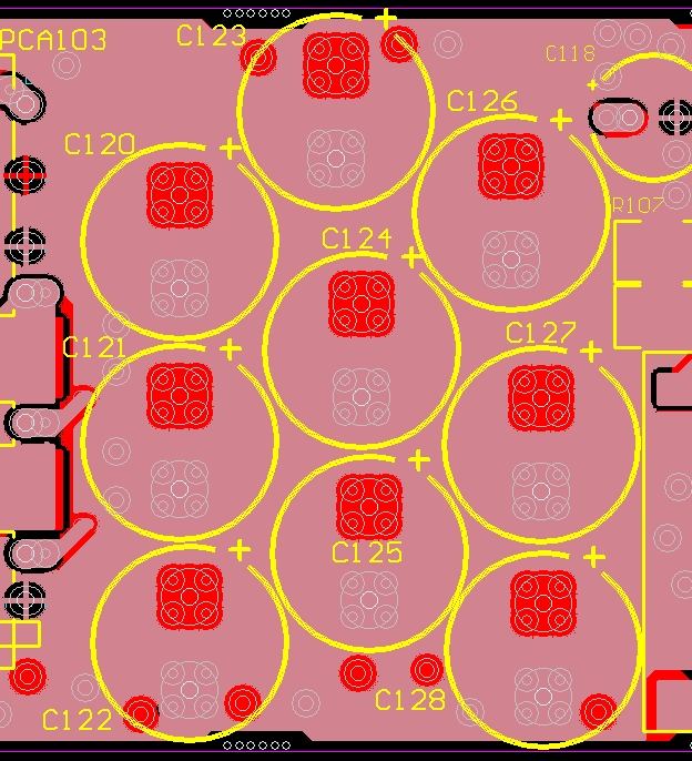

here is a parallel-plate transmission line pcb layout.
As you can see the PCB layout is very, very simple. the top layer is +Vdc (+24V in this case), the bottom layer is 0V. and each layer is almost entirely solid Cu, only having holes in it where unconnected component legs are.
this is much, much easier than trying to use parasitics as design elements - with or without fancy measuring gear or unbelievably expensive parasitic extraction software.
This is exactly the technique I used for the key, caps adjacent to the chip amp in my OTT gainclone project. No measurements done, but the sound was good enough for me ... :)

I've been playing around with a conceptual SYMEF layout, and making the local decoupling on the amp look like this really is difficult - the layouts that Harrison (OnAudio) has done are pretty damn good, given all the constraints - they are much better than all the audio amp layouts I have looked at to date.
but what is dead easy is to make a separate rectifier/capacitor PCB using this approach. There are almost no components (input connectors/wires, rectifier(s), lots of caps, output connectors/wires) so its utterly trivial to make a DS-PCB with one layer a solid 0V plane, and the other side having a solid V+ plane on one half, and a solid V- plane on the other half.
This can be placed nice and close to the transformer, then connected to the amp with tightly twisted (not plaitted even though its prettier, 'cos AndrewT is quite right that twisting has lower inductance).
This will do a brilliant job of killing any AC line noise stone dead as it will be very low Z up to the MHz region, and also keeps the Xfmr 2ndary wires (again twisted) really short, greatly reducing (removing?) magnetic coupling of the cap charging currents into the amp.
placing the fuses in series with the DC bus interconnect gives us a poor-mans CRC filter - and the fuse resistance (if we play our cards right) ought to damp the L_wiring/C_amp circuit too. After all, L_wiring is small and C_amp is moderately big so it wont take much R_fuse to do this.
we can put the fuses on the amp PCB or the rectifier/cap PCB. I doubt it makes much difference, but I'd put them on the rectifier/cap PCB because the fuses do form a reasonably large loop. I'd also place the two fuses at right angles to minimise mutual inductance between them (why not - this pcb isnt exactly complicated).
Then we can do the best job possible with the amplifier local decoupling, and if the various constraints mean its not quite as good as we want - oh well, at least we annihilated the AC line noise and cap charging current problems.

reductio ad absurdum: a ginormous Nx1 cap array facing away from the power devices would not share very well. I'll dig into the maths of current diffusion and see if I cant come up with a sensible answer. bugger actually doing the maths, thats way too hard (Schwarz-Christoffel transforms? I dont think so) - but I'm pretty sure I've got an analysis of a step-change in conductor width kicking around somewhere - and from that I ought to be able to finagle a "spreading depth" (analagous to skin depth) over which the current will spread out to be evenly distributed. If I was any good at using FEA freeware like FEMM I could just run a few sims and rip the answer out of the current density plots, but I'm not.
you can also force the cap array to share. if we make a rectifier/cap PCB for a single supply, with a rectangular (or square, doesnt really matter) form, and place the rectifier in the center of one edge, with the dc output in the center of the opposite edge, then most of the caps will share the current - the caps in the four corners might not though. but if we extend the PCB a bit (how much? dunno, thats what I'll figure out as above) on either side, and leave the cap bank in the center, then even the corner caps will share the current, as the extensions allow the current to spread out from the rectifier (connector) to cover the full width of the PCB

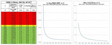

Here is some more data, the 100W case to go with the 25W, 50W, and 75W cases in post # 1175, which is at http://www.diyaudio.com/forums/power-supplies/216409-power-supply-resevoir-size-118.html#post3166321 .
I also attached the spreadsheet with all of this. Just remove the .txt from the filename after (or while) downloading it.
It looks like "2500 uF/Amp", using RMS Amps into the load at 2X the maximum rated output power level, would be more than sufficient, for these four 8-Ohm cases, for which the transformer is well over-sized. That gives about 5% as the maximum drop in rail voltage (the drop is relative to its average level), in each case, and about 0.005% average RMS error, in each case, in the square wave that draws 2X the rated power. But you could go as low as 1600-1800 uF per amp, and even lower when rated output power is less than 100W. But for higher than 100W rated output power with the same transformer ratings, more uF/amp would probably be required. I will try to run some other cases, as I get time.
