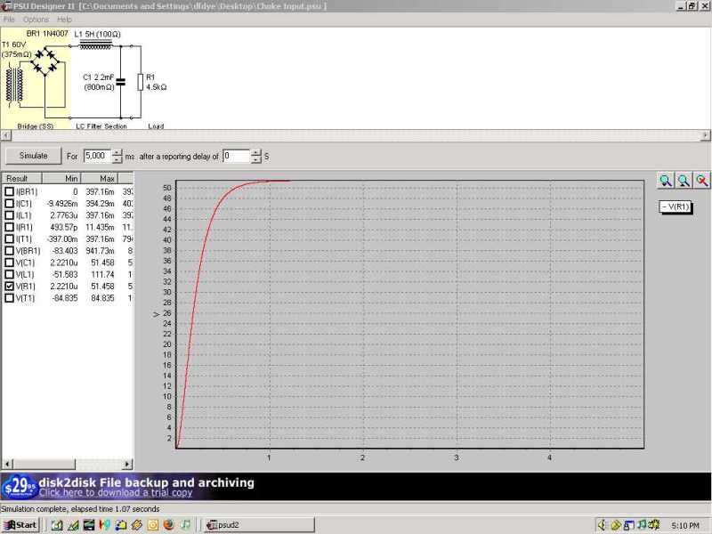

Alright, after having a few minutes to concentrate on what needs to go into this, I think I have a good design model for the choke input supply. The problem is that in order to have a high enough power handling choke, the resistance of the choke drops substantially (to about 0.3 ohms from those I have found available), making the PSU go crazy during startup. In order to make it well behaved, a resistance of 100 ohms for the choke works out quite well. Once the PSU becomes stable, the 0.3 ohm choke looks stable, but that takes several seconds according to the models I have been using. I was wondering if switching in/out a 100 ohm resistor during startup (until the power hits ~45V) using a relay would help, or would a monostable multivibrator timer setup that also cuts the outputs be a better option?
Attached is a simulation of this circuit using PSU designer II (which seems rather nice and simple for what it does). Of course it is for one rail, as I will need both a + and - rail, but I assume that both halves will behave the same way. Alternately, should I assume a 120V rail to rail and use the CT of the transformer as ground? I can always add in another cap and tie the center to ground. . . . This would eliminate one (rather expensive) choke, but I don't want to mess up the filtering if I need a choke for each rail.
Thoughts?
Thanks again!!!

You could try slow start.
I presume PSUD is showing oscillation of the output voltage?
Try a lower value load resistor, to achieve near your proposed quiescent current.
Now load up the PSU by inserting a range of load resistors and look at the 1second to 1.5second values.
