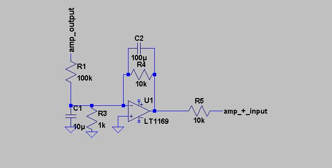

dc servo
ok, this dc servo is adapted from the APT-1 amp. the input goes to the amplifier output, and the output goes to the amplifier inverting input on the diff amp. you will need to remove the cap in the amplifier feedback circuit and jumper it (that's the 22uf/25v cap), and change vr1 to (2) 50 ohm resistors.
if you want an offset pot, you can make a voltage divider from the +12 to the -12 rails with (2) 1k resistors and a 200 ohm pot in the middle. the wiper goes to a 4k7 resistor, which then goes to the inverting input of the op amp.
this provides a completely independent DC feedback path which does not alter the balance of the amp's diff amp (i.e. you introduce no 2nd harmonic distortion in the diff amp).
i also have another DC servo that seems to work as well,and possibly better, and i will upload that one in my next post.

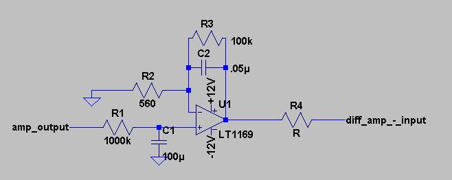

another servo
this is a servo i came up with for an amp design i'm working on. the rolloff frequency is about 5 Hz. the design discharges the caps when power is removed (the APT-1 used a fet switch which added a little more complexity).
this one is an inverting design, and adds the offset correction to the + input of the amp instead of the - input.
btw, my avatar image is an m1 tank...... spent some time in the army, and m1's are amazing vehicles...... i also like amps built like a tank.........
Hi Uncle,
why the feedback resistor added to the integrator cap?
How about adding a T filter on the output to reduce the noise being injected back into the LTP input?
The first shows 1M0 and 100uF. How long does this take to trigger?
What effect will reverse polarity have on the 10u & 100u caps? add reverse DC protection.
why the need to DC couple? I realise that the DC servo allows operation as a DC coupled amp, But why MUST the cap be removed?
the resistor actually sets the gain at DC, as well as discharging the cap after power is removed. reverse polarity shouldn't be much of a problem if you use A> a higher voltage cap (like a 50v or higher) since the actual voltage seen at the cap is quite low, and most electrolytics tolerate a small amount of reverse voltage. B> a bipolar cap or opposed pair... bipolars are expensive and oversized, so an opposed pair is probably the cheapest and takes up less "real estate".
rolloff frequency for both circuits is about 5hz.
removing the cap from the original feedback loop A> removes a reactance from the feedback loop which can cause phase shift in the feedback and instability in the amp. B> with the dc servo the purpose of the original cap in the feedback loop is redundant. you can actually do more with the servo, such as tailoring it's frequency response, adding an offset control (outside the signal path), that you can't do with the "cheater" cap.
any noise generated by the op amp is below 5hz, and about nonexistent with a good low noise op amp. noise is proportional to the square of the frequency, which is why noise is usually expressed as nano- or picovolts per square root hertz.

Hi unclejed,
I have some questions (sorry guys my New Years resolution did not include "no more quetions!" lol lol lol):
I have the APT PreAmp (agmonst a few others - CL-34, Aragon and yet To Do Aleph 1.7) and I do like the APT PreAmp. Sadly I never was able to buy the APT-1 amplifier.
Which version of the schematic for quasi's amplifier are you referring to? The most recent schematic does not appear to have a 22uF capacitor or am I blind?
Are you suggesting VR1 be replaced because you favour fixed (film) resistors instead for noise reasons? I know there were some during the open comment part of the refinement of the design wanted fixed resistor values instead of VR1 on basis of greater stability and much less noise on fixed resistors as opposed to using any sort of pot (aka VR1).
Quasi can correct me if I am in error, but the decision to leave VR1 was to ensure the least DC offset possible could be set. Can one still choose to use a pot for VR1 notwithstanding your below suggestion for an offset pot via the +- 12V opamp supply??
Pardon my lack of design knowledge, but is a DC servo that much better than the usual feedback circuit. No need for any involved explanation. If you wish to explain I suggested your keep it basic as I do not understand NFB design for am amplifier. I only have a basic understanding of how to tweek and a bit about validating the rolloff frequency, not the shelving element part of the BFB.).
Does a "traditional" NFB circuit produce 2nd order harmonic distoration?
Have you determined which of the servo designs you proposed you prefer?
Is that any preference from a design perspective if one uses a servo desigh that adds the offset correction to the + or - if the input LTP/diff pair?
Which capacitor are you referring to in both servo designs?
Ideally one would use a non-polar capacitor?
Ho does one calculate the rolloff frequency for each servo design you proposed?
In the "traditional" NFB design there is a RC time constant suggested be desinged for. The current quasi design NFB RC time constant for the RC leg to ground is at least 100ms minimum. Do either of the proposed servos meet this minimum requirement? What are the RC time constants for the two proposed servo circuits?
Which capacitor is being referred to?
My understanding from the above comment is the revelant capacitor needs to stay in the circuit as designed. Yes or no?
Sorry unceljed, I am now becoming very confused which capacitor is being refered to. Can you enlighten me?
Does this mean one could incorporate the same essence as the Leach NFB Feedforward de either of these servos?
What is the "cheater cap" in quasi's design?
Would a NE5332, TL071, ADxxx, OPA's or similar be acceptable for the opamp for your DC Servo's designs? I do not need to get into the pro's anc cons of which one is better. If you feel a need to exporess stongly in favour or against any AP amp for the DC Servo design I an willing and able to hear your thought regarding.
The DC servos you are proposing would change the current setup procedure quasi has documented for the current quasi design?
Are you aware of the LM317K related circuit in the Anthony Holton N-Channel amp design? Would you say the LM317K designed used in the Anthony Holton design is also a DC servo?
