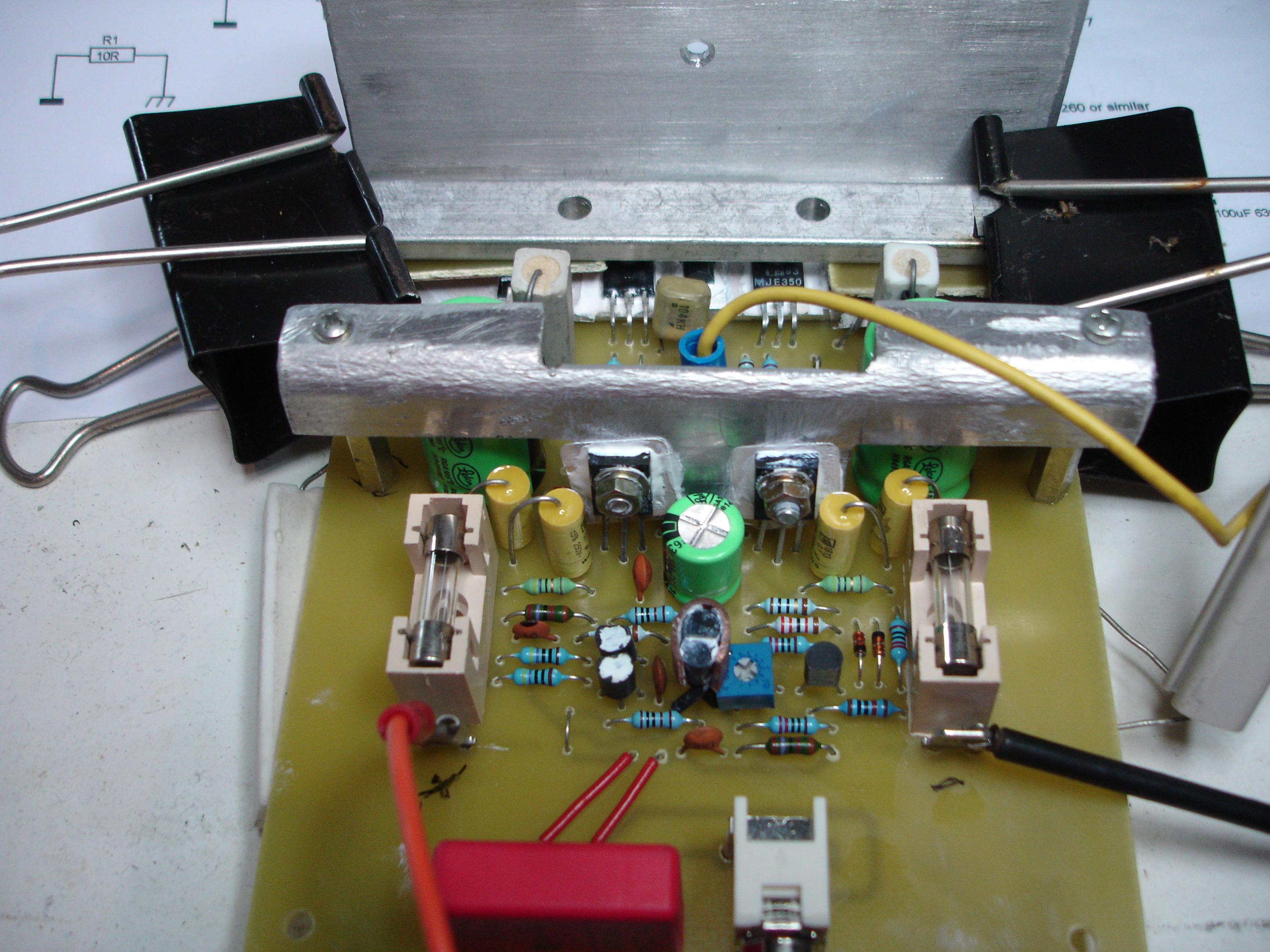

John, here's a pic of my 2SC1845's. Do yours look like this?
Cheers
