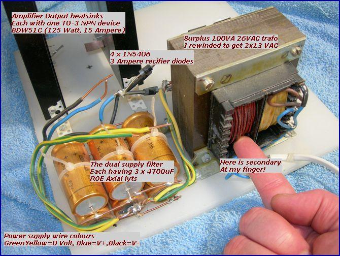

I have posted about E-type (square) vs. Toroid transfomers
a number of times through my years here at www.diyaudio.com
But if you do not read my posts, why should I bother to repeat my self. Again & again.
To every new comer here in forum, like ostripper
I have nothing against using, re-using E-type trafos.
As a matter of fact, I bough some big 100 VA from surplus sale some 10 years ago.
And they work really well.
I also happen to know there are a great number of members here, doing the same as me.
I have even re-winded secondary of one of those.
To get the custom Voltage I need.
For use with one N-Channel Class A amplifier.
Here is my image of this diy E-type transformer work of mine.

No, I really did not think you should go read my 3000 posts, to find a couple about E-type Transformer.
But is quite easy to find those posts, wehere I inform about SQUARE Old trafos:
- 1. http://www.diyaudio.com/forums/search.php
- 2. Author = lineup
- 3. Find all posts including this word: e-type
Rewind transformers secondary:
- hard work!
- difficult to take apart, rewind & put together again
- without some trafo winding machine is it really h ll

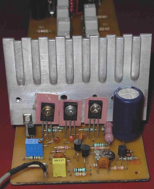

ravslanka said:hi quasi
i powered my
everything checked all was ok
first i checked with 40-0-40 3 amp transformer auxilarry rail tied to
positive rail
but i cold not set my biasing the voltage does not go over 4.5 volts across positive rail resistor (100 ohm )
then i switched actrk600 with 70-0-70 auxilary 85 volt dc again the same thing
once i blew my 100 ohm resistor
.checked everything all ok
i am using 33pf instead of 39pf does that make any difference.
mosfet source resistors are 0.5 ohm
http://i35.tinypic.com/30icdqp.jpg
http://i35.tinypic.com/k0lfmo.jpg
http://i34.tinypic.com/szk3us.jpg
You say 33pF instead of 39pF.
If you mean those small feedback / compensation caps.
This is not the way .....
More SAFE to use 47 pF or even 68, 100 pF.
Higher value = stabilty, a bit slower amplifie
Lower value = in-stability, a bit faster amplifier
Be careful NOT go down in value from what Quasi recommendation
.. because this comes CLOSER to In-Stability
and maybe Some S-M-O-K-E
