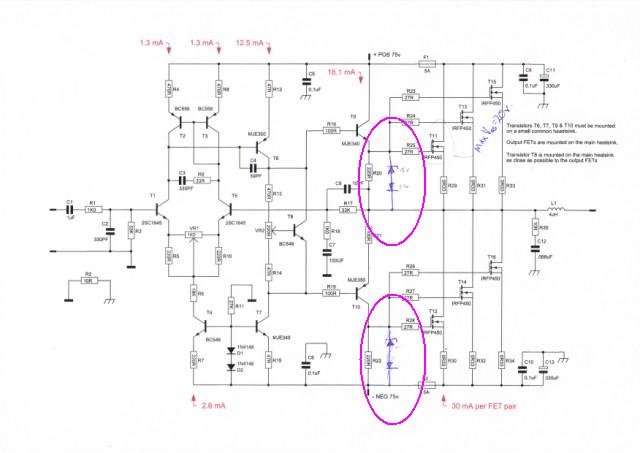

ok... I've attached an edited schematic showing what I think should be done with the protection diodes.... is this right?... seems to make sense to me...
Maximum Vgs on the IRFP450's is 20volts... so I have got a 15v zener, and the diode (both of which can handle 10A for the few ms before the fuse blows) ready to install. Before I go and install it, just want someone to say its the right (or wrong) way of doing it.
Cheers....
Cheers....
maybe... but the reason I put the diodes before the gate resistors was so that fault current wasn't flowing through the 27ohm resistors... they would burn quick...
I'm mainly concerned about the setup I have on the FETs connected to -Vcc. Is that setup correct? Vgs is measured from negative source voltage. And would 15V zeners provide enough protection? (that would mean at fault Vgs would make it to about 15.8 volts)
