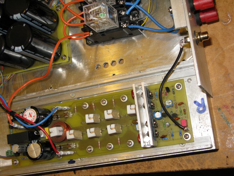

Note holes drilled in the bottom panel to help cool the small heatsink (fan ventilated case). As you all know this little heatsink gets very warm (hot?).
Amp is in service fed by the pre-amp section of a cambridge integrated amplifier. Sounds Amazing!
Cheers

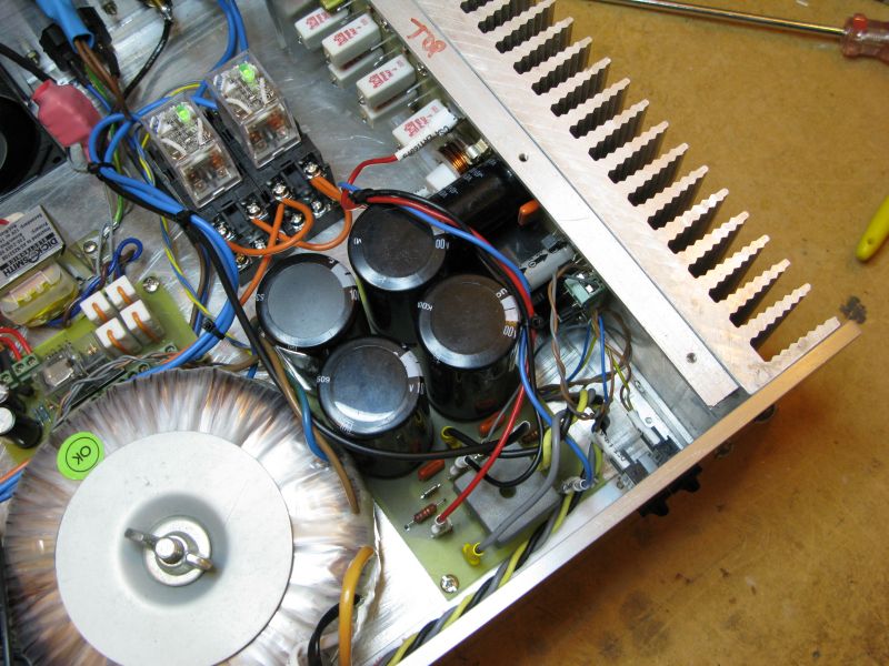

Hi Taj
About 6 years ago a company I worked for wrote off of a high capacity UPS. It was as big as a large fridge and almost completely surrounded by heatsinks each measuring 300mm long by 450mm high.
I made an offer to remove it from site at no cost to them, and they acccepted. Apart from the heatsinks I also got a huge wiring loom, about 60 IRFP450's, and stacks of other components.
I cut the heatsinks to the height I need on my friends mill and with a some thick sheet aluminium I have a case.
The down side is that my cases can only be about 300mm deep (internally) and there is the odd drill hole that I have to watch out for, but the upside is that I have stacks of the stuff ready to be cut.
Cheers
Q

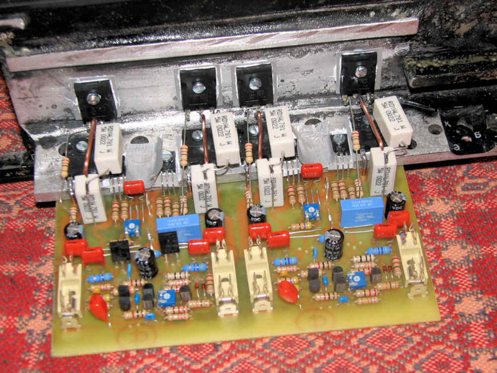

crackpot idea.Edey said:Hi
I have built bridge amplifier based on Quasi's Nmos200. Totally used 8xIRFP260N.
It works at +-50V rail voltage, so 100V into 4 ohm load.
Current was about 6-7A at music signal.
Works very good!!! I'm very happy with it.
+-50V with 2pair into a 2ohm reactive load.
An accident waiting to happen.
Why so?
It already worked for one day at almost 3/4 power (I completed it yesterday).
Subwoofer, that i used (Ground Zero GZTW 38T was overloaded by this amplifier. I don't think that it would be an accident.
Here is photo in assebly stage with no T6, T7 transistors installed
Note: I used NE5532 op-am (precisely 3 op-amps):
First as non-inverting op amp to amplify signal
Second as low-pass active filter
Third as phase invertor
