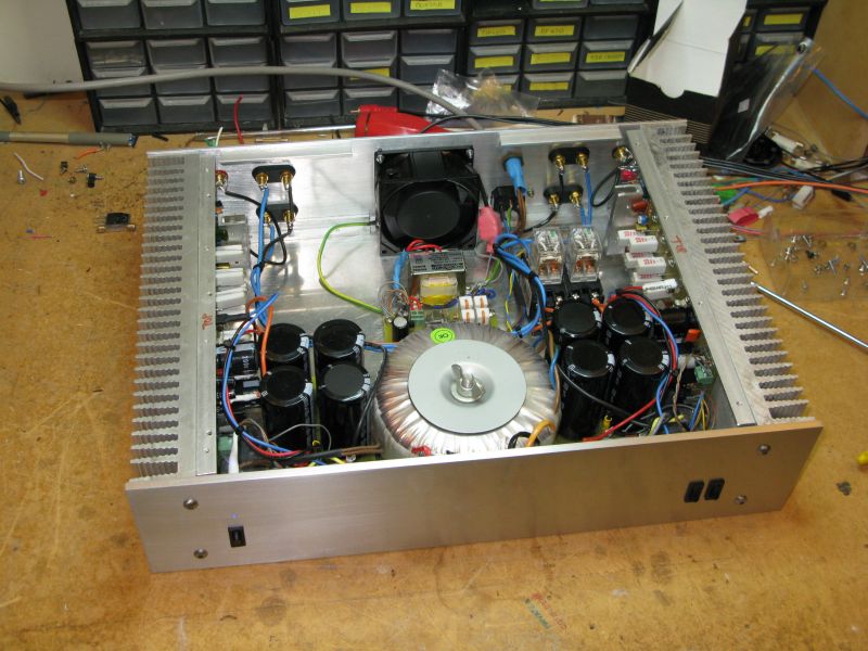

Power amp under development
Hi Maci.Laci
This is truly a marvelous looking stereo amplier, congratulations.

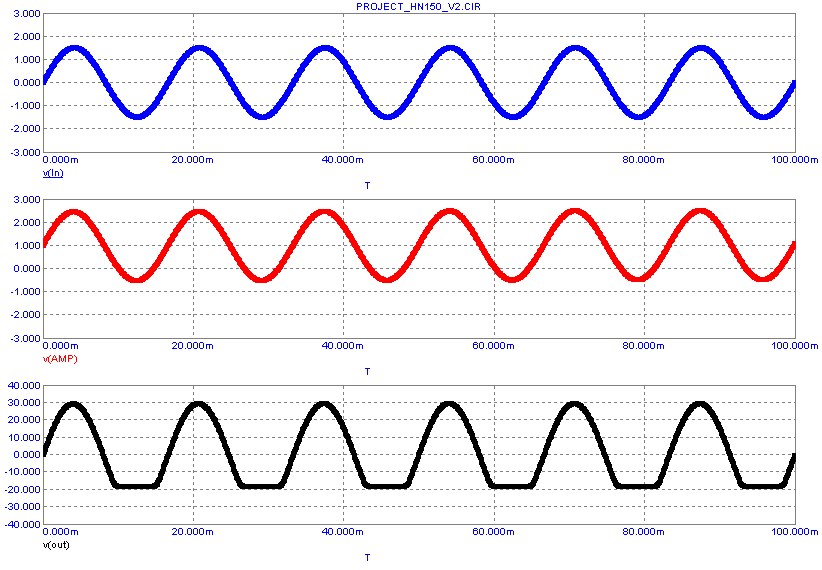

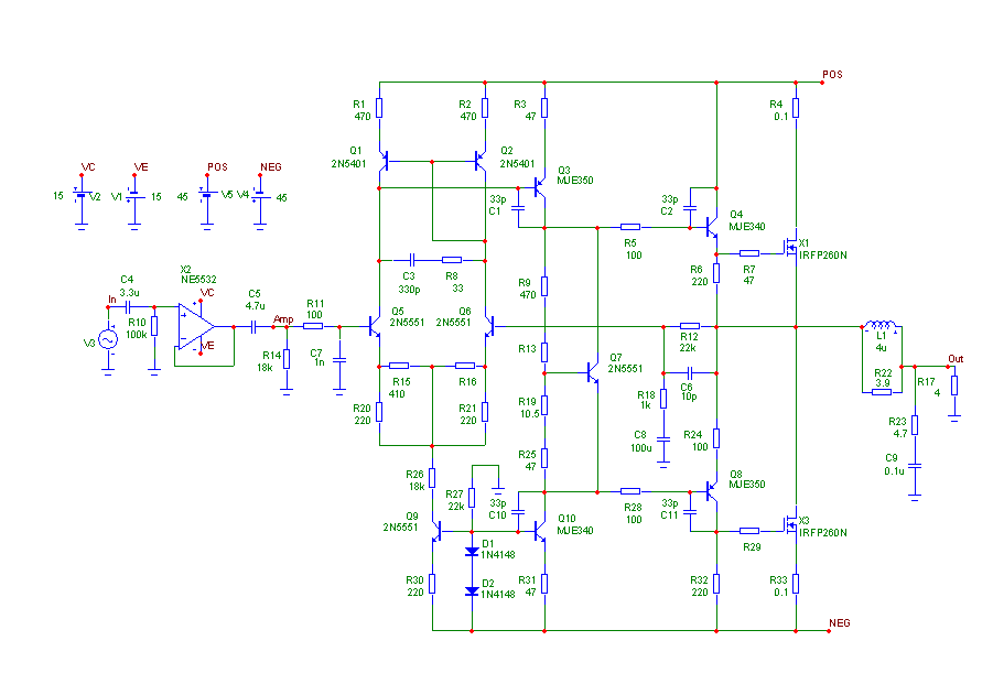

Hi, I'm up to build a couple of those amps for bridge operation. But I've encountered some issue. Amp didn't work properly with buffer, there is strong offset of input signal after buffer or inverter stage. It's on the picture. What's the case? I can't figure it out. How to fix it? Really want to bridge them :)
Hmm...I don;t know what the problem is. Is there a DC offset being created on the base of the power amps input transistor?
Can anyone else help?

Originally posted by quasi Hmm...I don;t know what the problem is. Is there a DC offset being created on the base of the power amps input transistor?
Yeah, there is apparently DC in the base of input transistor. Without buffer or inverter there is no DC. Buffer works great with other (Holton's) amplifier.
Please someone help, I've stuck on this.
