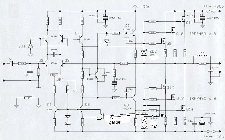

Hi All,
this is the schematic improved with zener protection
the diode added are 1n4007 .
Regards
